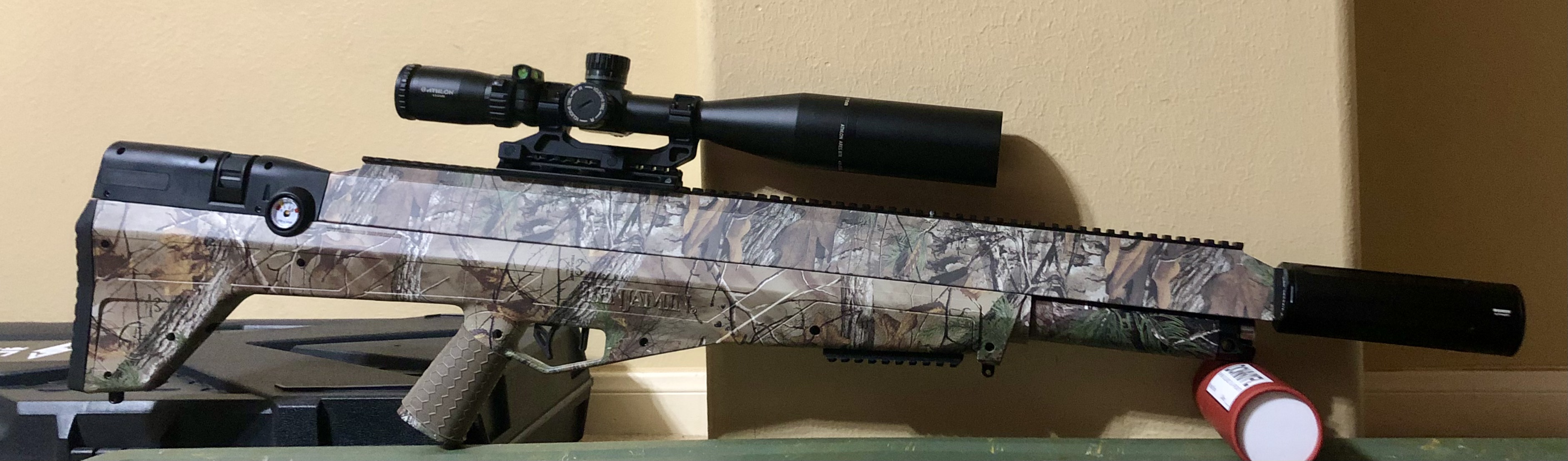

Recently picked up my .357 Bulldog from Matt, Pauly and Aaron. Great bunch of guys working together to elevate the Bulldogs to another level. They lived up to the hype.

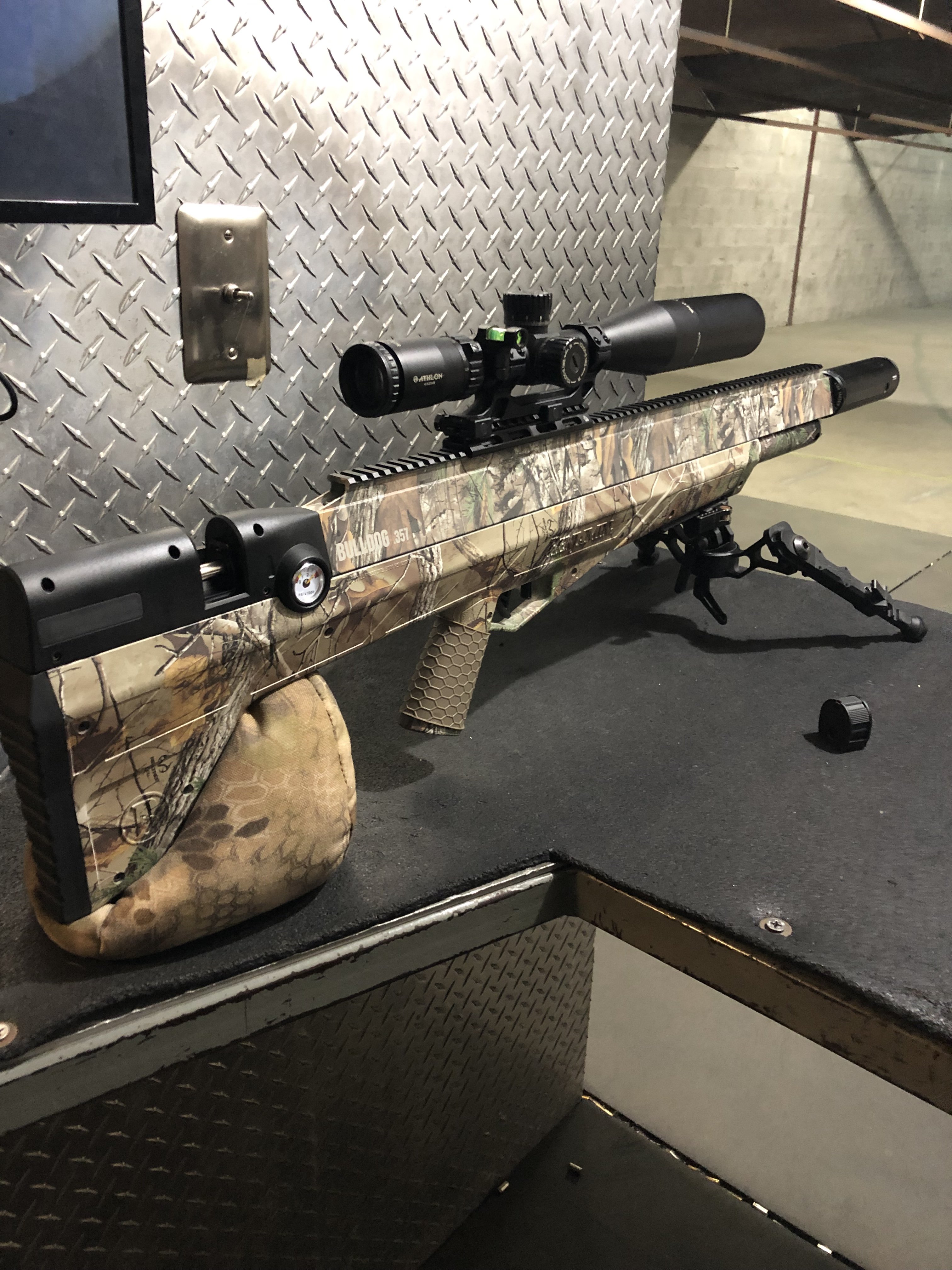

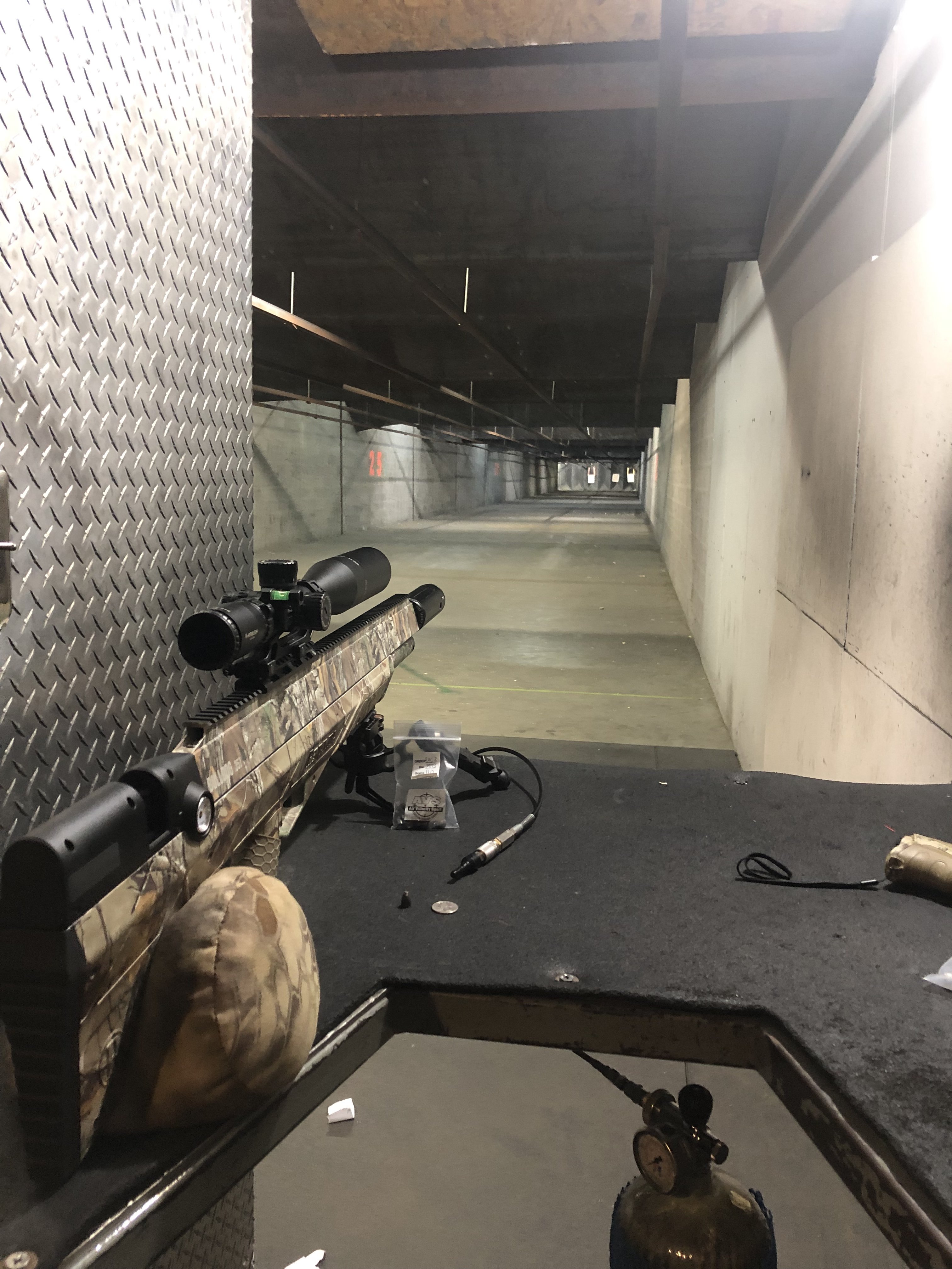

Got to test the Pitbull yesterday at my local indoor range. I’m liking it. I had the guys do a regulated version as I love regulated consistency
I believe they call it the AKC build. Huma installed with a huge plenum, new charging handle, porting polishing, tube extension and threaded M18 at the muzzle. I’m running a DonnyFL Ronin. Here a list so as not to miss something:

The Pitbull which I’ve named Camy, is performing great. I get 6 regulated shot from a 300 bar fill. The Ronin tames the bark to a point that I don’t need hearing protection
You may have seen a review of a stock Bulldog. This one ain’t stock anymore
I'll be putting her to work this whitetail season and will be sharing the experience.
