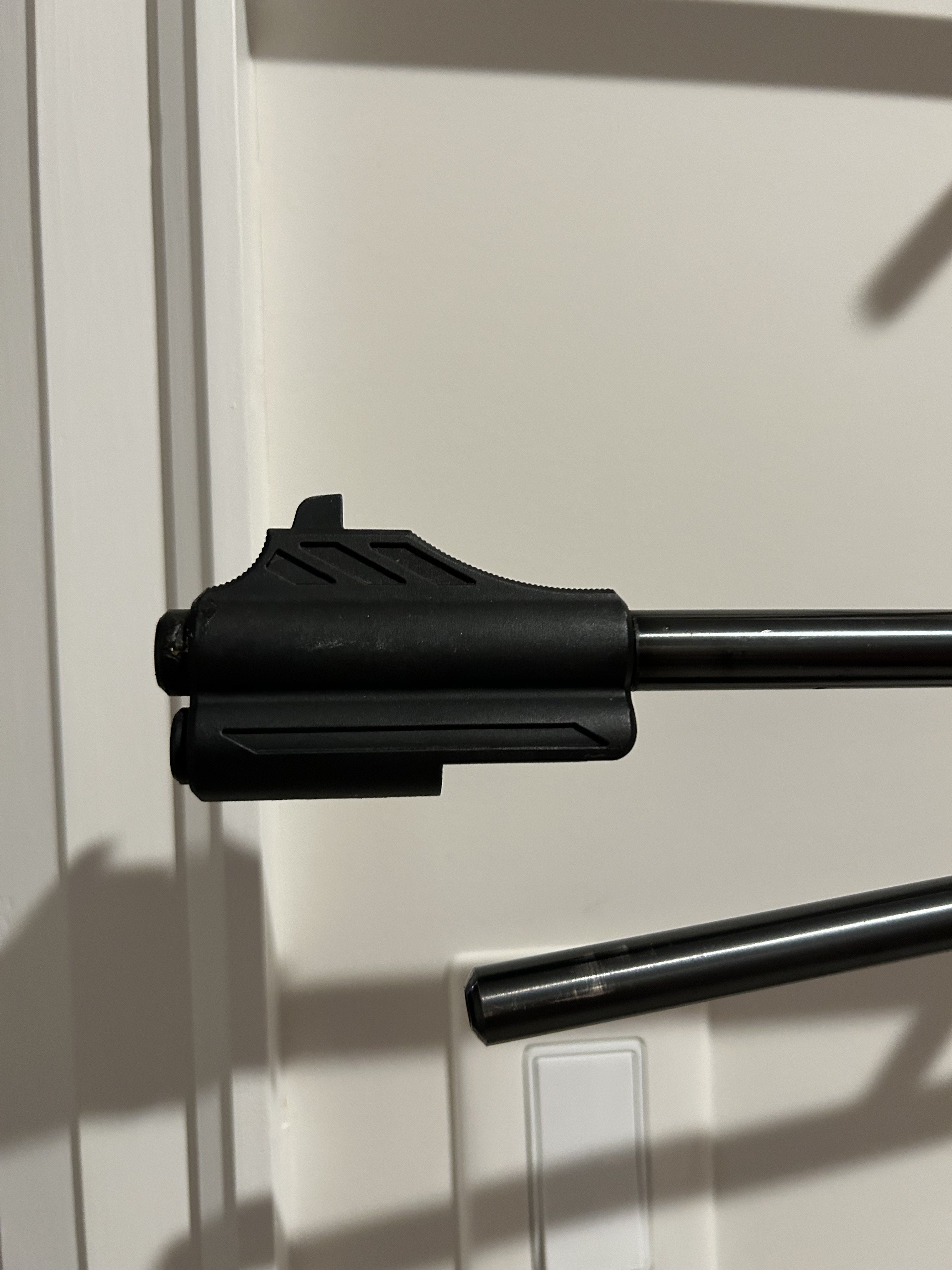

I have had two Diana 350 magnum rifles, one was the Panther 350 which has the synthetic stock and the one I still have is the 350 Classic. The Premium is simply a model with a premium stock with the cheekpiece for right handed shooters and as I am left handed never bought one.
Both 350 models I own started as you ask started falling apart much sooner than 500 shots, and one situation was very dangerous and I could have gotten seriously hurt. Lets address this first. The main stock to action screw will vibrate loose in less than 25 shots due to the recoil. It also only has on average two thread turns on that screw into the action screw boss, so very little recoil and back out is required for the thread to boss to become weak and tear clear out of the boss rapidly and violently sending the rear of the action flying at your face at high speed. While cocking the rifle the screw and boss will separate and the action will fly upwards right at your face.
My solution for both of them was to make a trip to Fastenal and obtain longer and better fasteners, install with a liberal coating of screw lock and this solved this dangerous situation. So make sure to check the main action to stock screw carefully and if required and if they have not changed this replace with an adequate fastener. Umerex which is the current distributor for Diana was no help at all and it was like speaking to a deer standing in a bright headlight and the light bulb inside was not on. Grin!!
Next, on both models the rear factory sight has adjustment held in place with two small ball bearings. In about 100 shots the sight will back out and get so loose due to recoil it will fall apart and if in the woods never be found again, if bench shooting it will land on the bench. Both guns did this.
Next, the rear automatic safety unlike the HW pot metal trigger, is in fact some type of pot metal. Around 300 shots fully expect this to break and the back half of it to fly off the rifle. Both rifles had this happen. To be fair the 350 classic since then has had well over 10K through it with no further problems with a factory replacement. However Umerex with the lack of a light bulb was no help and I got a replacement from a well known supplier in the UK.
Next, the Panther developed a torn piston seal and most likely was like this since day one and torn during assembly. In any event the excessive slam recoil allowed another POT METAL cocking lever part to crack and when I took the rifle apart for repair the cocking lever had shaved long thin coils of metal from the action tube and was serious enough to me to require replacement of the tube. Some five or six years ago I bought another Panther that was on sale and started having problems with that one, I simply posted it up and gave it away free. I did not wish to rebuild another one, a well known person has this and loves it, however he also reported a chipped piston seal and other problems he had to fix. Once fixed it is now a favorite.

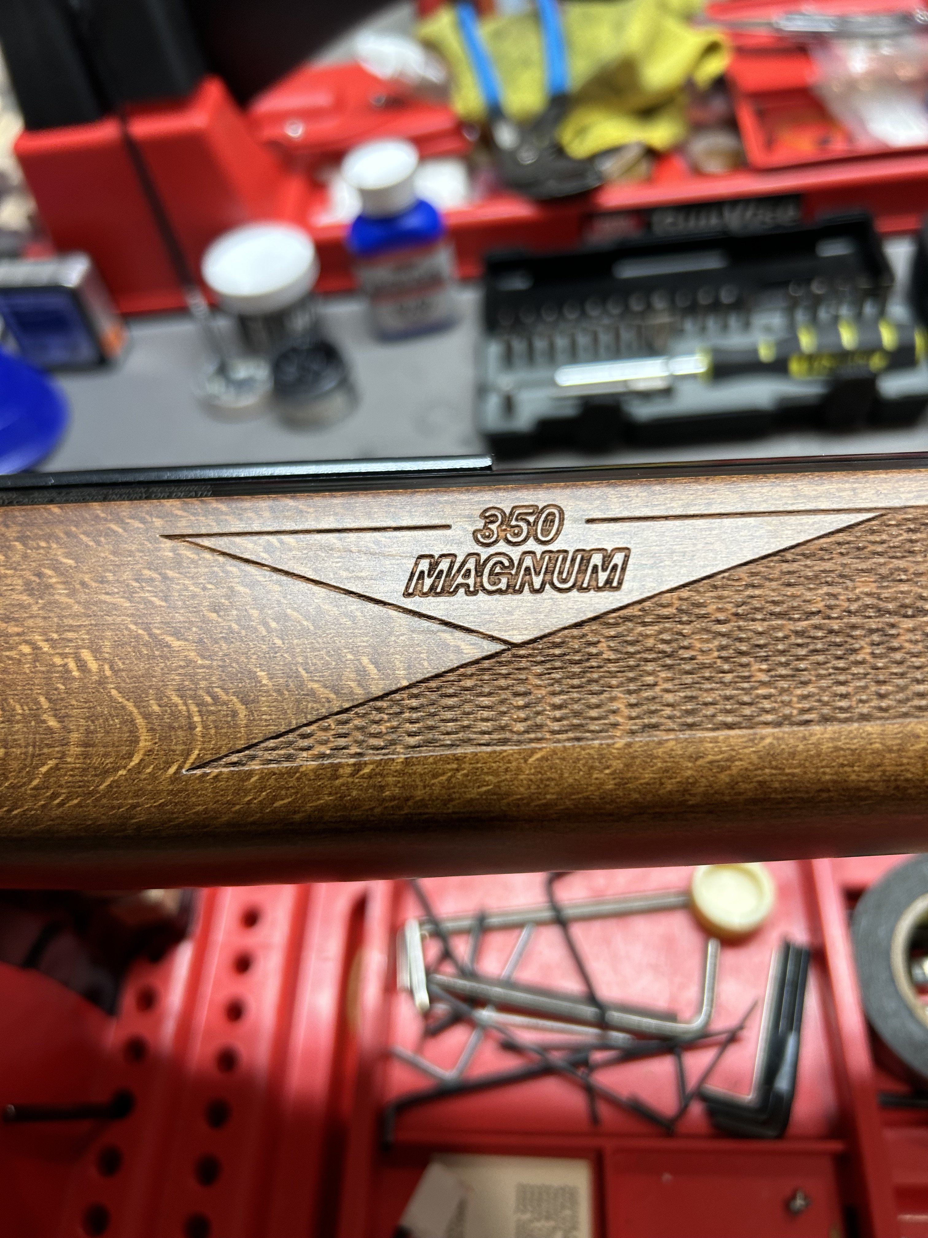

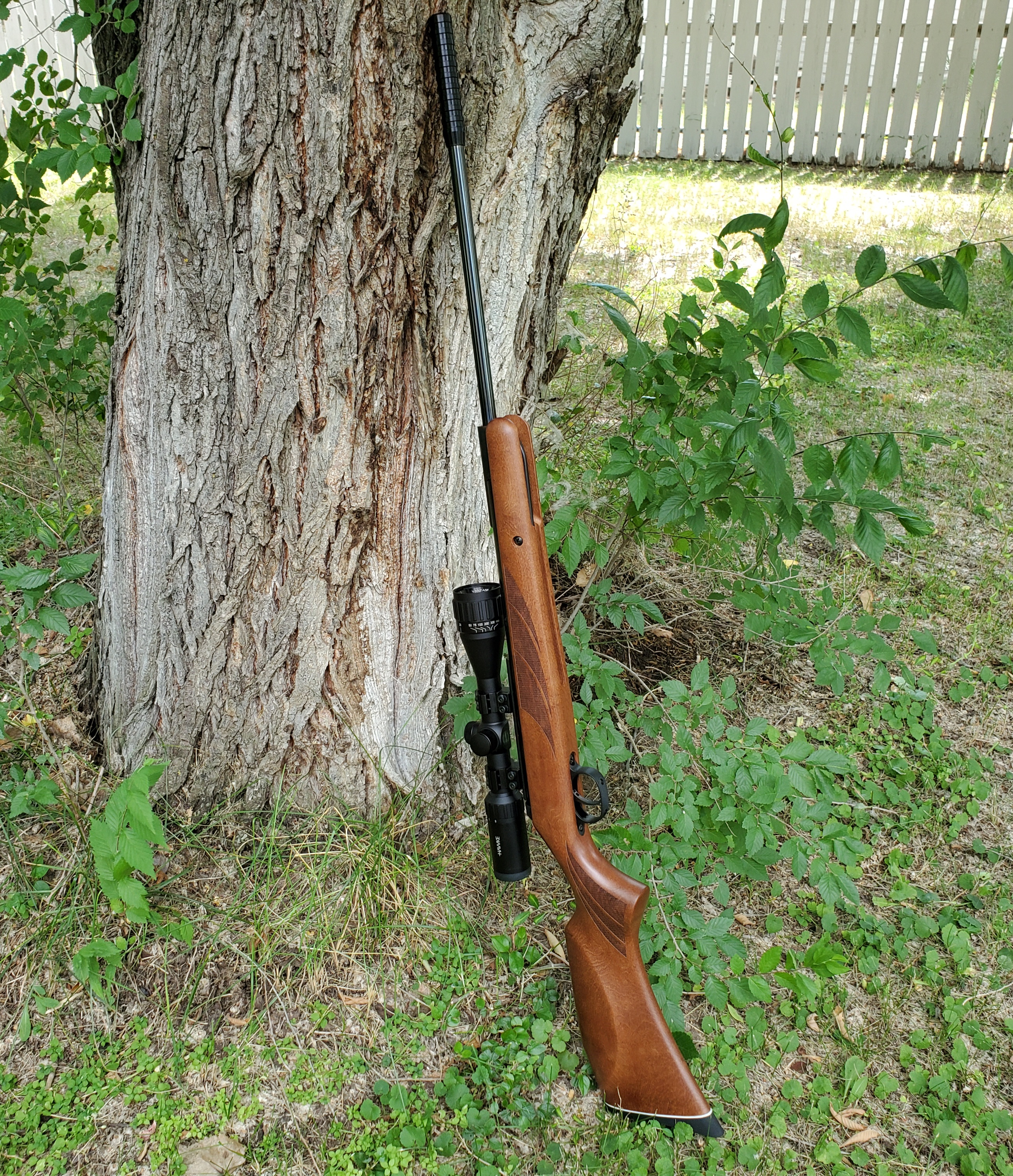

Things worked out nicly today after I got the 350 .22 and a Hawke 3x9x40 to ride it.
I wanted to put a ZR mount on which I bought for this rifle. But the scope rings extend to the flaring of the scope.
That the same scope 3x9x40. The ZR doesn’t fit.
Any suggestions?
Cleaned and scope on for a round tonite.
This gun is a long sucker. It’s got weight. Crow.

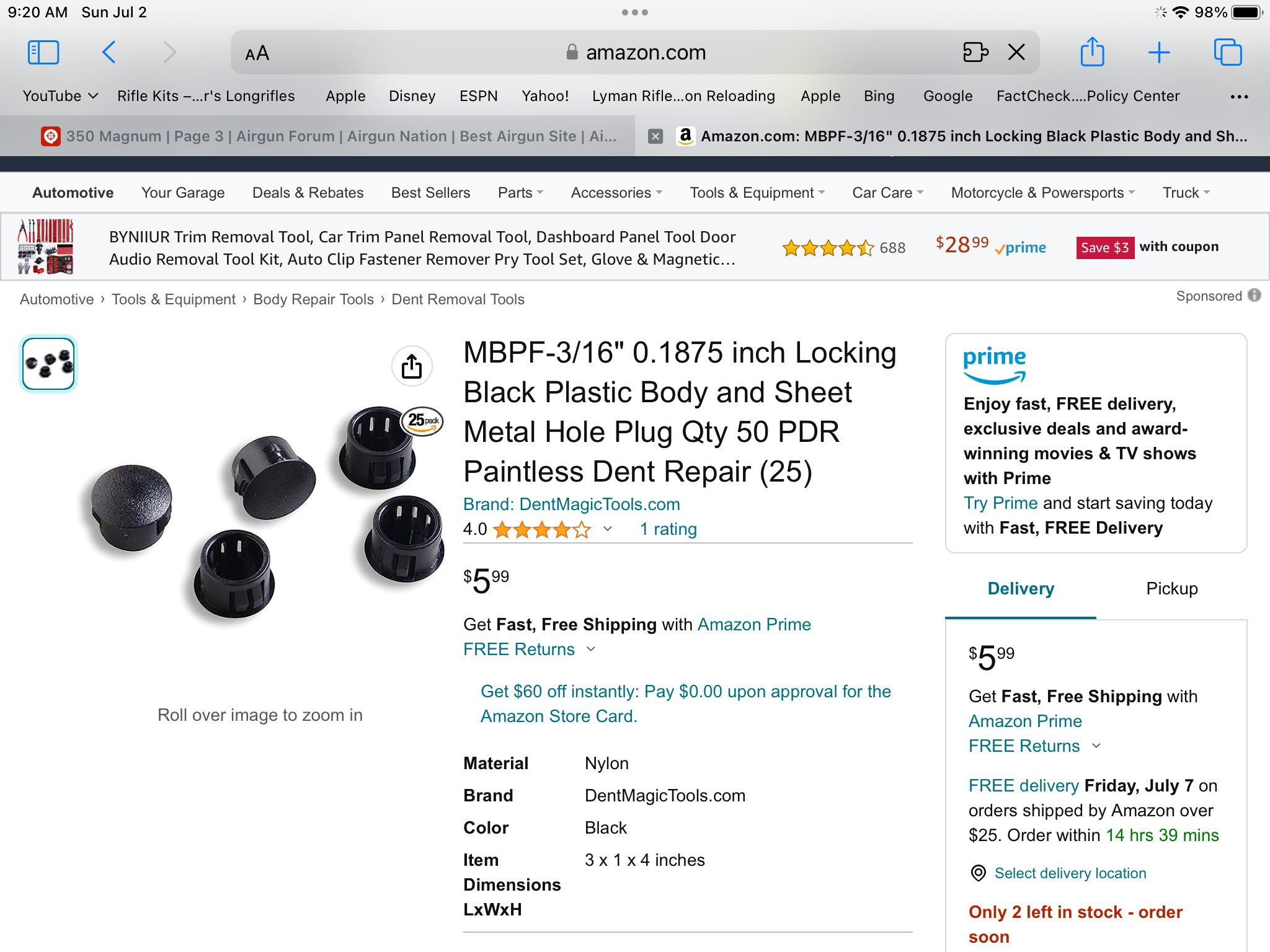

Crow, Do you happen to have a part number for these plugs?
Small world, wouldn’t want to paint it.
They have been on my mind.
someone posted it a year or two ago and I bought three packs thinking it would do me for the rest of my life. I’m almost out. I don’t know the name of the company that had them, but this is the serial number
I wished I bought 5 PACs. I like them better than the hole. Do you know what company or where to get them? Please let me know. Crow
someone posted it a year or two ago and I bought three packs thinking it would do me for the rest of my life. I’m almost out. I don’t know the name of the company that had them, but this is the serial numberView attachment 369115I wished I bought 5 PACs. I like them better than the hole. Do you know what company or where to get them? Please let me know. Crow
Just found these based on your package info.
Things worked out nicly today after I got the 350 .22 and a Hawke 3x9x40 to ride it. View attachment 368718I wanted to put a ZR mount on which I bought for this rifle. But the scope rings extend to the flaring of the scope.View attachment 368720That the same scope 3x9x40. The ZR doesn’t fit.
Any suggestions?
Cleaned and scope on for a round tonite.View attachment 368719View attachment 368740This gun is a long sucker. It’s got weight. Crow.
Very nice looking rifle. One thing for sure is that the Diana 350 is long, lean and traditional and has eye appeal.
Congratulations. Looks like your room looks a lot like mine, and I think both of us need a couple more rifles. Grin!!

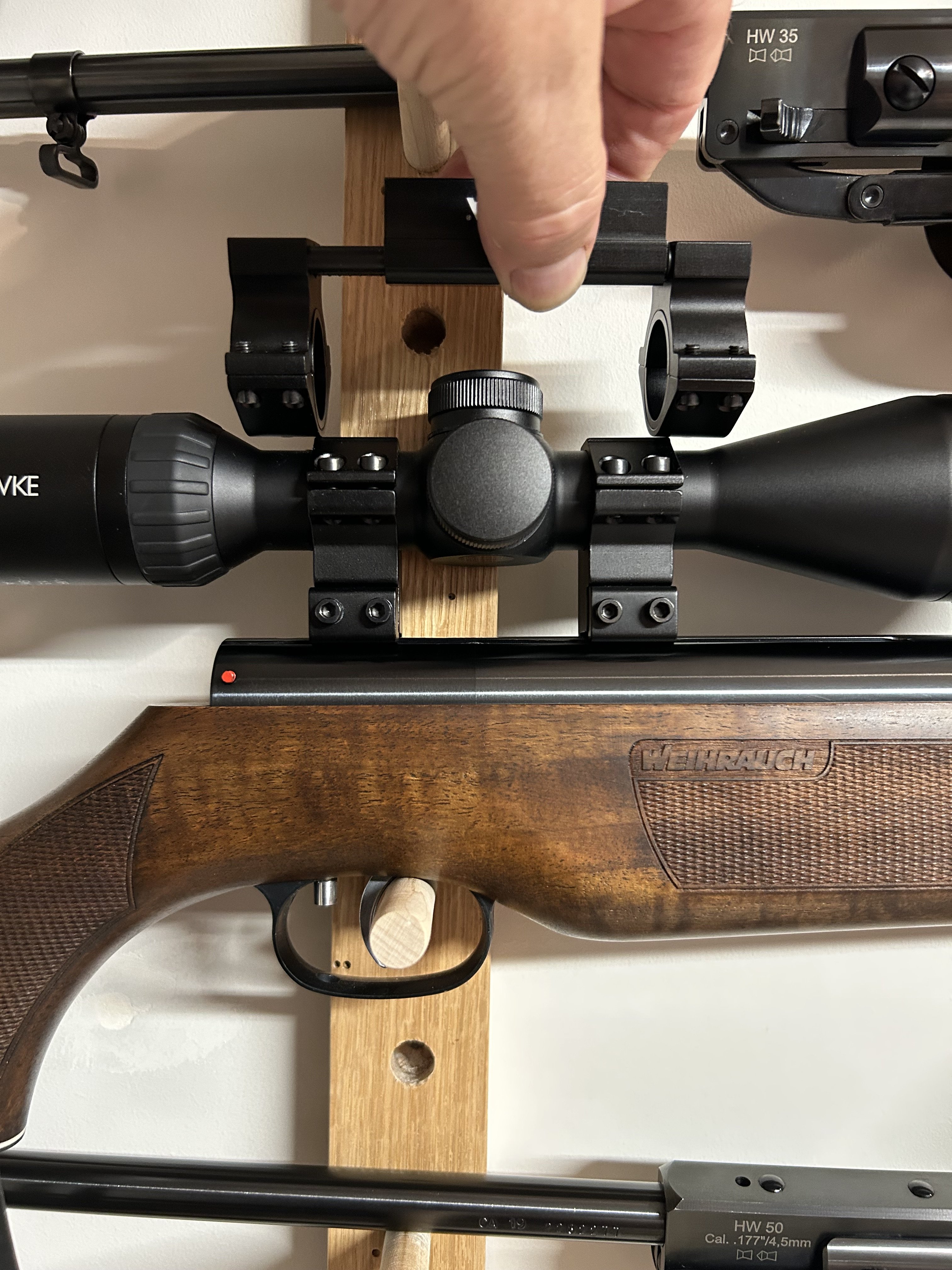

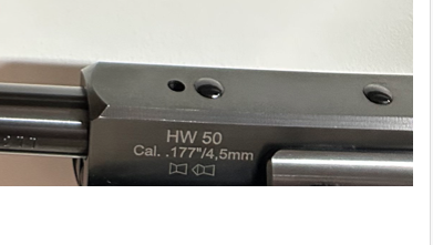

Is what your saying to put in the screw holes when you remove the. Sights. I wonder will the work on the Wh guns ?. Please advise. And thanks View attachment 369375 sorry didn’t mean to jack up the thread
Don’t worry about jacking.
Up to now I automatically put a scope on all my rifles. I don’t like the looks of both sights on so I take off the iron sights on Weihrauch break barrels. Don’t like the extra holes so these plugs are the best option so far to cover up. Crow
