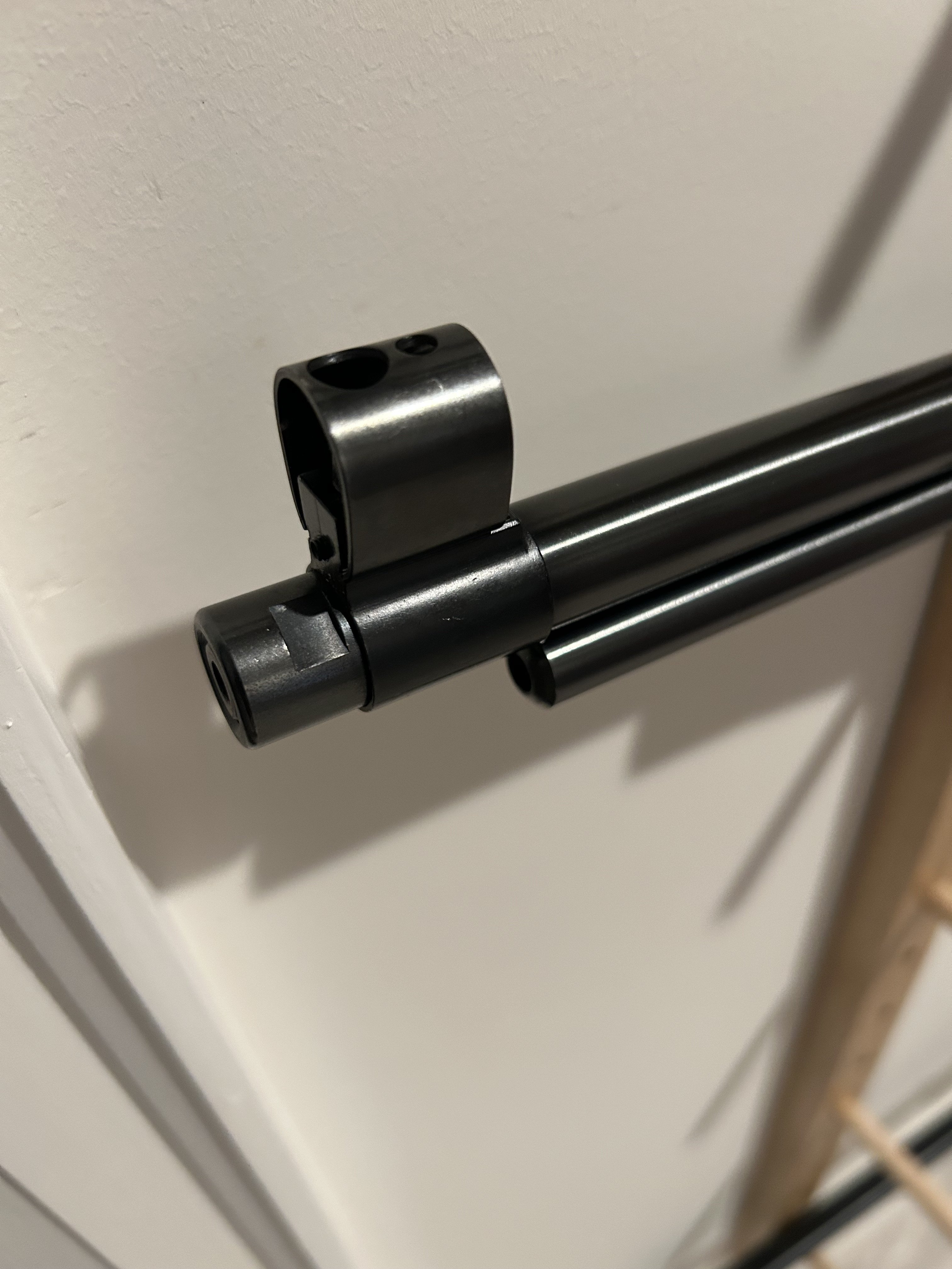

How about this kind of great product I have on both of my 460’s,
$750. gun. Pathetic. I’ve never said that about any rifle.
‘And In my eyes this is inexcusable.
Same thing on my 54, 34, k98 and 24. How do you compare these parts to Weihrauch and Air Arms?
How about on the 54 barrel and barrel block union. Almost shed a tear when the initial shock was over, when I first opened the box.
I support Diana, more than I talk. IMO if they had these parts above, cast or machined, they would put themselves up a notch or two. Crow

How about this kind of great product I have on both of my 460’s, View attachment 368194$750. gun. Pathetic. I’ve never said that about any rifle.
‘And In my eyes this is inexcusable. View attachment 368196Same thing on my 54, 34, k98 and 24. How do you compare these parts to Weihrauch and Air Arms?

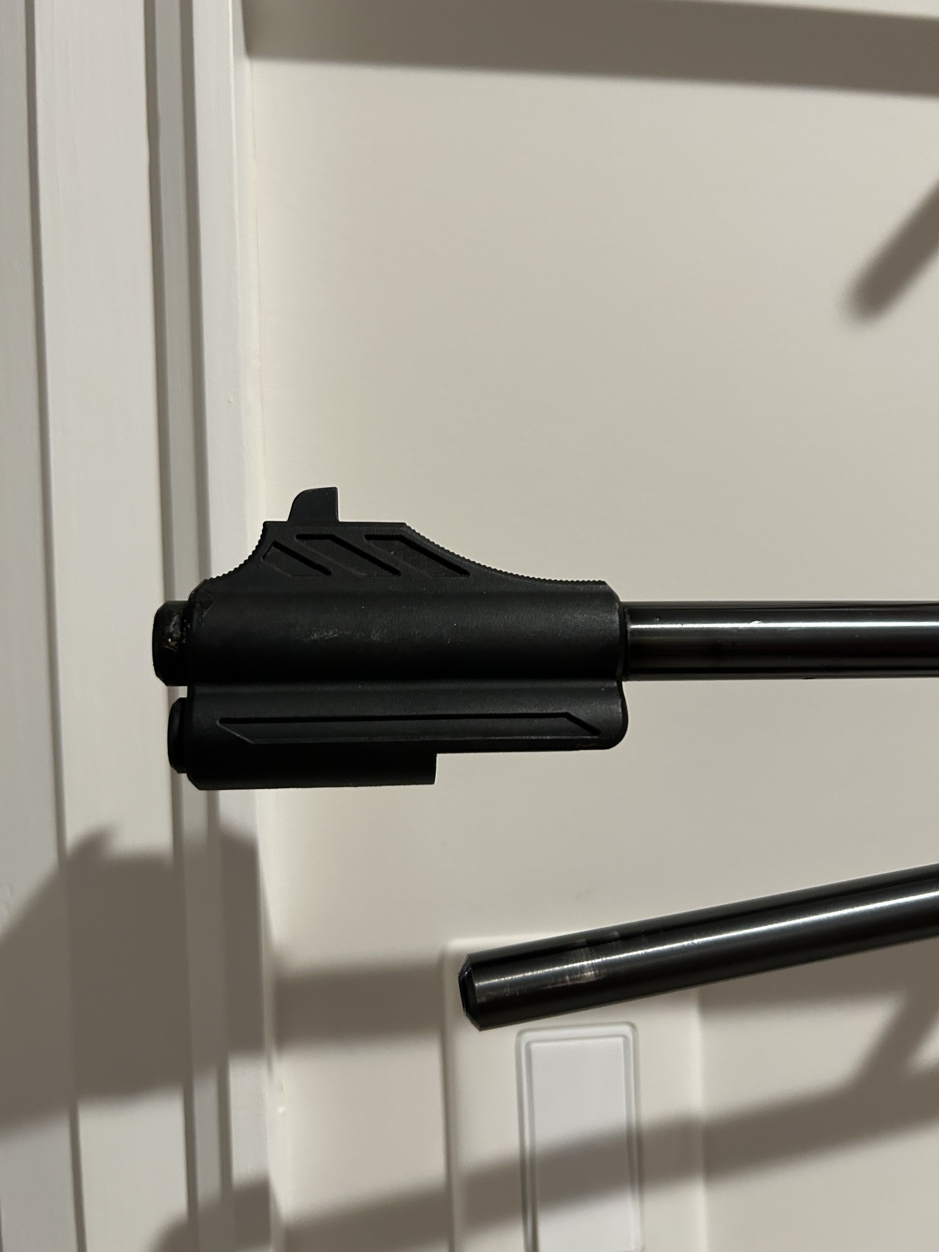

Yeah the front site sleeves on them are disappointing (hence why i went and took mine off for an aluminum muzzle brake), but they're still nylon poly.
Tough stuff, but understandable (especially for the locking mechanism for an underlever) how metal would be preferable.
The rear end cap is literally just a cap btw to clean up appearance, the trigger unit housing serves as the actual physical plug/spring retainer. Which I think is made out of aluminum iirc.

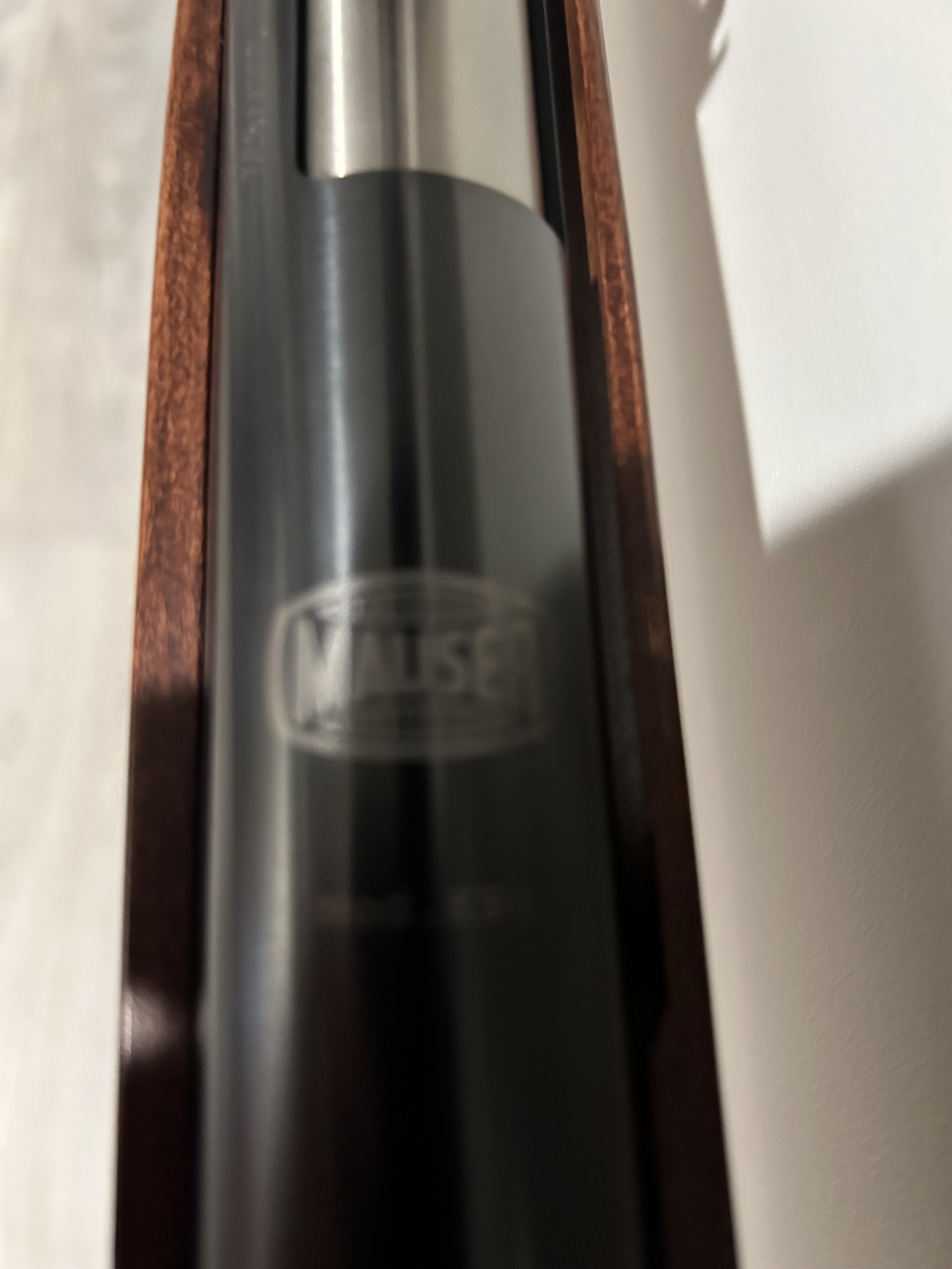

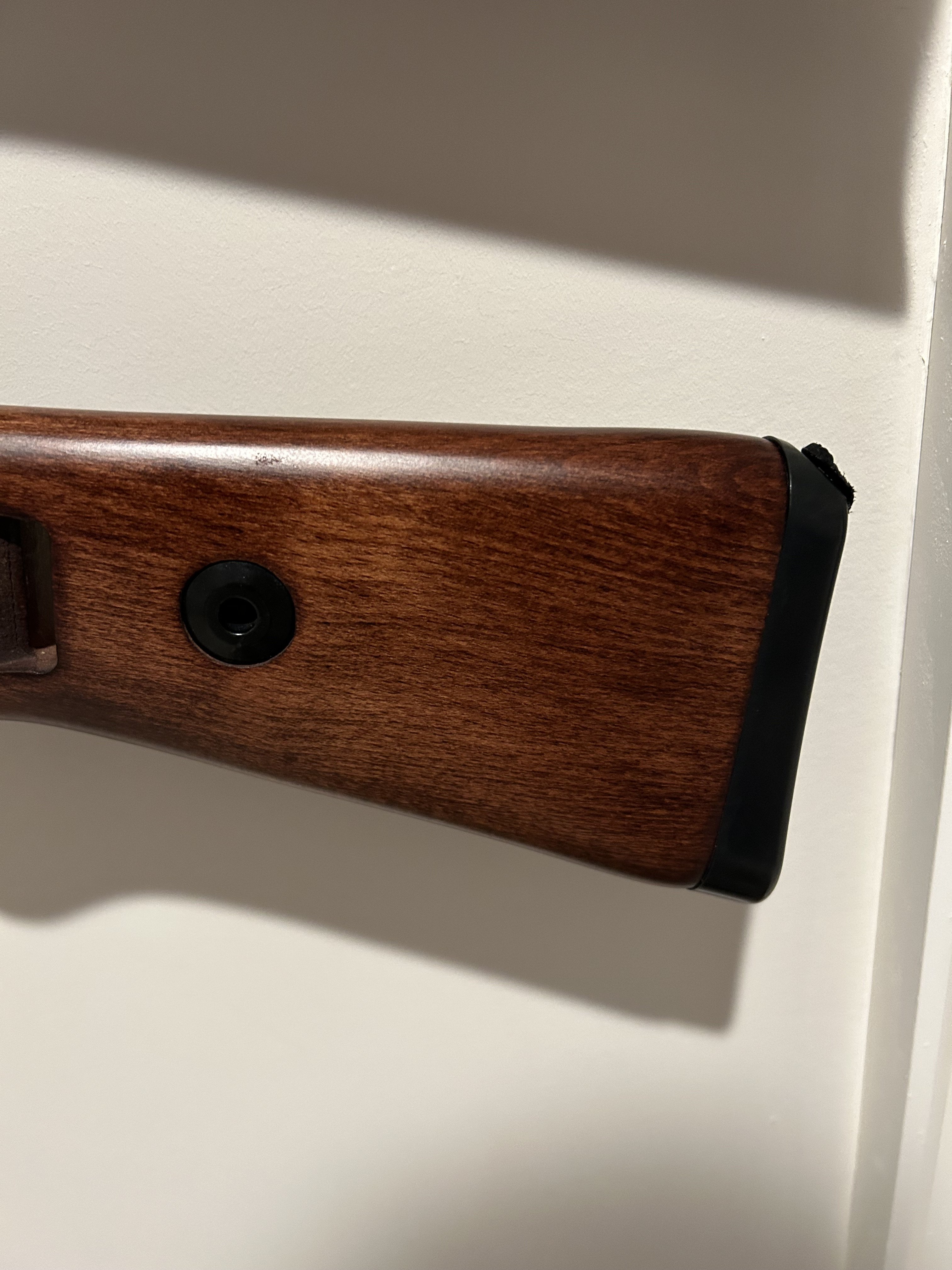

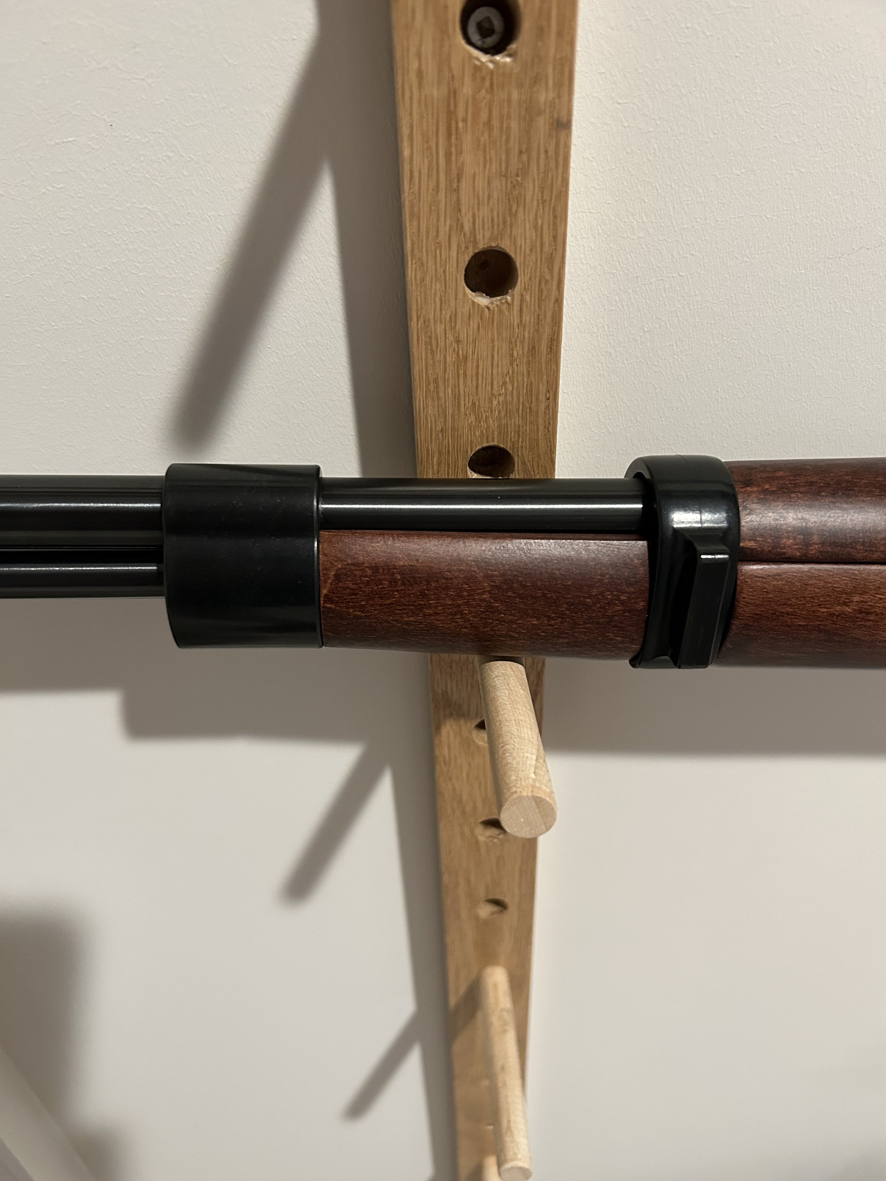

This really gets me. I bought the K98 because I liked the fact Mauser was printed on it. Cool.
Look at the casting on this.
This is a 460, modified. I didn’t know until after I picked up the used 460. How can they spend on these casting on 1 model and this gun is on sale, a dog. I like mine better the the 460’s, that’s wrong. The butt is cast as well the ring in stock. Check out the front sight on 98. And lever arm is tight.

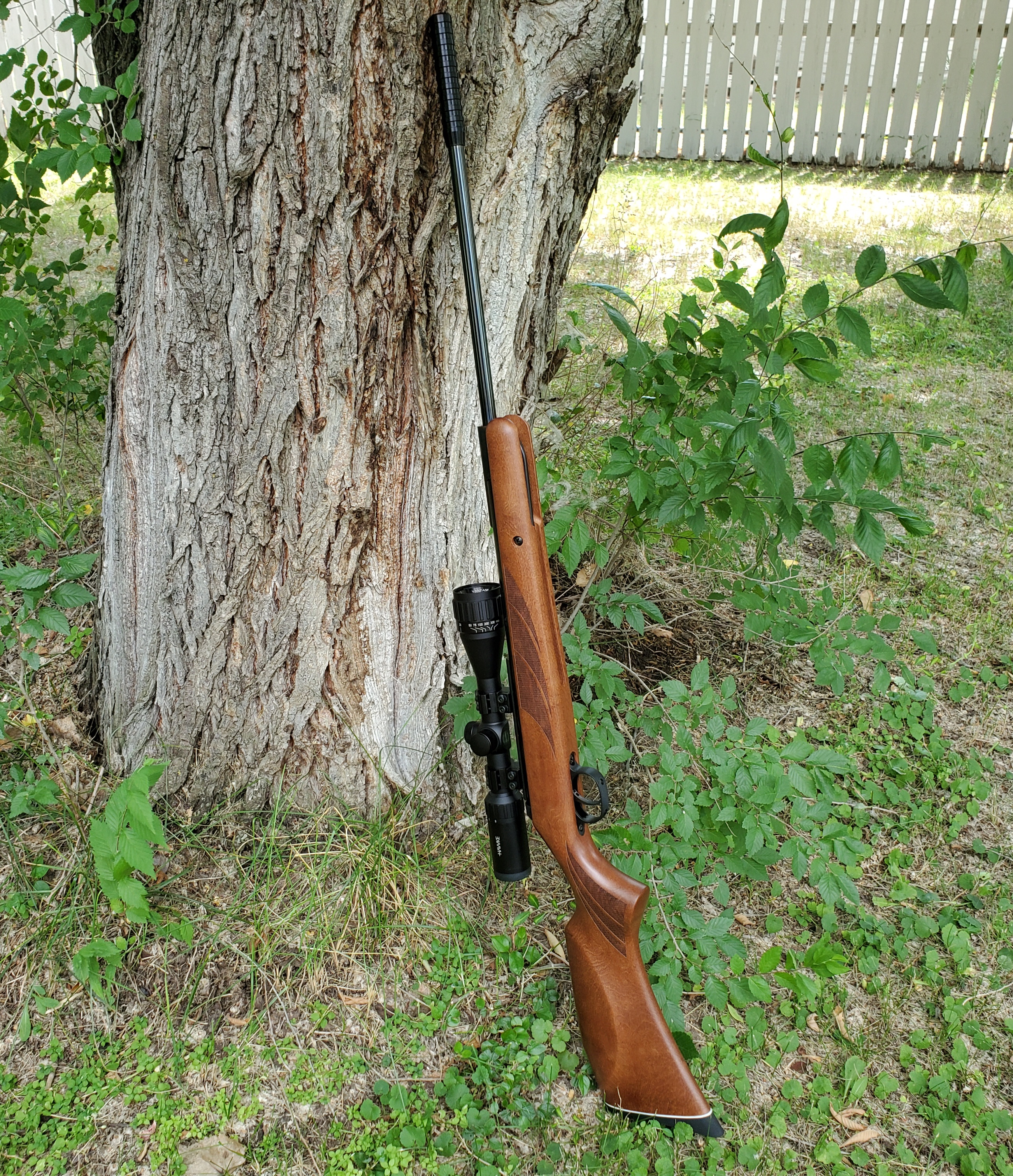

That’s a beauty. Like the muzzle end.
I got a used 34 premium. Shot it this morning. Deadly accurate with it, nice trigger, don’t know which.

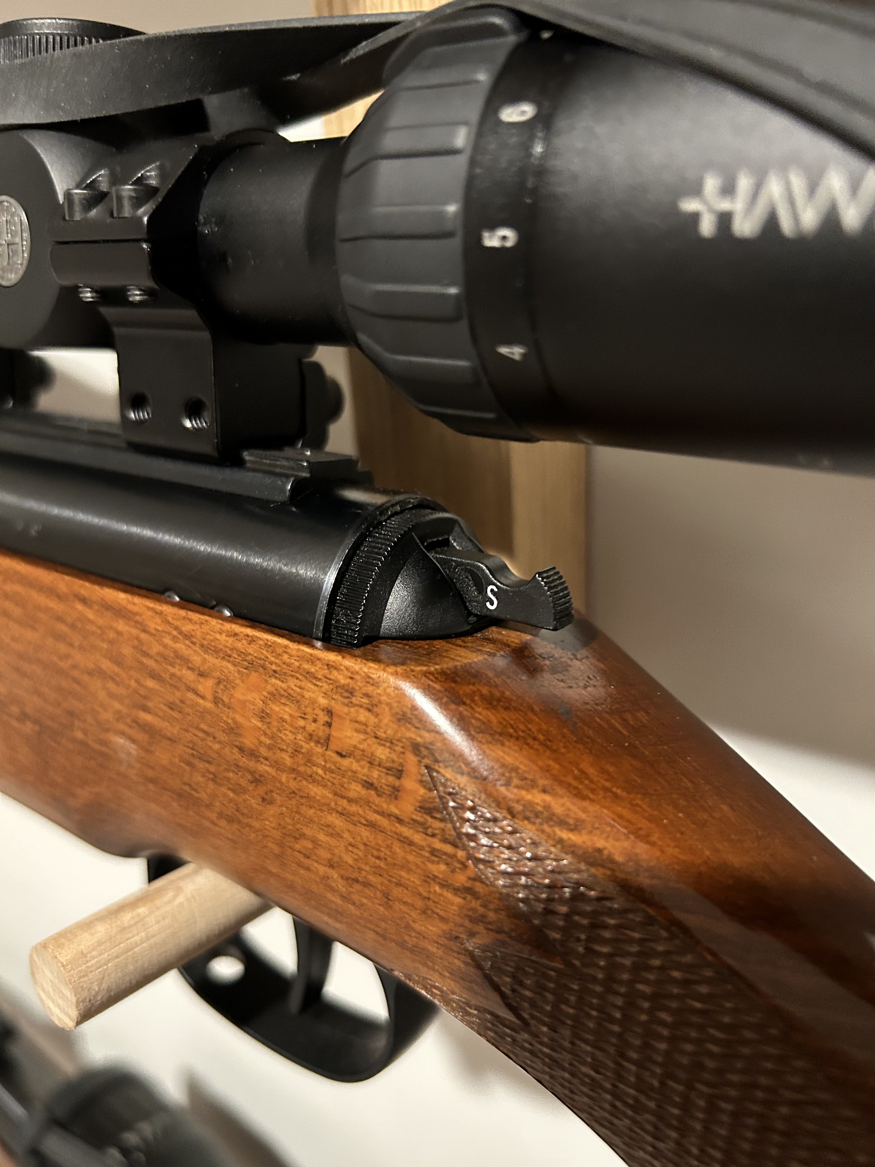

I do not post much anymore because I do not like to contest with all the B.S. on this forum. Such as HW rifles having cast pot metal triggers, etc, etc.
I have had two Diana 350 magnum rifles, one was the Panther 350 which has the synthetic stock and the one I still have is the 350 Classic. The Premium is simply a model with a premium stock with the cheekpiece for right handed shooters and as I am left handed never bought one.
Both 350 models I own started as you ask started falling apart much sooner than 500 shots, and one situation was very dangerous and I could have gotten seriously hurt. Lets address this first. The main stock to action screw will vibrate loose in less than 25 shots due to the recoil. It also only has on average two thread turns on that screw into the action screw boss, so very little recoil and back out is required for the thread to boss to become weak and tear clear out of the boss rapidly and violently sending the rear of the action flying at your face at high speed. While cocking the rifle the screw and boss will separate and the action will fly upwards right at your face.
My solution for both of them was to make a trip to Fastenal and obtain longer and better fasteners, install with a liberal coating of screw lock and this solved this dangerous situation. So make sure to check the main action to stock screw carefully and if required and if they have not changed this replace with an adequate fastener. Umerex which is the current distributor for Diana was no help at all and it was like speaking to a deer standing in a bright headlight and the light bulb inside was not on. Grin!!
Next, on both models the rear factory sight has adjustment held in place with two small ball bearings. In about 100 shots the sight will back out and get so loose due to recoil it will fall apart and if in the woods never be found again, if bench shooting it will land on the bench. Both guns did this.
Next, the rear automatic safety unlike the HW pot metal trigger, is in fact some type of pot metal. Around 300 shots fully expect this to break and the back half of it to fly off the rifle. Both rifles had this happen. To be fair the 350 classic since then has had well over 10K through it with no further problems with a factory replacement. However Umerex with the lack of a light bulb was no help and I got a replacement from a well known supplier in the UK.
