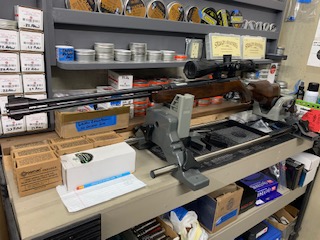

A friend of mine asked if I would repower/refurbish his 35 year old (he had the original receipts) .177 HW77. It is a stunning gun in appearance, as years ago he totally refinished the stock and gold inlaid all of the original stamped markings.

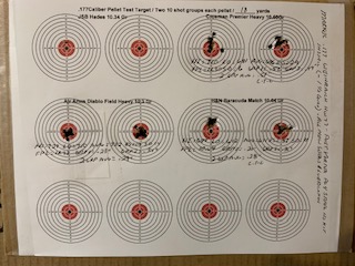

Upon receipt, I mounted a new Vortex Diamondback 6-24x50 FFP scope on it, on top of Sports Match High Vertically adjustable rings. I then proceeded to test the rifle. Even though it was down on power, and one could feel how dry the lubricant was in the cocking stroke, it shot amazingly well (see photo 1)

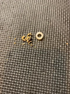

I then proceeded to tear it down. The trigger assembly as found (photo 2) indicated how hard and dry the grease had become while in storage for a couple of decades or more. The same condition existed on the compression and piston components. The breech seal had totally hardened and fragmented as I worked to remove it (see photo 4).

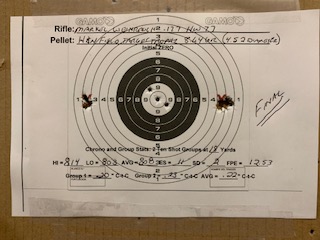

You can follow the rest of the pellet testing via the photos found below to whatever extent you like, but in the end, the accuracy and smoothness of this old rifle was amazing, achieving an average across two 10 shot groups of .16" c-t-c, shooting the H&N FTT Trophy 4.52 pellets at 799 fps, producing 12.4 FPE.
