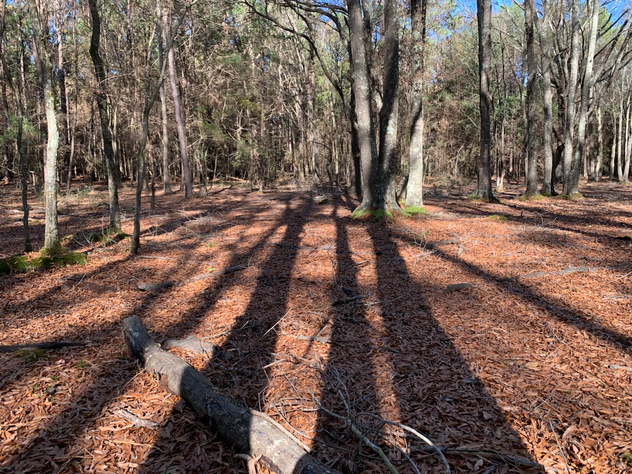

Here is where I posted.

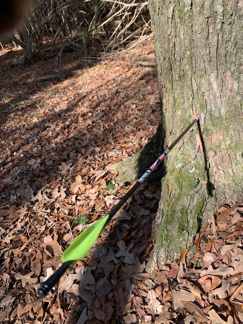

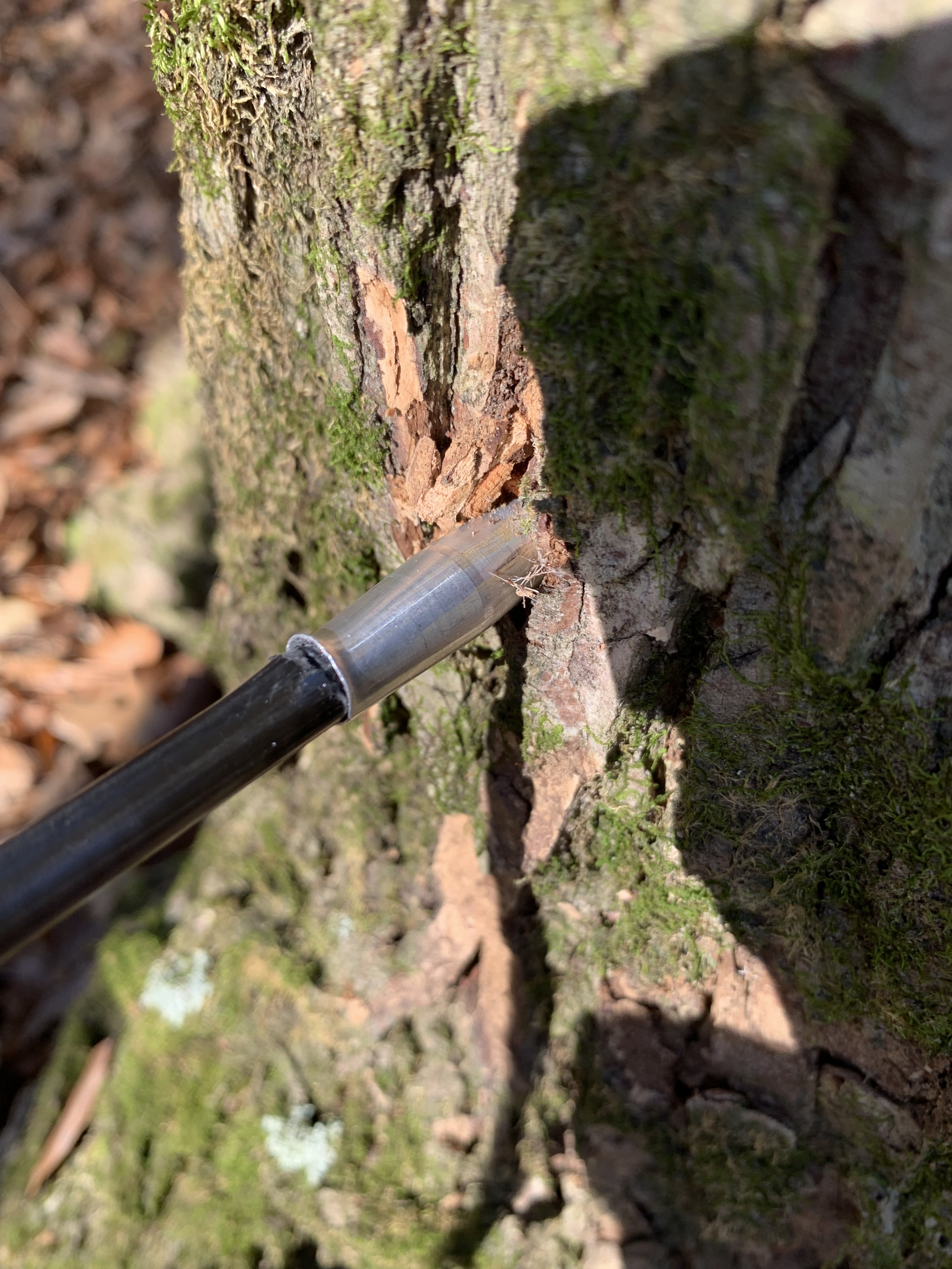

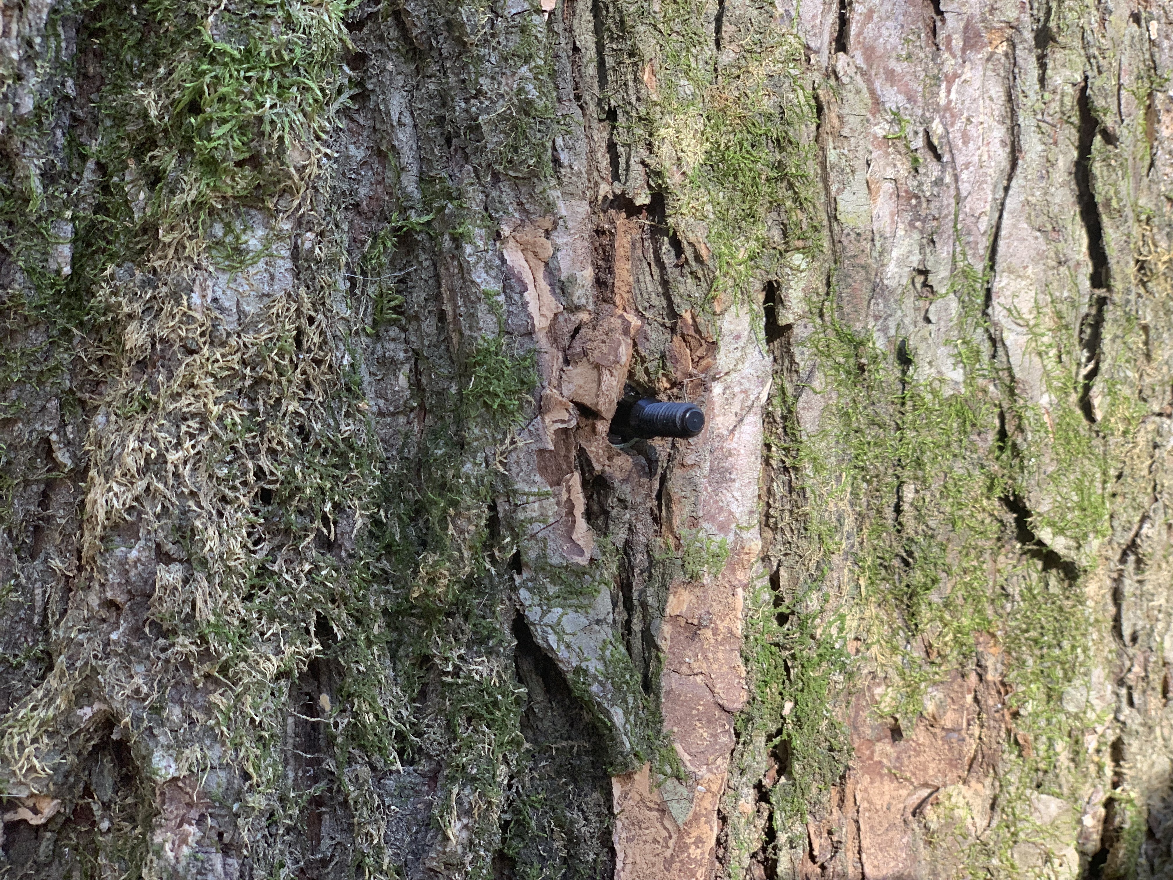

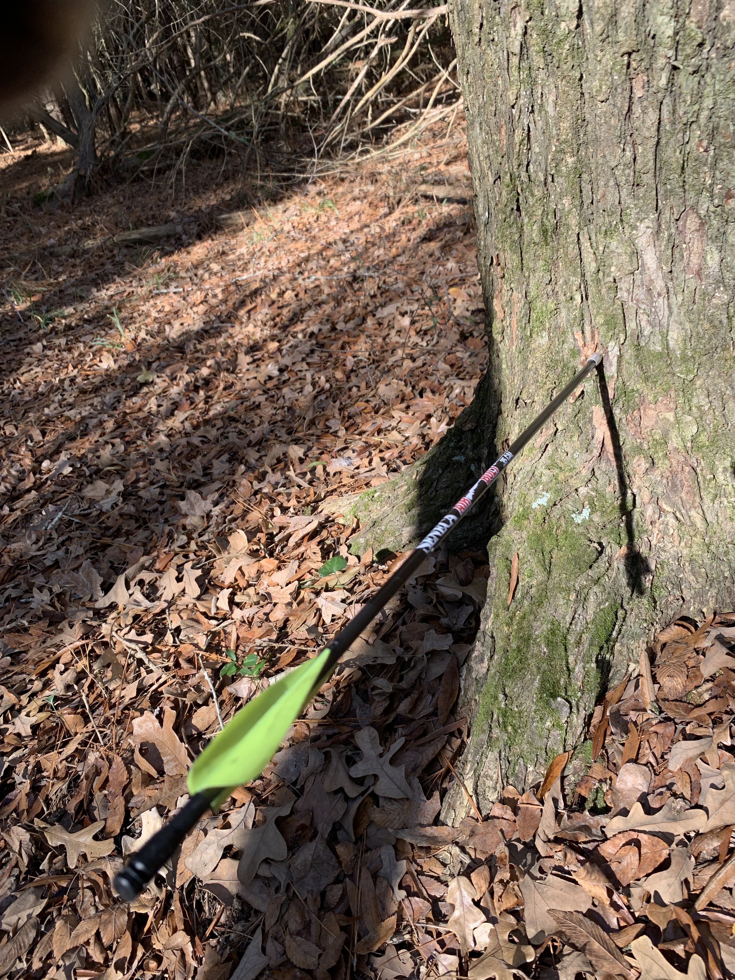

The deer came out of the treeline about 55-65 yards out. When the one I wanted got within 45-50 yards I took a shot with my .35 Seneca Air Bolt that I’d had loaded in the barrel for several days. It was fitted with a Sykd Endurance Hunter trocar 100 grain broadhead for a total of 375 grains. I admit I got excited when I saw the deer eating acorns before taking my shot. I lined up the reticle dead center for the lower shoulder and missed!! I’d forgotten to use my holdover! 😡 It cost me a bolt and the arrowhead was lodged too deep into the trunk to retrieve. Notice how the fletching is still curled from being in the barrel so long and being in 30 some-odd degree temps fora few hours. It still flew pretty straight.

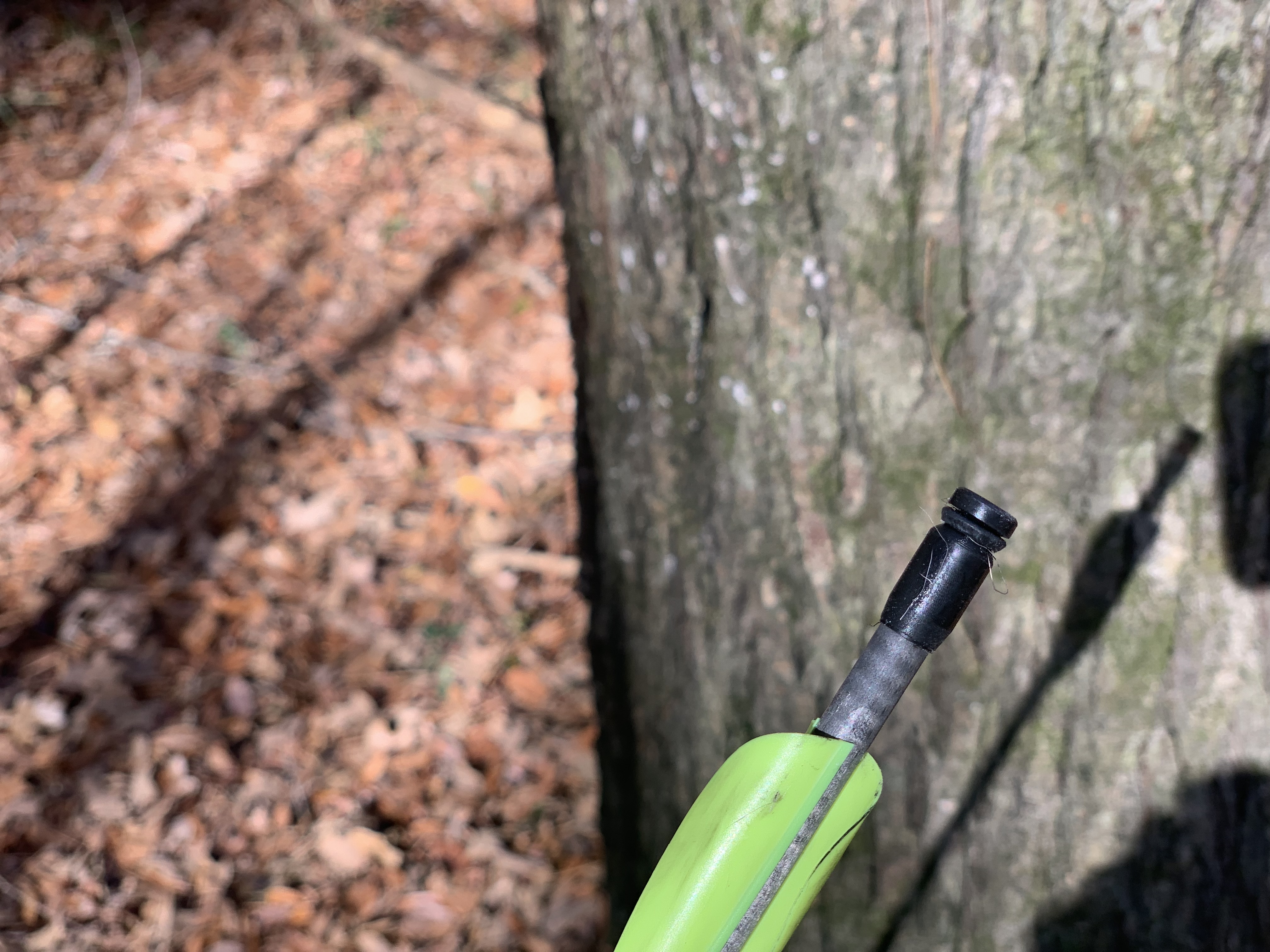

Here’s a photo of the damaged part of the bolt.

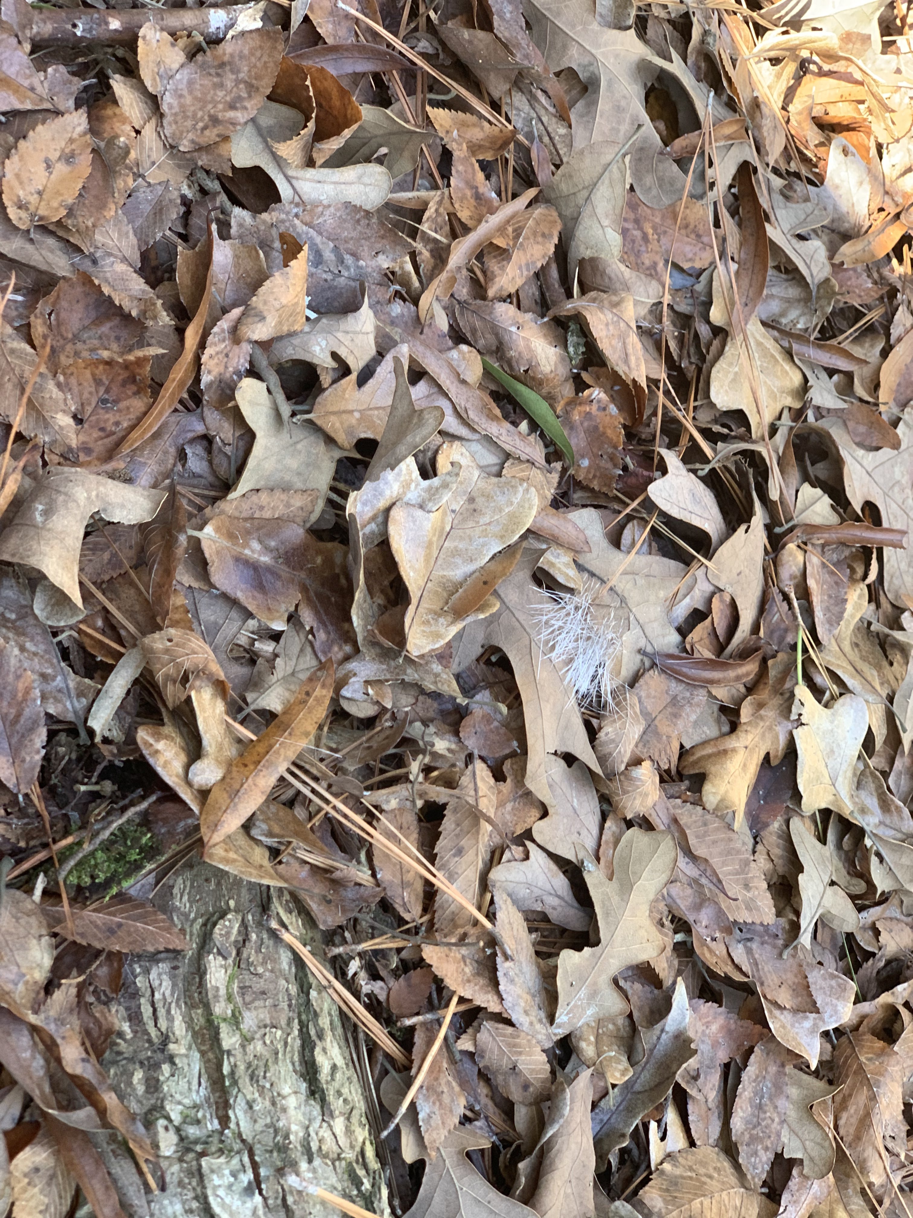

There was also fur on the nock and a patch of fur to the left of the tree.

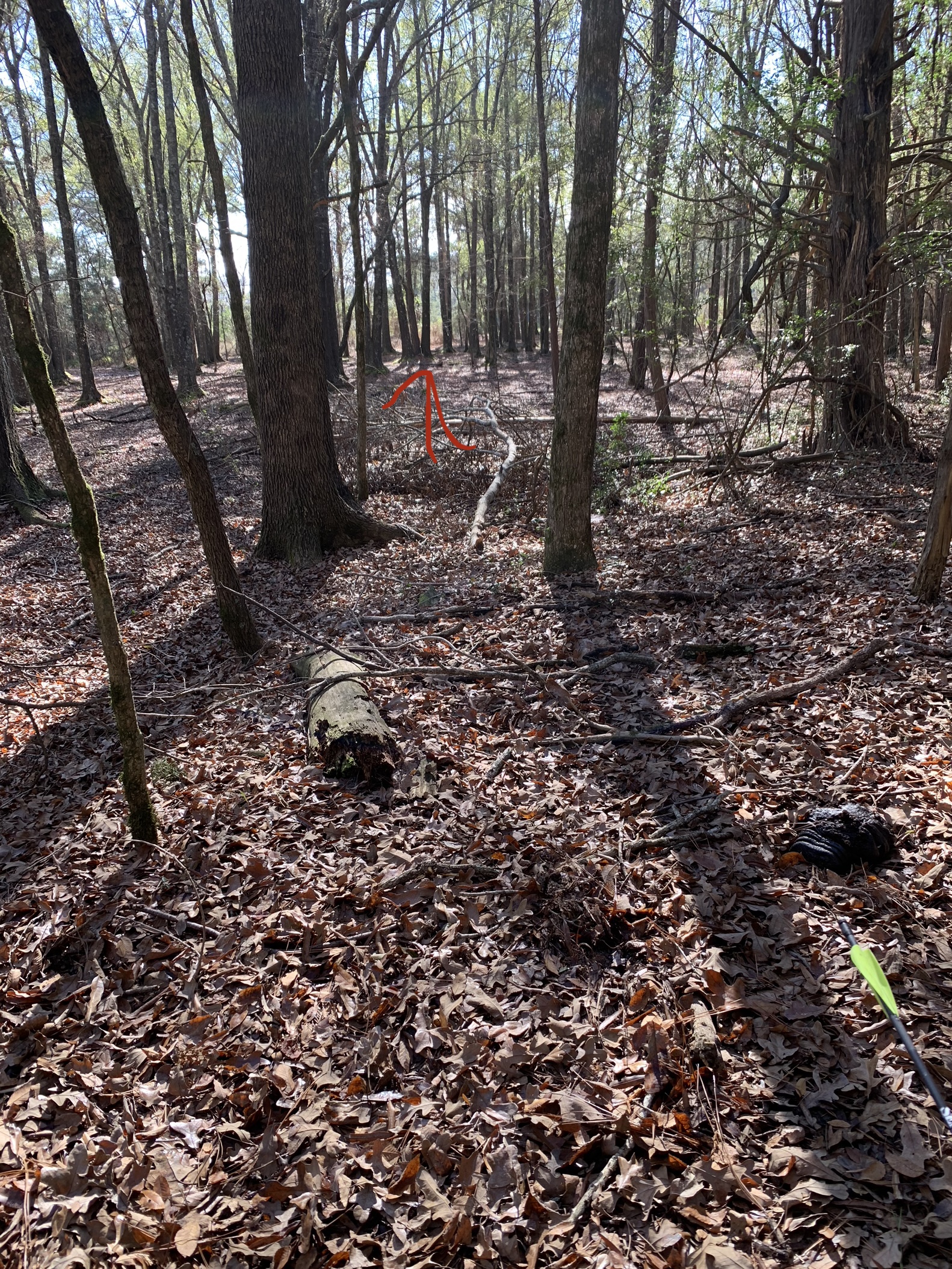

View from the bolt to my post (by the red arrow).
I had to have barely grazed her on the belly. I’m absolutely confident that this broadhead will smash a deer, bones and all.
