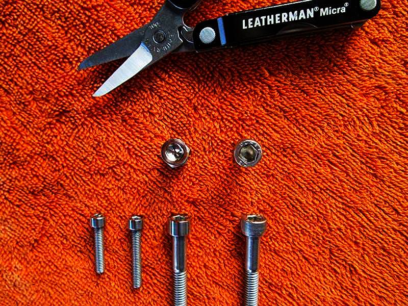

Personally, I find those acorn-looking nuts abominable.
I would not even put those on a centerfire, let alone on an airgun.

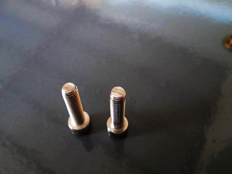

I am very conscious when it comes to scope rings even its screws.
A screw may be an insignificant part to some but I give them beauty.
Mine do not have ugly "splines" or markings.
I also polish them and deburr the bottom.
I like my screws, even set screws, look like a work of art ☝️

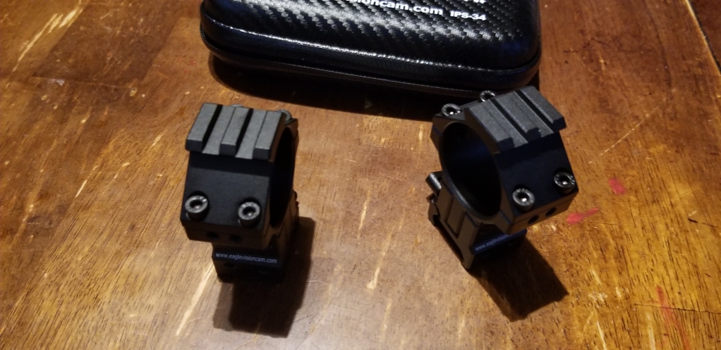

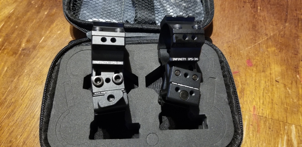

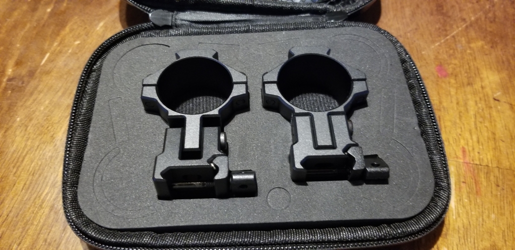

I have the Eagle vision INS -34. They're awesome. Very very similar to the IPS variants just without the picatinny bits on the top and with the ring tightened at an angle. I like the fact that they look a lot cleaner and slicker, but if you're planning to mount additional torches etc then the IPS might be more suitable 🤷‍♂️
