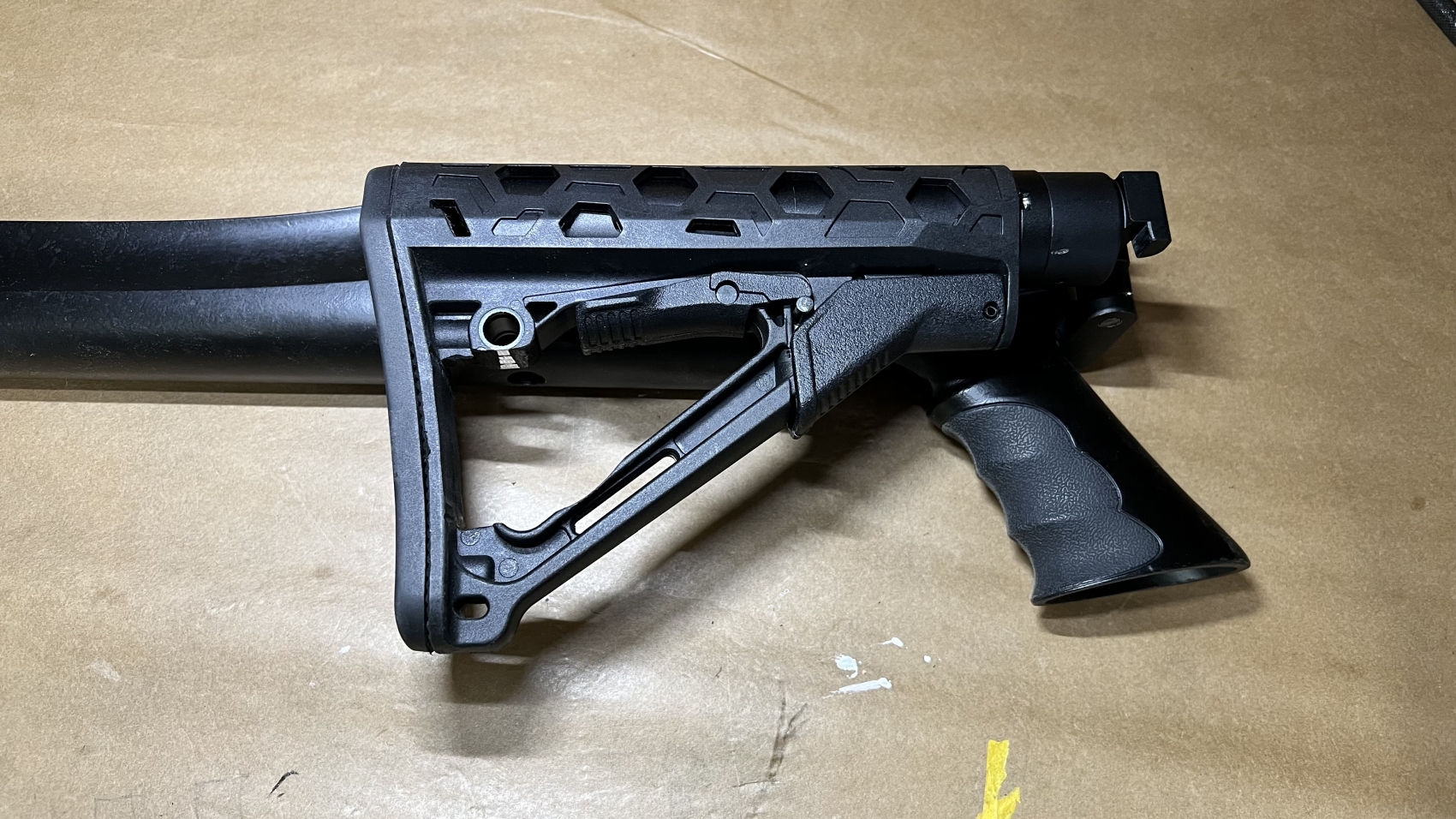

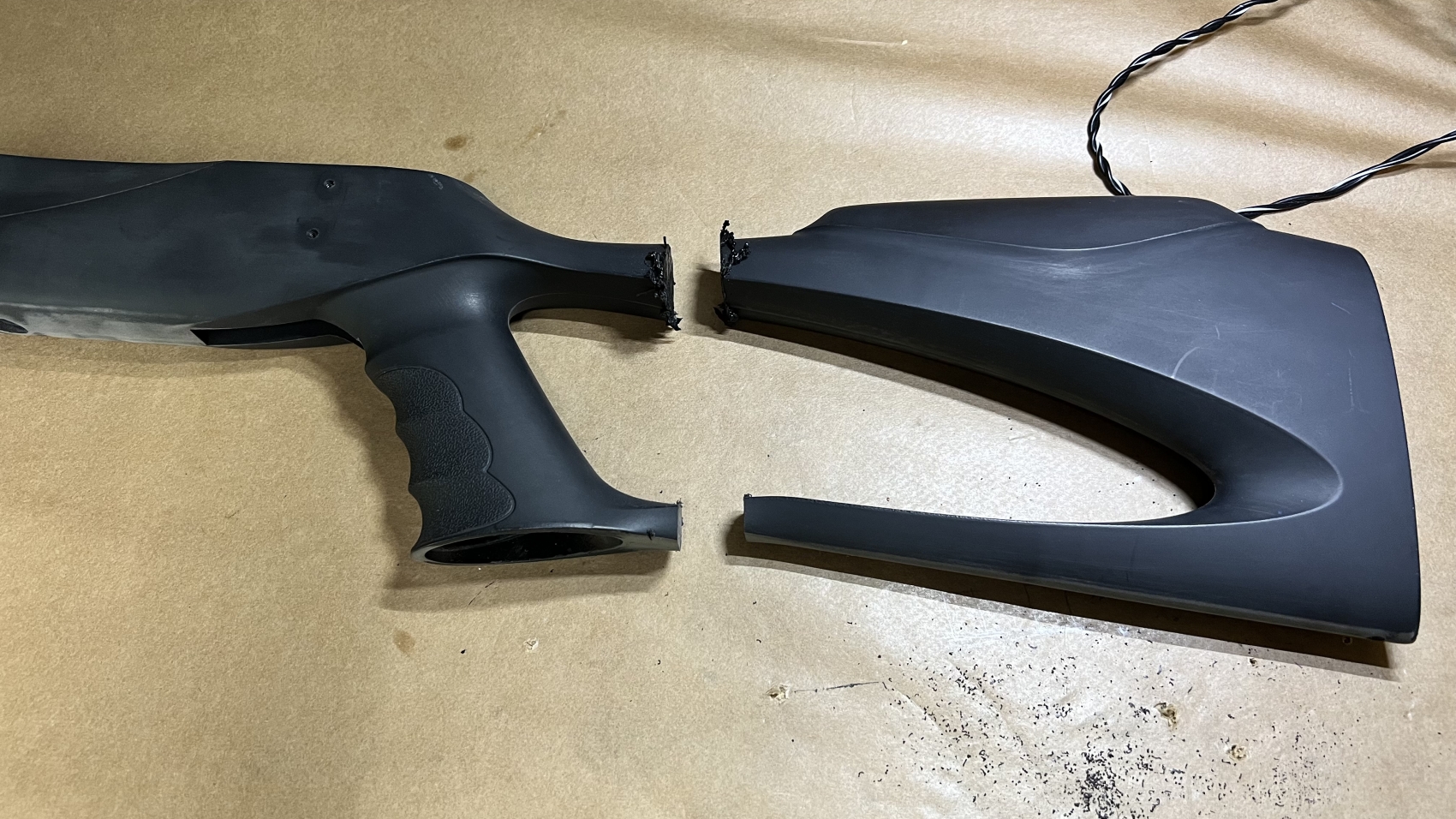

The plastic stock of the m25 feels pretty heavy and wanted it a bit shorter so i grabbed the hacksaw and powerdrill.
Yikes, the first cut always feels wrong

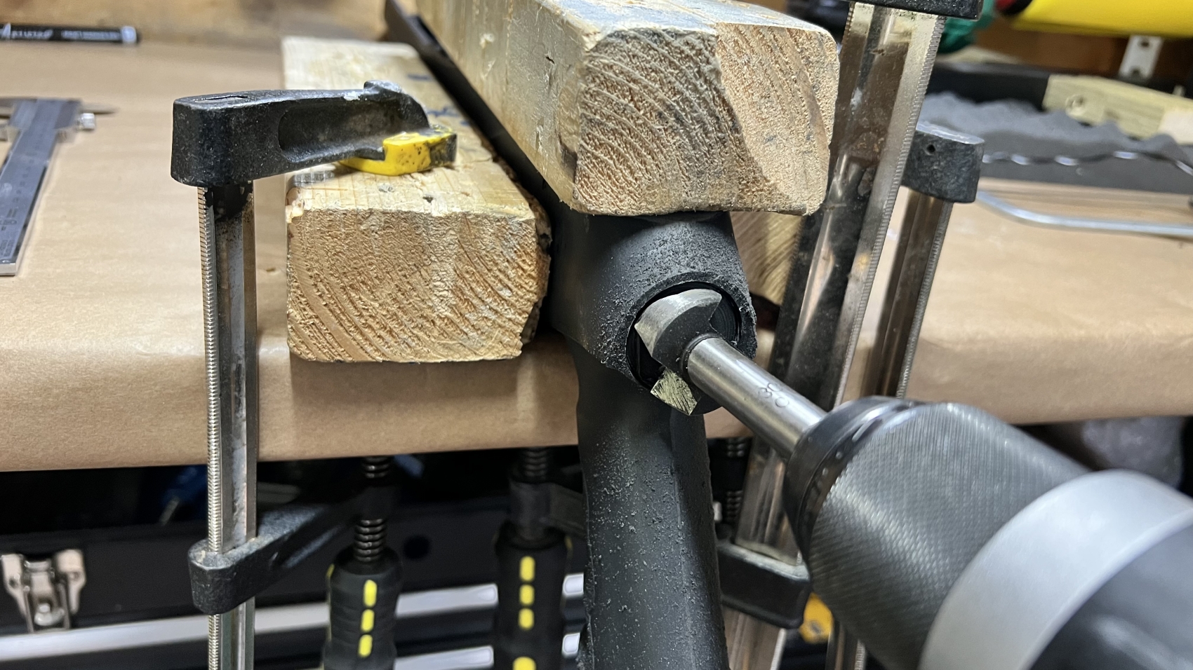

The back of the stock drilled out with a 30mm drill bit to hold a folding adapter

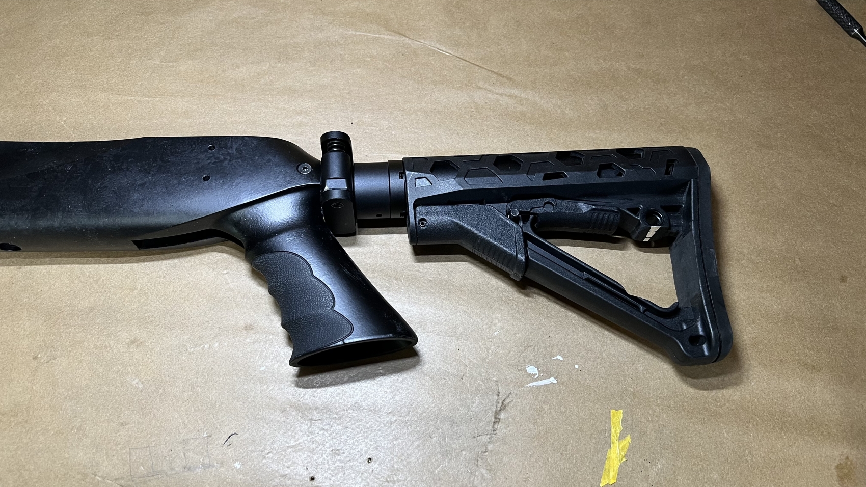

The folding stock came from some Chinese seller, i wish i had paid more for a decent one...

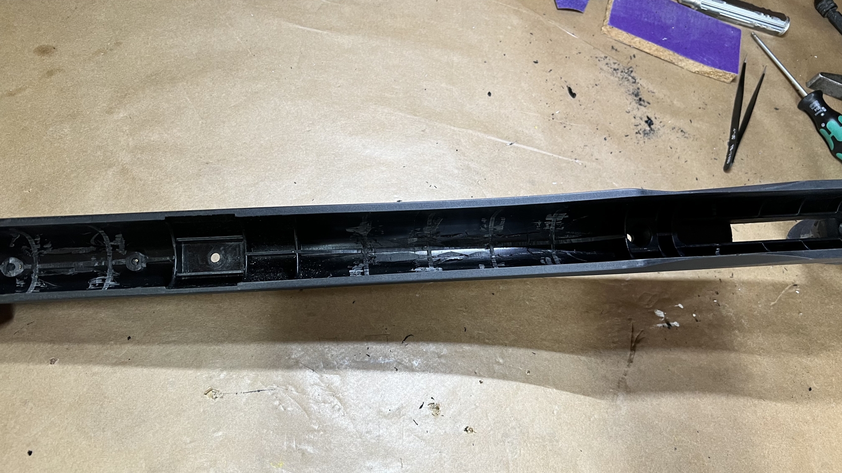

The inside of the stock on most places cleaned out except around the trigger and mounting places

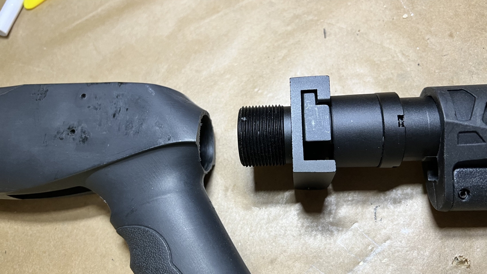

The stock adapter glued into place with some epoxy resin and two m5 screws to keep it in place
