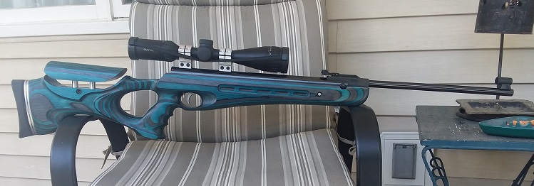

Commented the way I did because although only back to shooting 6 1/2 years now, all but one piece of everything I've ever bought was paid for in cash and it's been a lot considering 50ish different rifles and pistols (down to 26 now) and everything else to go with them. Bills always come first and toys after, limited to what the bank account could afford plus a little here and there saved when I could.
The one and only thing I ever used a credit card for (and I only have one) was for the laminated stock my HW95 now sits in. Kept seeing pics of limited edition blue laminate stocks on a few HW and Beeman rifles and always wanted one only a thumbhole so when I finally came across a maker for one, I dug out the card and went for it. My one and only springer with close to $1000 invested between rifle, scope and stock. The rings are BKL just because they were the only ones I could find in a silver finish and what I wanted to match to the rest of the stock or as you put it, marry it nicely to the gun including stainless steel front stock screw hardware:)
Sweet gun!
