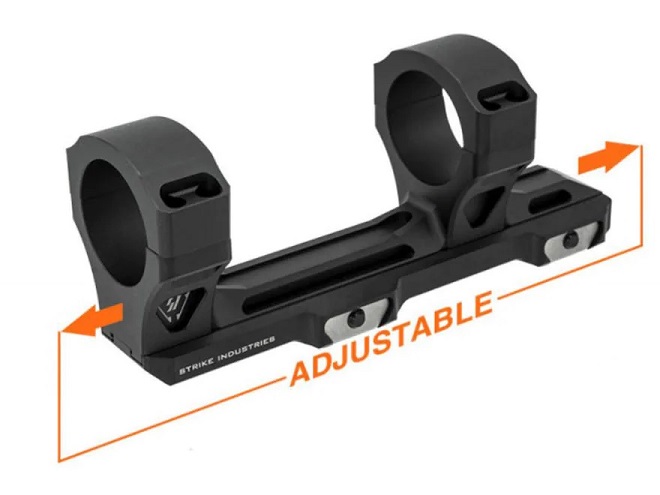

I like the Strike Industries adjustable mount. You can change it to 4 different lengths of cantilever, fit and finish is great also.
Strike Industries Adjustable Cantilever Scope Mount

Reactions: Glenroiland
