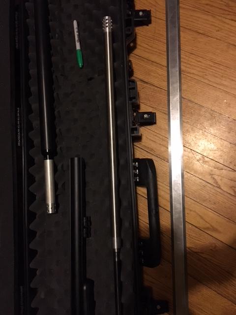

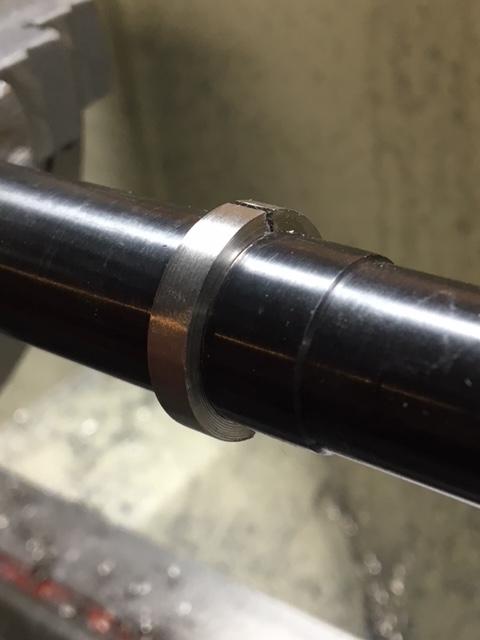

1. Split retaining ring - I made a ring made out of 316 stainless steel on my lathe with an OD of 0.8" and an ID of 0.60 and a thickness of .170". I cut a groove to match in the barrel. After I turned the ring on the lathe, I used a dremel to cut it in half, didn't really cut straight but it'll get her done.

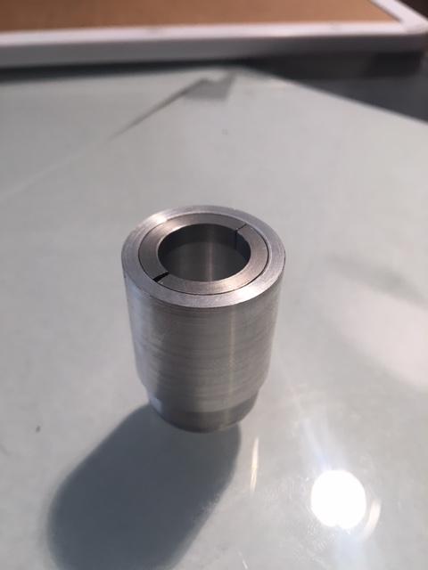

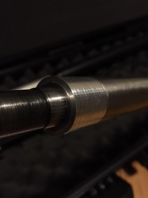

2. This is the retaining cup. It has an OD of 1.03" with a through hole of .671" and a .170" deep recess with a ID of .795" and a shoulder on the other of the retaining cup that has an OD of .895" that the titanium tube sits snugly on. It is crucial that when the split ring is on the barrel, the fit between the retaining cup and the split ring is press fit, this ensures no separation of the split ring halve when I go to torque this puppy down.

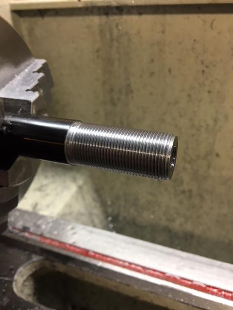

3. Threaded the last 1.5" or so of barrel with a 5/8-24 thread

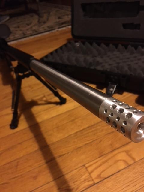

4. This is the barrel assembly without the titanium tube. The retaining cup is pressed onto the split ring halves and the muzzle brake/tension nut is screwed on 7/10ths of the way.

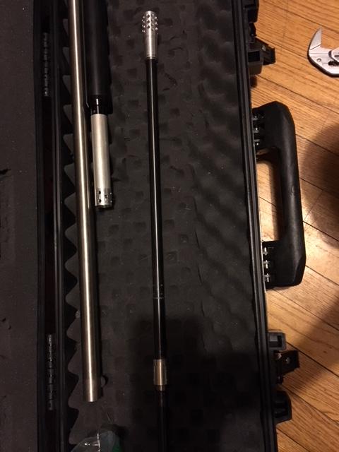

5. This is the complete barrel assembly with the titanium tube in place.
6. This is the retaining cup when the titanium tube is in place. I had to sand the barrel down a tad. There were slight burs left from machining as well as those left from the set screws prevented my .671" ID retaining cup to slide on. I smoothed it out with some 320 grit on the lathe.

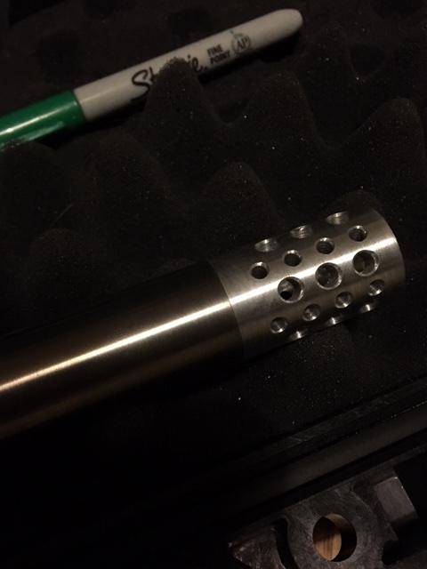

7. This is the muzzle brake/tension nut. I put a long hex key through the holes in the muzzle brake and crank it tight.
8. Another picture of the muzzle brake and barrel assembly.

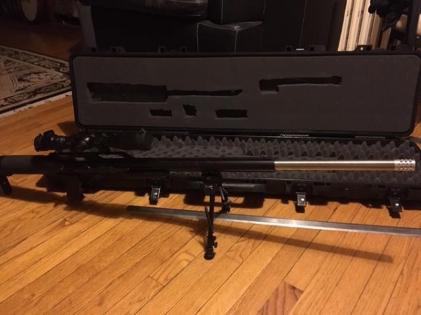

9. The whole thing. Yes the .308 Texan fits in my hard case with tank and new barrel on with an inch or two to spare.

2. Make the barrel tension nut separate from the muzzle brake or silencer. This way if switching between an airstripper/silencer/muzzle brake you don't put more wear on the barrel threads.

2. The muzzle brake I made actually worked. When dryfiring a 3000psi fill, the felt recoil with and without the muzzle brake is what you'd expect from any other brake/shroud. The noise is reduced slightly but no where near the dB level of the Texan with an R&L shroud.
