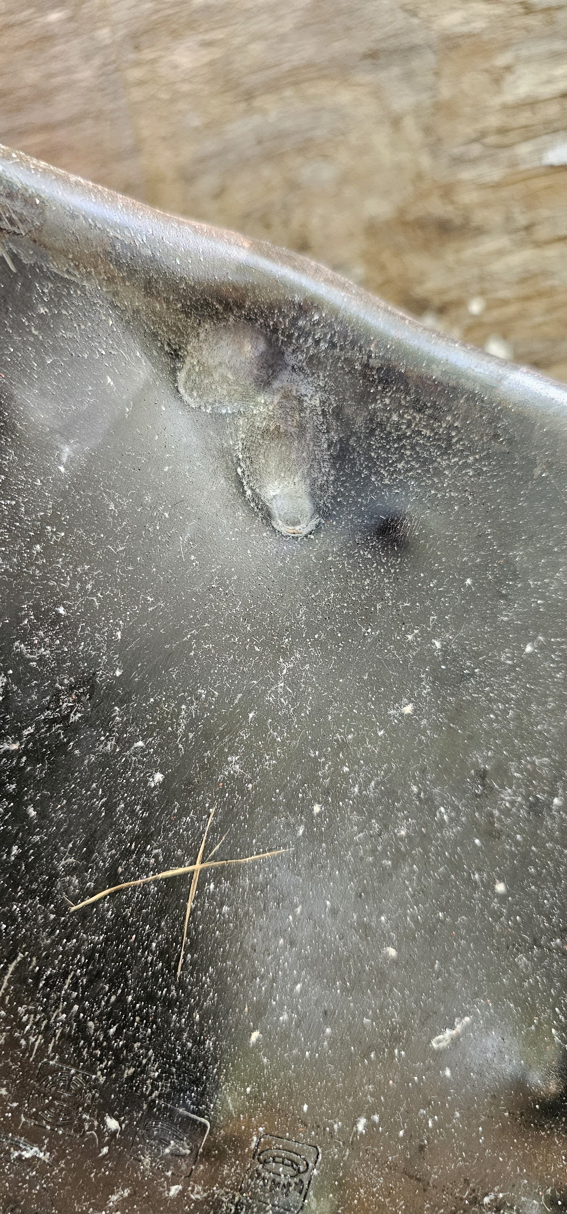

I really like my 357. This 2 shots at 100.
.6in Ctc. Just 2 shots, i am going for more in a group, but i shoot too random. Lmao. Also did you ever push a slug through a get the right diameter. This one likes .356 and others say theirs like 357 or 358.
