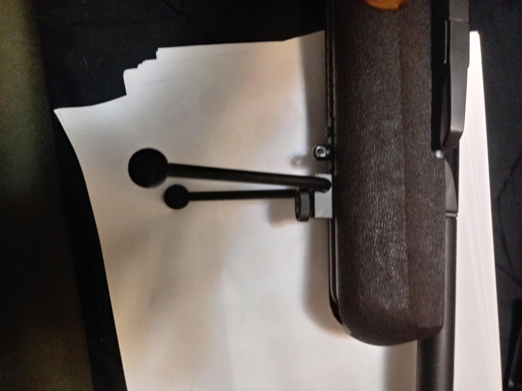

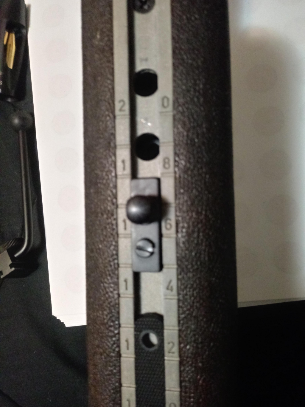

now if you are handy and have the right tools you can make your own by using a flat bottom weaver mount and a piece of 1/2 x 1/8 aluminum stock
you must remove 1/16 inch off both sides and it is a perfect fit for a Anschutz rail drill and screw the weaver rail to the adapter you made and you have your mount for your bipod
I used a router with a milling bit for my cut but a table saw would work with a plywood blade
so that is about all I have for mounting a bipod to a weaver-picatinny mount and to a Anschutz accessory rail

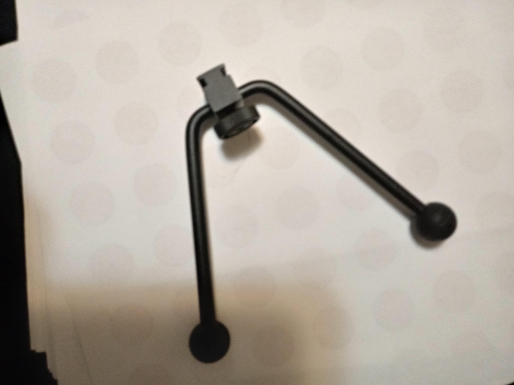

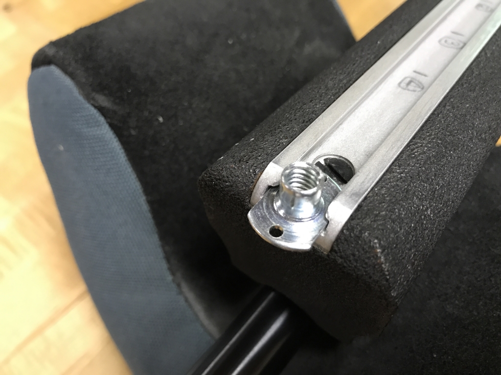

I used to make my own tee nuts for rail accessories until I found these Rectangular Tee Nuts at ACE Hardware. They fit perfectly although you will have to either grind or file the thread boss so it doesn't protrude above the rail, or drill a recess for the boss in the rail accessory. I always drill the recess in order to assure good thread engagement. This shows the fit to the rail of a 300S. They also fit the Anschutz rail.
