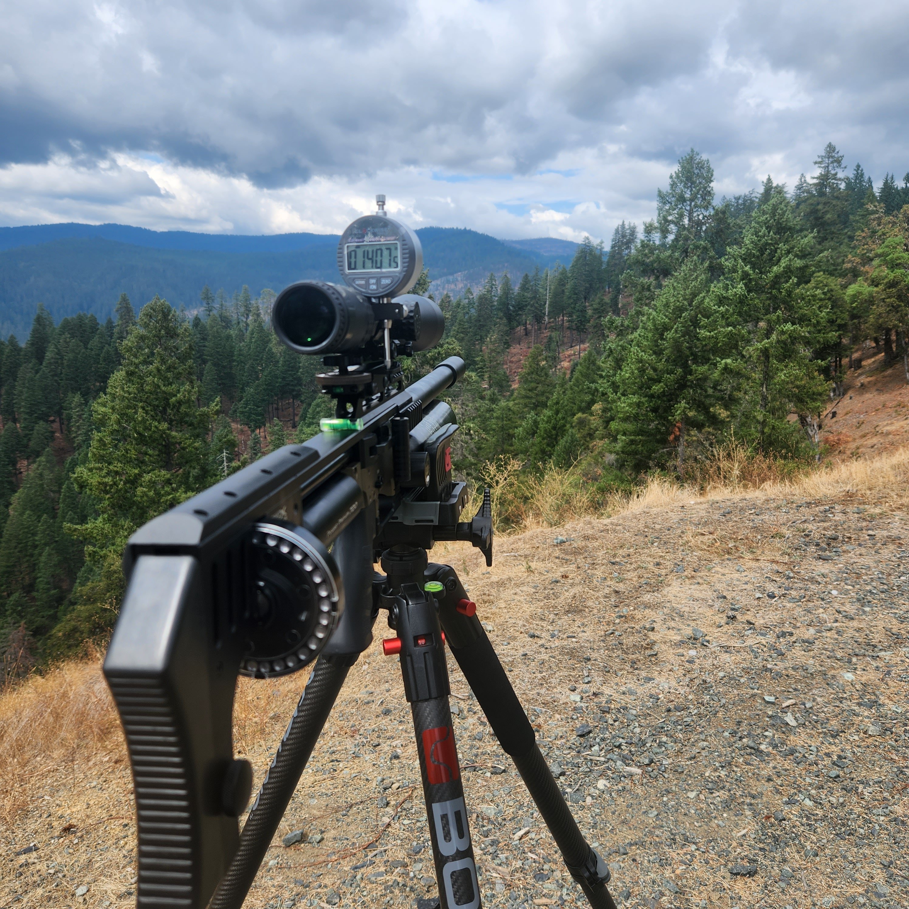

300 yards on steel with .25 M3
We had a great time at the range this weekend. As many know, there is something very gratifying about the sound of smacking steel at long range.

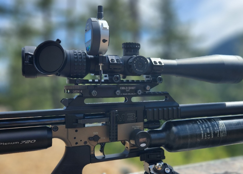

I was shooting some .25 prototype slugs out of my 700mm M3 with a Coldshot adjustable base and the Absolute MOA Digital Readout. Conditions were breezy and cold but we still had a lot of fun.
The wind tricked me a few times which made for some close misses but overall there was some decent shooting considering the conditions.

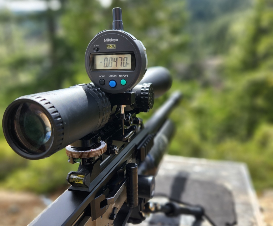

The Coldshot base is pretty good but I still like the Ravin Jack Plate better. Keep in mind that you'll NEED the Absolute MOA Digital Readout Kit for the Ravin and you'll WANT the Absolute MOA kit for the Coldshot. Plus it helps that the Ravin is also half the price of the Coldshot.
wow that's awesome pictures.. so it's basically a thumb wheel and a digital dial indicator.. I use dial indicator on my lathe and mill a lot..
since it must have a hinge joint in the front and the back is the adjustment wheel, do you notice any play? like a lot of things there's play in joints.. but if it is high quality it probably has adjustable tension in the hinge joint, just like the slides on a mill..
also I wasn't sure from the picture, does it clamp to your gun rail and then are the rings part of it or does it have a upper rail and then separate rings..
it's definitely what you have to get for long distance shooting with a scope 👍
oh I was able to enlarge the picture so I can see you have a upper rail and separate rings..

I really like the jack plate, I couldn't find anything about windage..do either the cold shot or ravin have any windage adjustments? because I have been known to shoot in side winds just for practice to get used to how much windage or lead you need..

There is usually never any windage adjustment on any of the adjustable scope bases. That, you can adjust on your scope or use the windage marks on your reticle.
