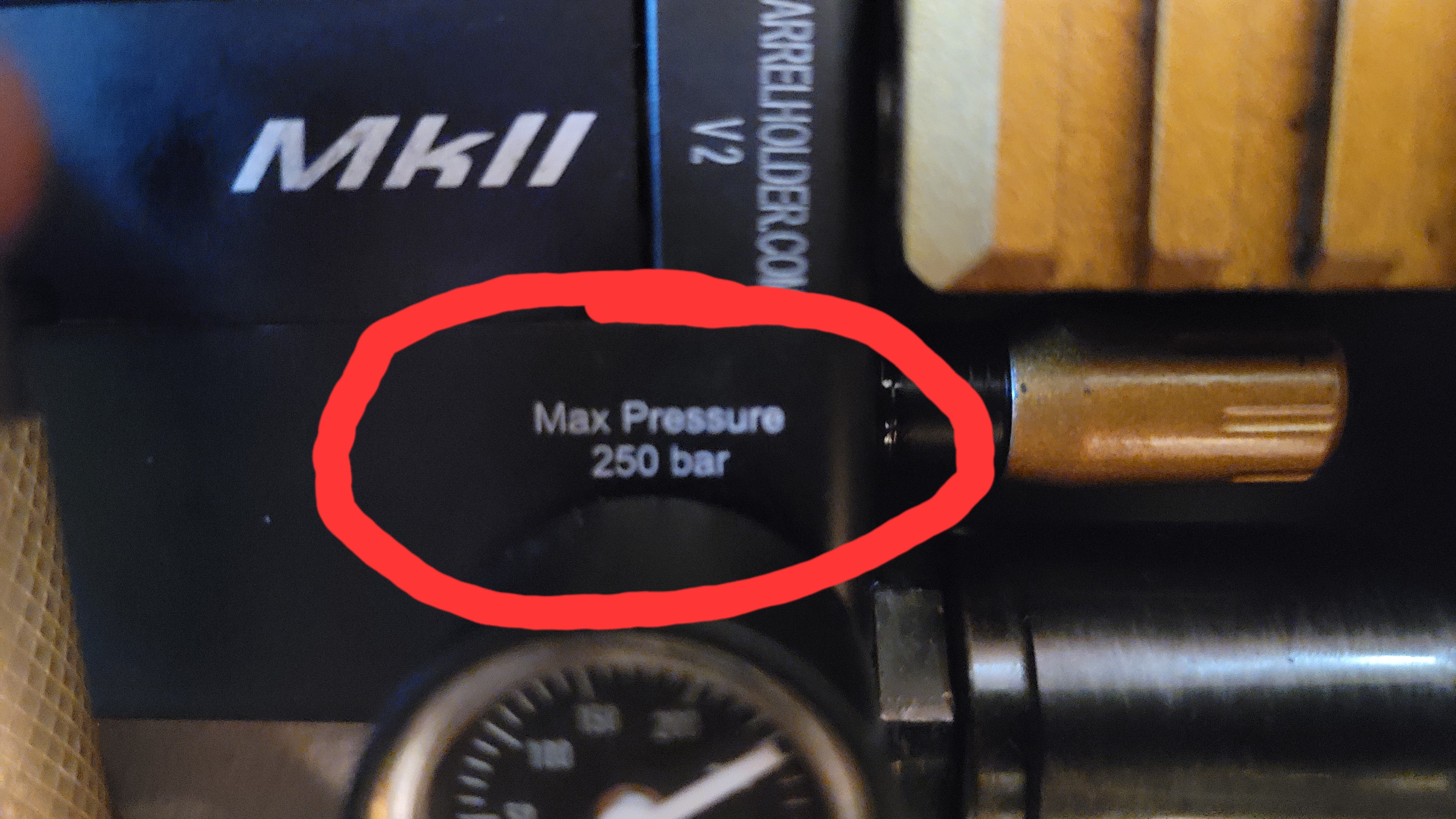

Thats a mk2, says max fill pressure is 250 bar.

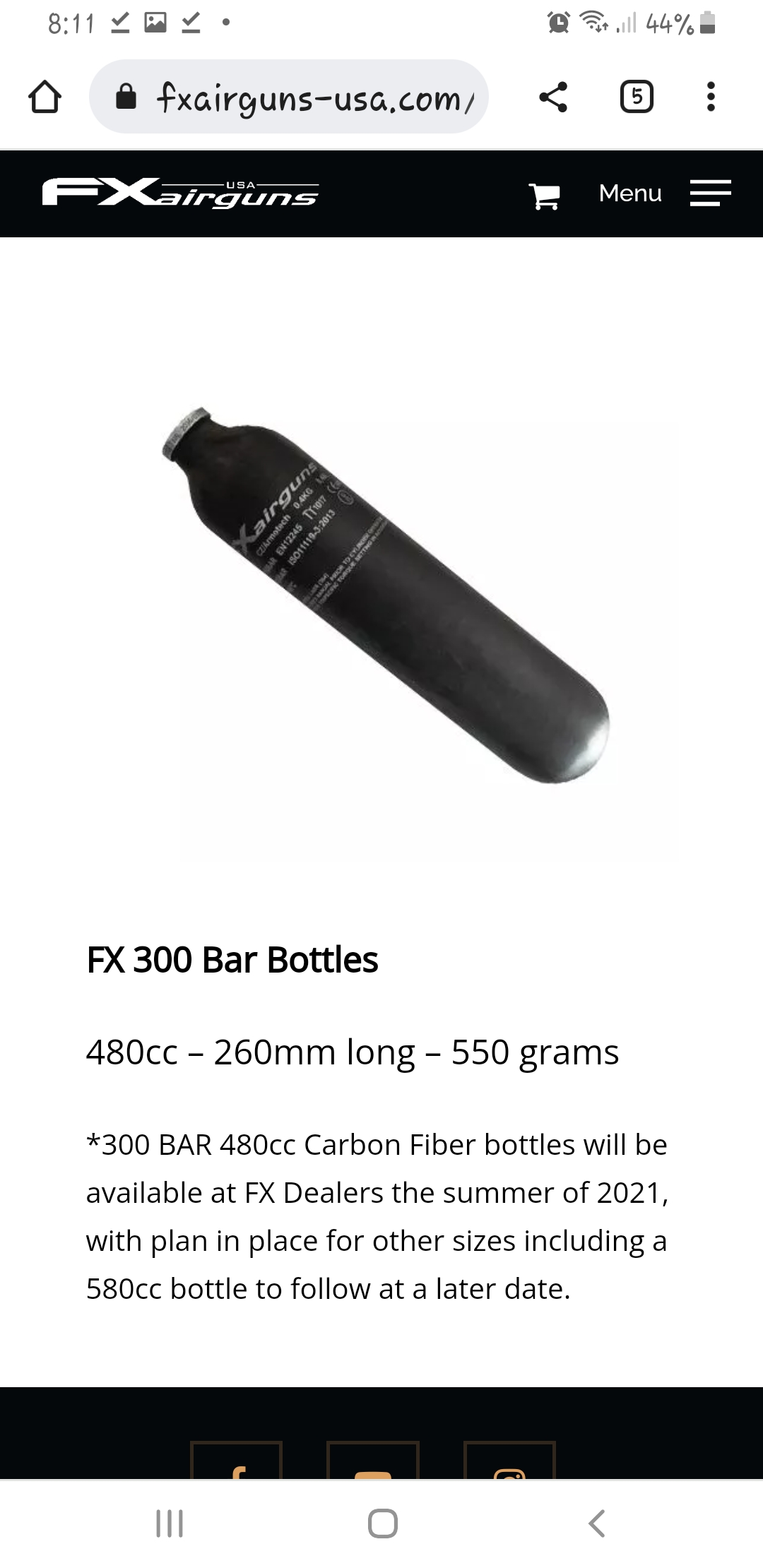

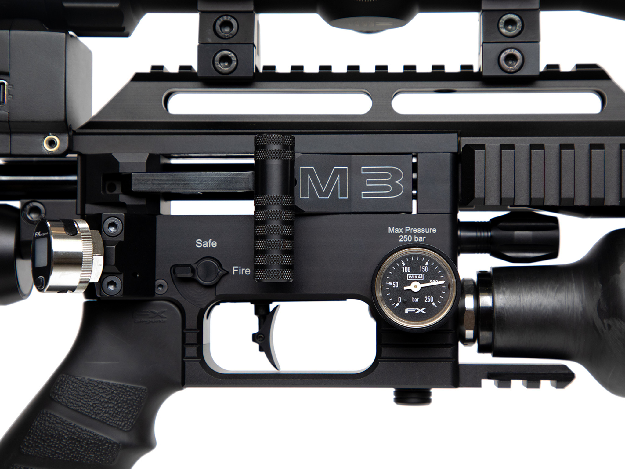

Below is the m3. Also says 250 bar fill pressure. So please tell me why fx said its ok to use 300 bar on a gun that is also designed for 250 bar fill just because it have 2 regs? Hmmm?? Lol. They didn't just say its ok, they are making their own 300 bar bottle to sale for the m3 which says max fill pressure is 250 bar. Now what gives.
What you're failing to understand is the first reg brings the pressure down before it goes into the gun. Does the mk3 action ever see 300 bar? No. Would it if you just slapped a 300 bar bottle on a mk2? Yes. Is 300 more than 250? Yes.

All you're saying is, fill gun to whats stamp on the gun. But you haven't even answered the point of the thread. Lmao. The m3 is stamp on 250 bar max. Then why are fx making 300 bar bottle for the m3 and maverick and say its ok to use 300 bar on a 250 bar gun. o_O. so fx is crazy and nuts telling us its ok to fill past the max fill pressure of a gun that is designed for only 250 bar max?
