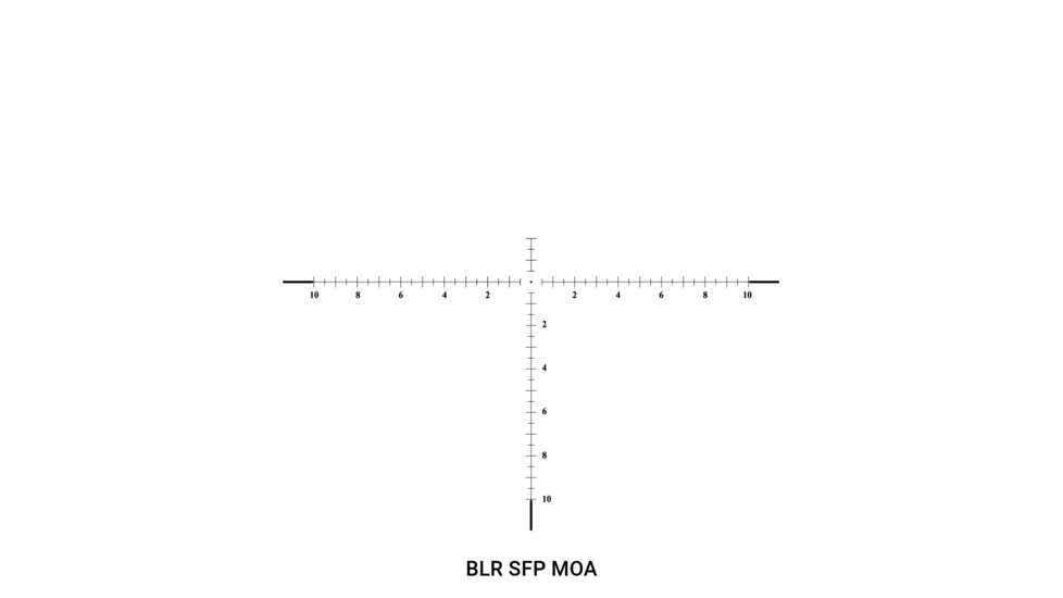

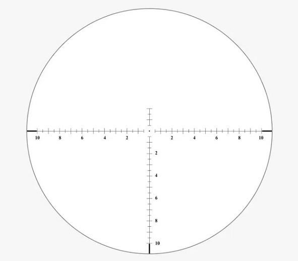

Hello @tommyb
The scope that I have on my Crown now is an Athlon Argos BTR Gen2 10-40x56 BLR SFP MOA Reticle Part# 214071. You can look it up and read all the specifications. The small dot in the very center of the reticle is so small at 30-yards that it easily fits inside the "X Dot" on the 30-Yard Challenge target. I am attaching a photo below. When you have that Dot dead center on the 30-Yard target and pull the trigger without movement of the rifle, you just "have to hit on or very close" to the "X dot". With a miss, it is still a 10. This excludes wind and etc.
As I had stated earlier, my biggest enemy is rushing a shot ( this most often happens when I am not relaxed ) and most likely as you stated, that is also your enemy.

is that dot that small at the high power you shoot at? i can see that dot would cover the center x -dot my ffp helix has pretty small center dot as does my arkens scopes 10-14 power is all i use could see myself to shoot at 38x power be so danm shaky

Hello @douger
I shoot at x40 and yes, the Center Dot of the reticle is so small that it fits within the solid black "X dot" of the target. I rest my Crown on the large Layman Bag ( this is the one with a "center" and bags on either side ) which locks the gun in place and rest the gun butt on bags, I have almost no movement. I adjust elevation with the Layman Bag Jack and windage by moving the rear bags. I have shaky hands and this keeps the rifle really steady. It takes a bit of adjustment time to zero in on each Bullseye, but this works for me.

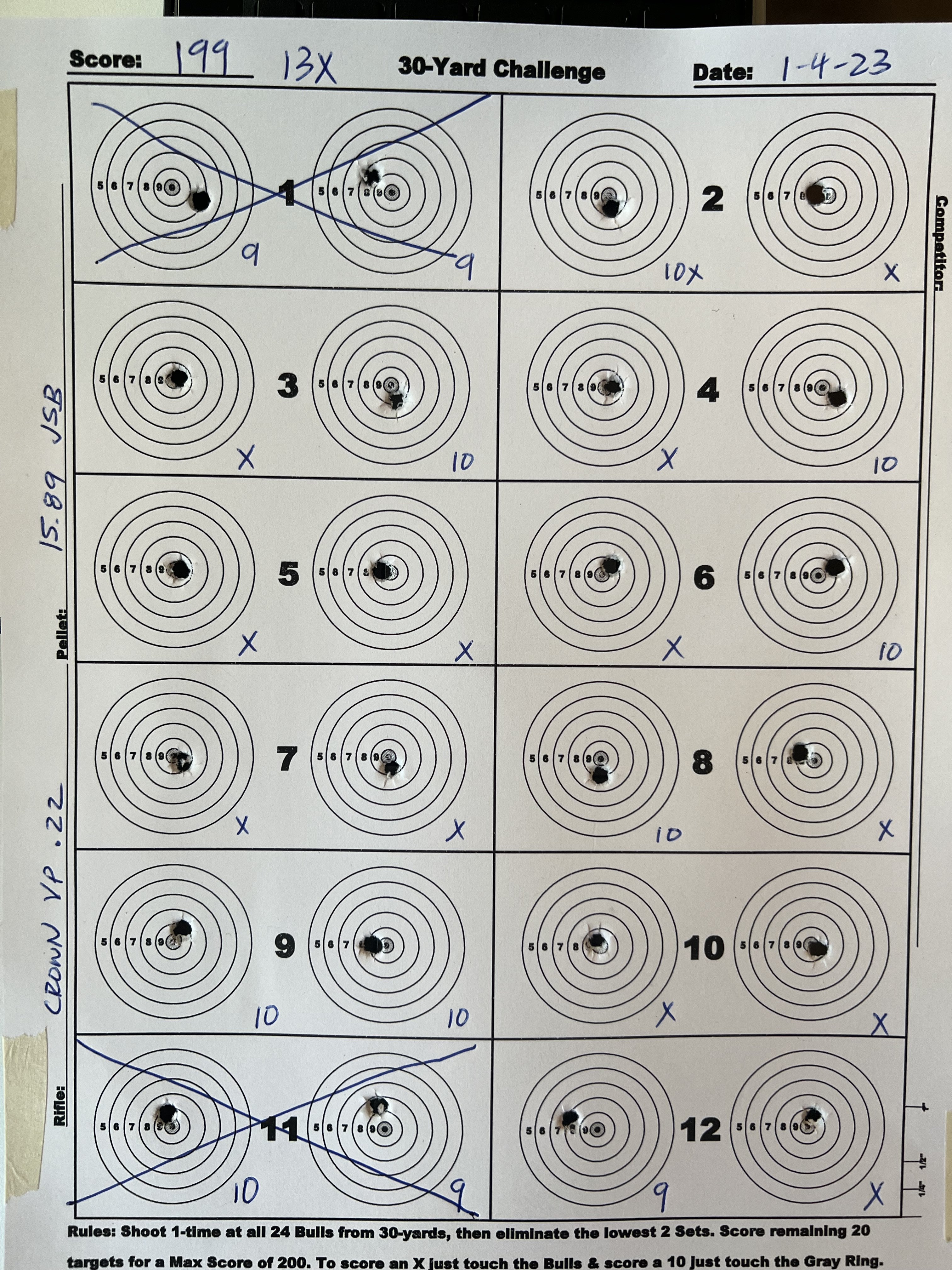

My FX Crown decided to attempt matching @ThomasT 's fantastic card that he recently shot. We fell a little short, but still feel pretty good about our score, a 199 13X. Choked on the last box, again, #12!!
Ditto! I’ll take a 199 any day of the week.

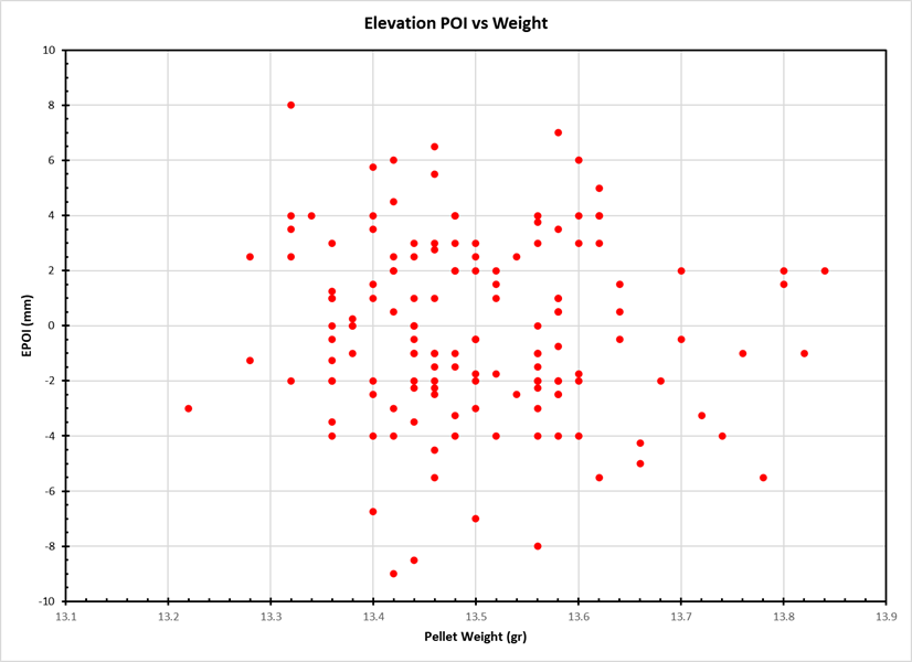

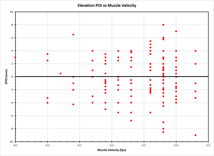

Hi Guys!

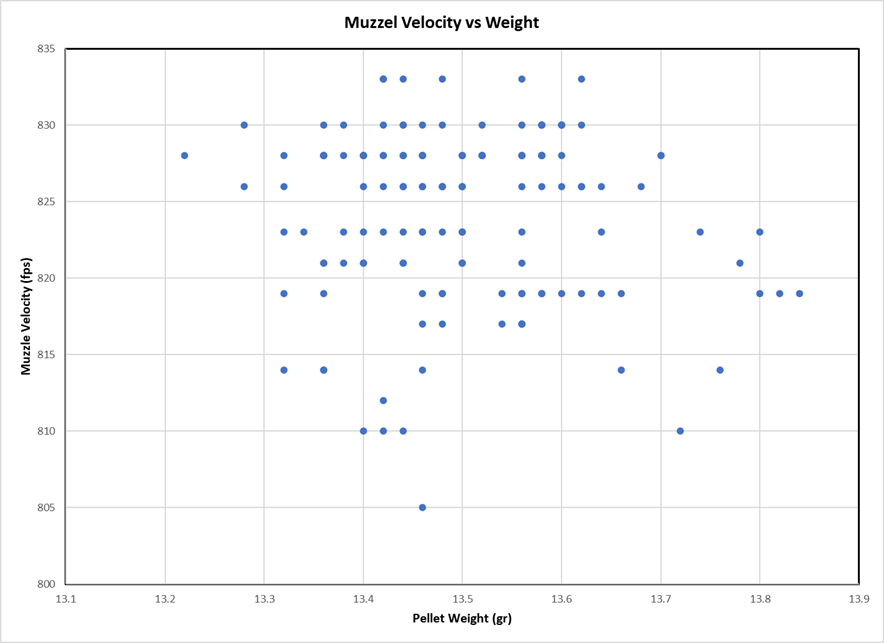

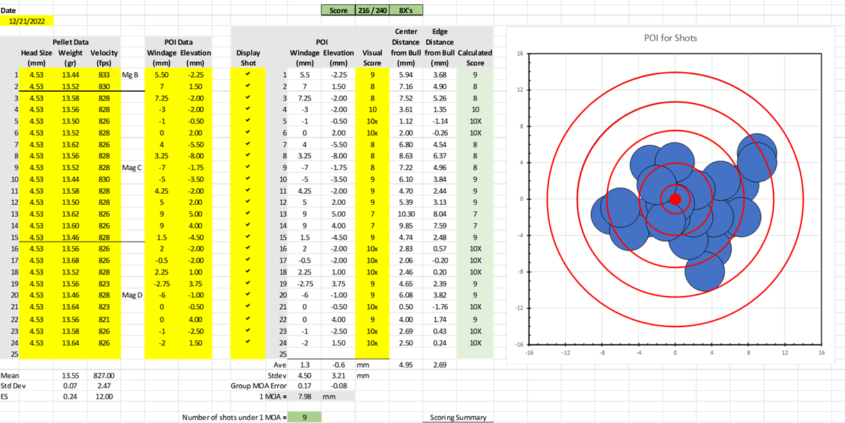

ThomasT has been imparting lots of wisdom here and has once again inspired me to investigate pellets. Thomas has said he is now not sorting, except for obviously bad pellets when loading, and I think I have some data to support that. Ready to geek out to Excel? I weighed and measured 24 pellets, then shot them at the 30 yd Challenge target. I recorded the muzzle velocity from my FX Radar and measured and scored the points of impact. I did this for 6 targets over three days. The shooting was from the same setup at the same location (my backyard), but I had different wind conditions each day.
An example of one target's results is provided here.
Note that all of the pellets had the same head size. That is because I was using a PelletGageR to measure them. All of these failed to drop their heads through the initial 4.53 mm screen. Some of the other pellets did, but not many. These were the FX 13.4 pellets (look like JSB Monsters – not the redesign ones). They were pretty consistent, though about 14% went through this screen but not the 4.51 mm screen. About 4% went through the 4.51 screen. As a result of my limited head size data I did not really look at it.
The bellow three charts summarize the results. I chose to use Elevation POI as an accuracy measure because I had some crosswinds each day and the scatter in windage was greater than the scatter in elevation.
First is Elevation POI vs. Weight. I don’t see any trend there. Lightest pellet was 3 mm low, but the next two lightest were +2.25 mm and – 0.75 mm.
Next is muzzle velocity vs. pellet weight. Again I don’t see a trend. The lightest pellets didn’t shoot the fastest.
And lastly elevation POI vs muzzle velocity. Again no trend.
This is admittedly a very limited test and I am not trying to sell anything. I just think it is interesting – and somewhat counter-intuitive. What does anybody else think?

Hi Guys!
Hello @NAProf
What you are showing is is Great. I printed out the Chart to study it a bit more but if I am seeing it correctly the number 21 shot came the closest to a "perfect" condition shot. In other words, you had No wind and almost No elevation change/adjustment/etc. The net result was a 10X. So pellet #21 was slightly heavy, ( 13.64 v 13.4 ) , slightly slower, ( 823 v 827 ). What I did notice that the most 10X had a fps of 826 and 828. And the most 9's were a bit faster at between 828 and 833. Now I just need to extrapolate this information to apply to JSB Monster Redesigned 13.43 pellets and my gun.
Thank you for the time and effort you put into this and for sharing, there is a lot to learn from this information. I will be experimenting with my Crown today for sure.
ThomasT
