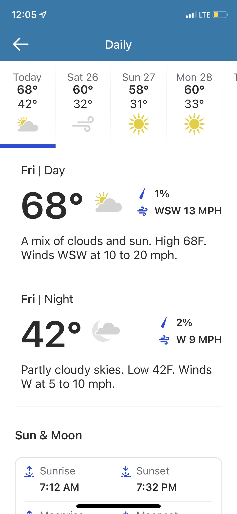

Went to the local outdoor range today. Nice weather, but windy. I had my Kestrel wind meter and at the bench it was between 2-6 mph, with an average at around 3 mph. I did deploy a near flag around 10 feet from my muzzle. Range'd my 30 yard target with my lazer range finder, and I was good to go.

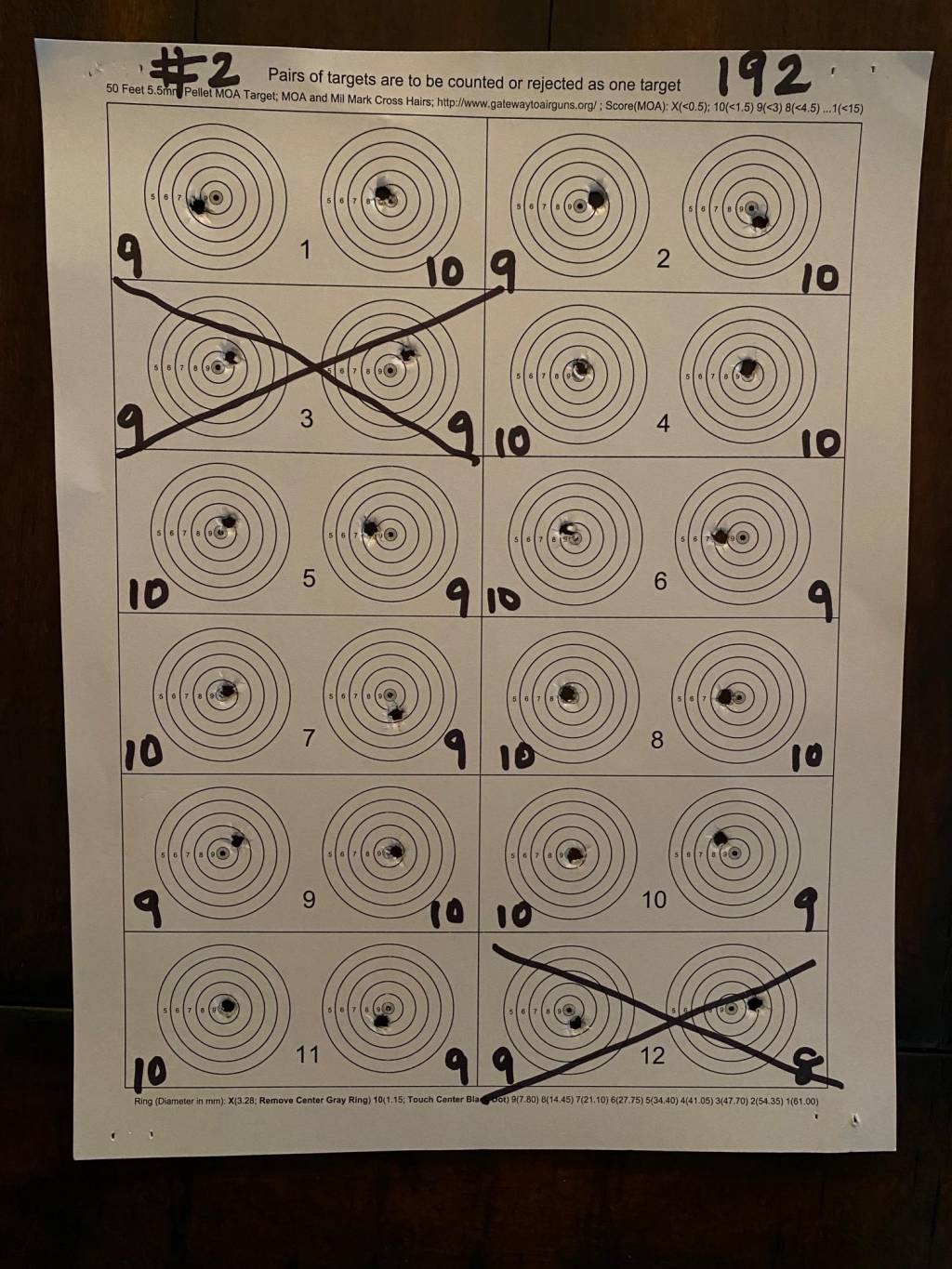

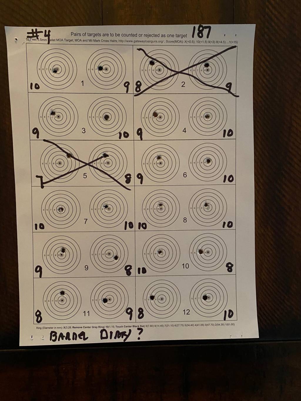

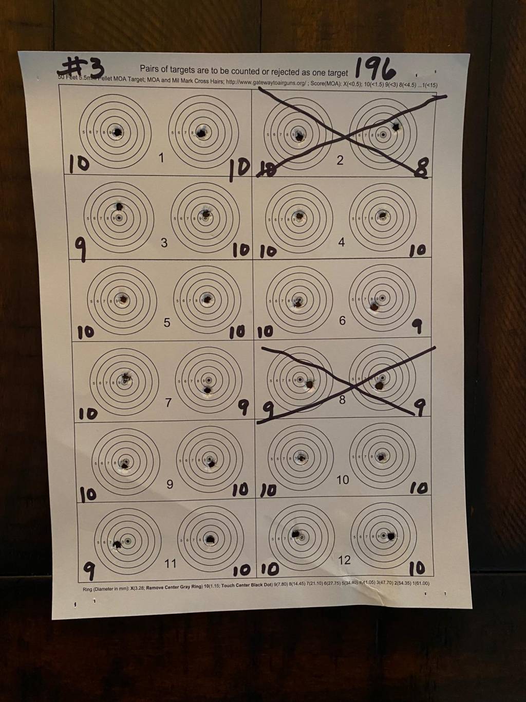

I shot four cards this morning, and I must say, it was a blast. ( 197, 192, 196 and 187 ). This is pretty challenging to say the least, if you are trying to hit twenty .129" ten rings. I zero'd in as best I could with the wind, and was on my way. Glad we can throw out four bulls out of the 24 bulls, and even with that it is a challenge.
My holds were on the nine ring mostly at 8am, 3pm, 12noon and 4pm - all dependent on wind shifts or my wind reading. Next time out, I would like to wait for a 0-1 mph wind time, but it's hard to get that outdoors in an open field.
