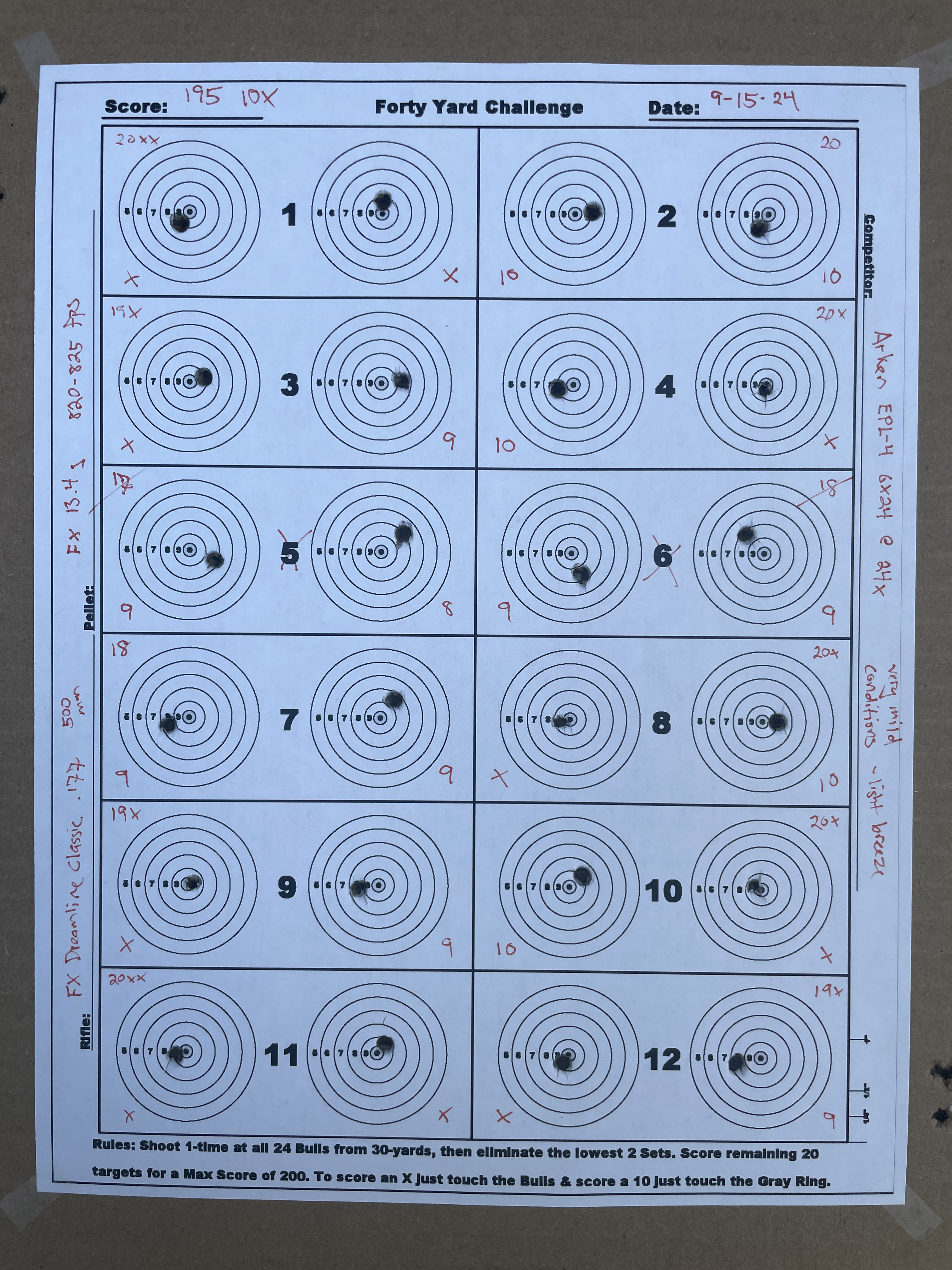

Very good wind conditions again today, so I followed up the 30-Masters of 198 and 197 yesterday with the FX Dreamline…
… with a 198 15X 30-Masters and 197 15X 30-Challenge (thought conditions were good for making a run at 200 with 30-Challenge). The 198 30-Masters was so close to perfect, wind increased and I missed 5b. Slight tailwind increase on 9b caused the other 9 - I should have adjusted after 9a went a bit high.
Dreamline was shooting so well at 820-825fps with the 13.4g that I pushed out to try a 40-Challenge - and shot a 195 10X that I’ll submit for our leaderboard. Its the highest 40 yard card I’ve ever shot with .177. (And with only 24x magnification)
I learned about keeping the speed below 840fps with the 13.4s here - from our data. I always shot them too fast in prior years and never had success with them until I lowered velocity.
To close out the day, I shot a 196 13X 40-Masters with the Crown .22 - using the new trigger / hold technique that I have been using with the Dreamline.
So all 4 cards 195+ today - I’m celebrating with bourbon, even though my Patriots lost a tough one.

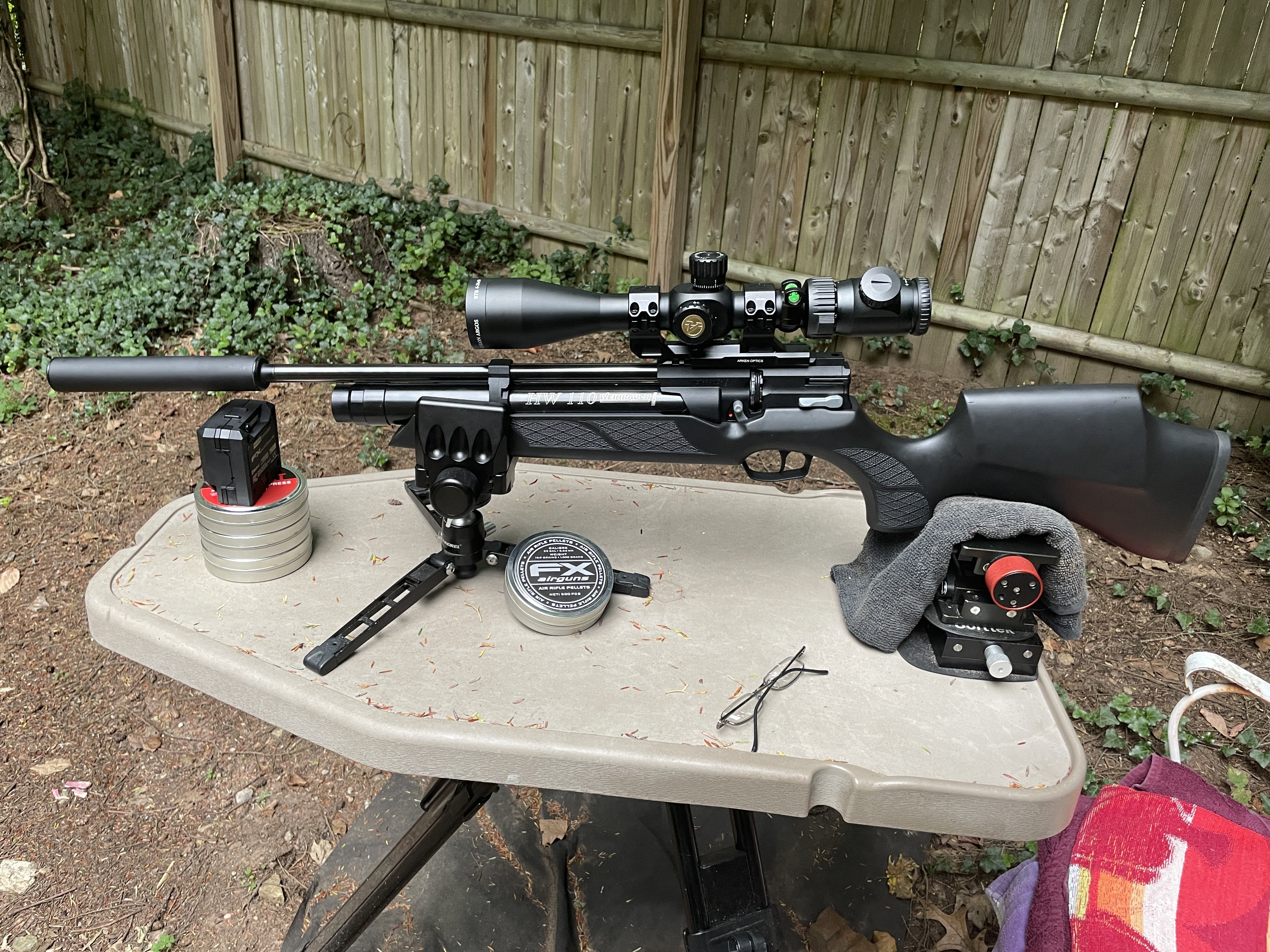

Not sure how this thread really works, but I thought I would give the 30yd target a try for the first time.

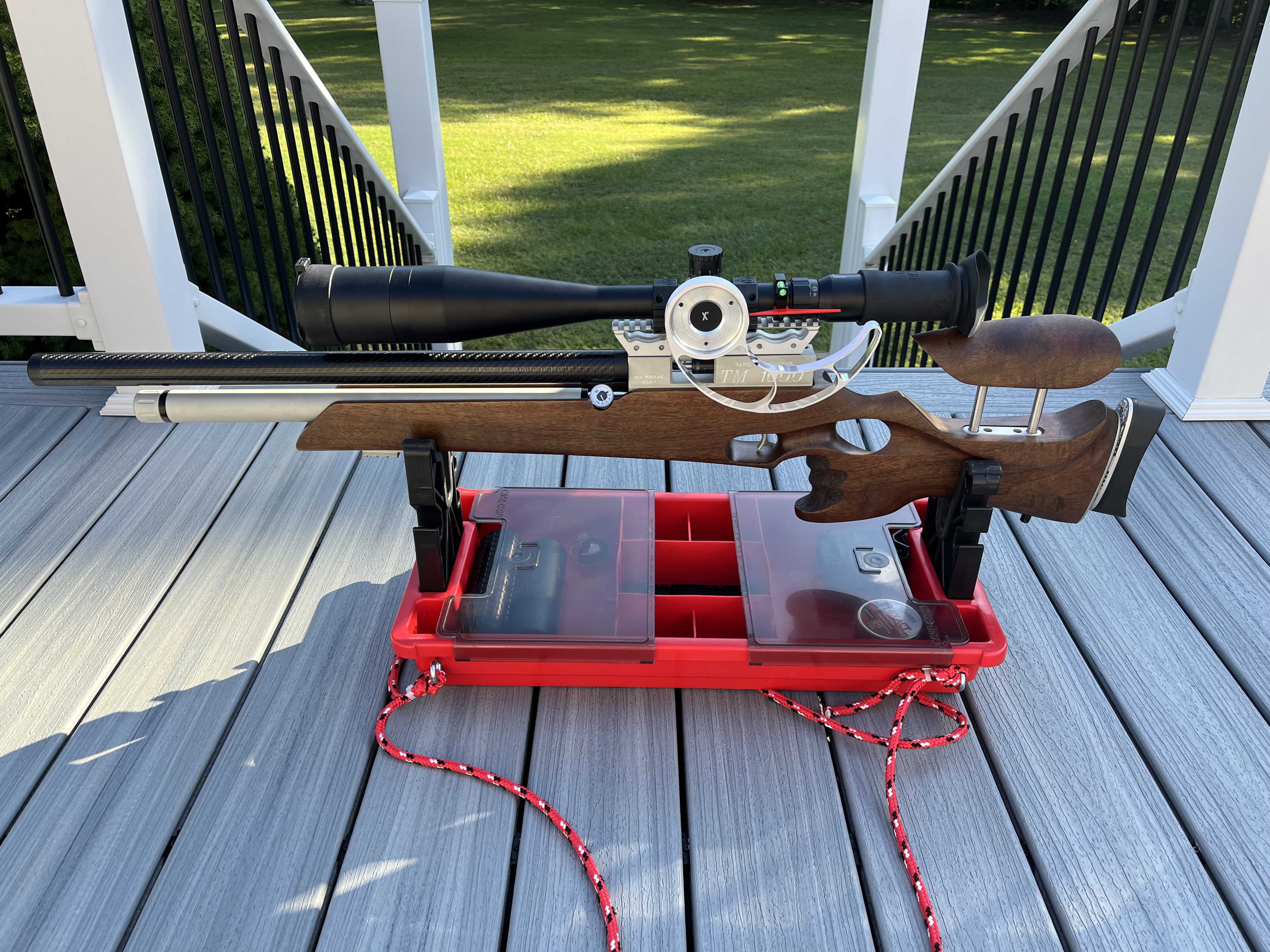

I finally have a 177 to shoot again. Just got my RAW TM1000 back from Motorhead and having him tune it up for me. I only shot some 10s, 13s, 13RDs a couple days ago to see what it likes now and decided to give the 13RDs a real try for the first time today.
Shot 3 cards. Trying to judge these 177s with 22 is really hard when it starts getting close to being an X. Wasn’t sure how you guys did that, and I didn’t want to shove the pellet all the way through.
199, 198, 196.

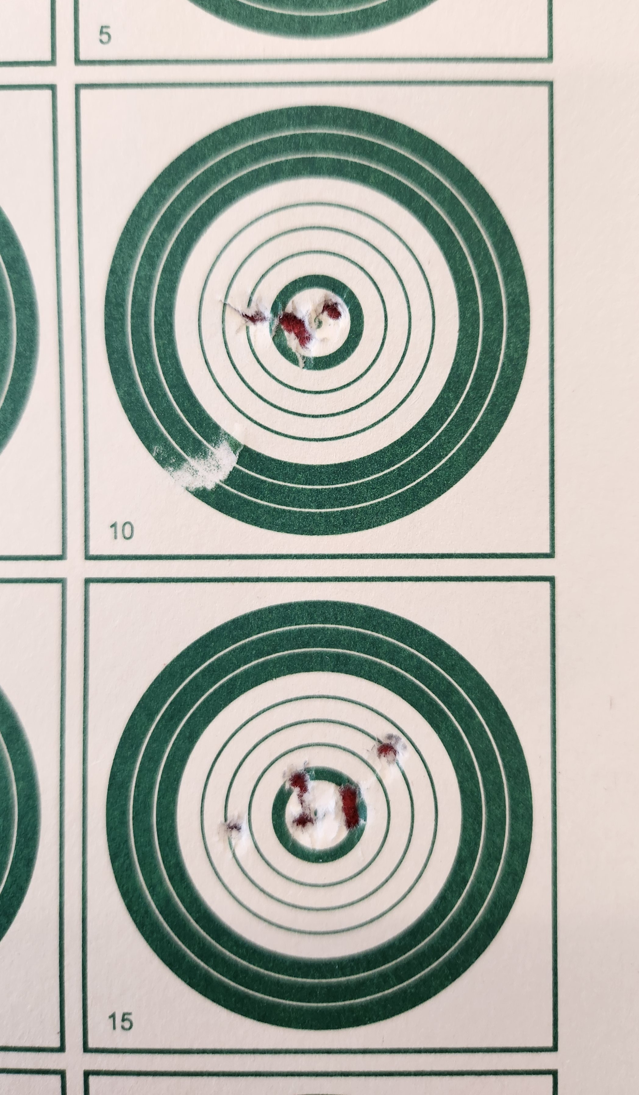

I forgot to mention it, but the wind was actually fairly calm. The app said it was up to 7mph, but down in my hole it wasn’t bad, mostly 3mph or less. Not enough to kill my scores.
The worst shots were straight flyers and a few times I accidentally pulled the trigger (it is light!) before I meant to, but luckily they were still close... closer than the 3 flyers. Card 2 had flyers on the bottom right two sections. Same distance off out of nowhere. Everything about those shots felt perfect like the others and then… what!!! not even any wind to account for them. Luckily they didn’t cost me.
One other odd thing, and I’m still learning with these pellets… the RDs are so much tighter going in. The 10s and old 13s slide right in the breech, but those RDs have to be almost forced in. But they seem to be slightly better. I’ll be curious to see if they stay on top after the sample size increases to more than 1 day. Ha!

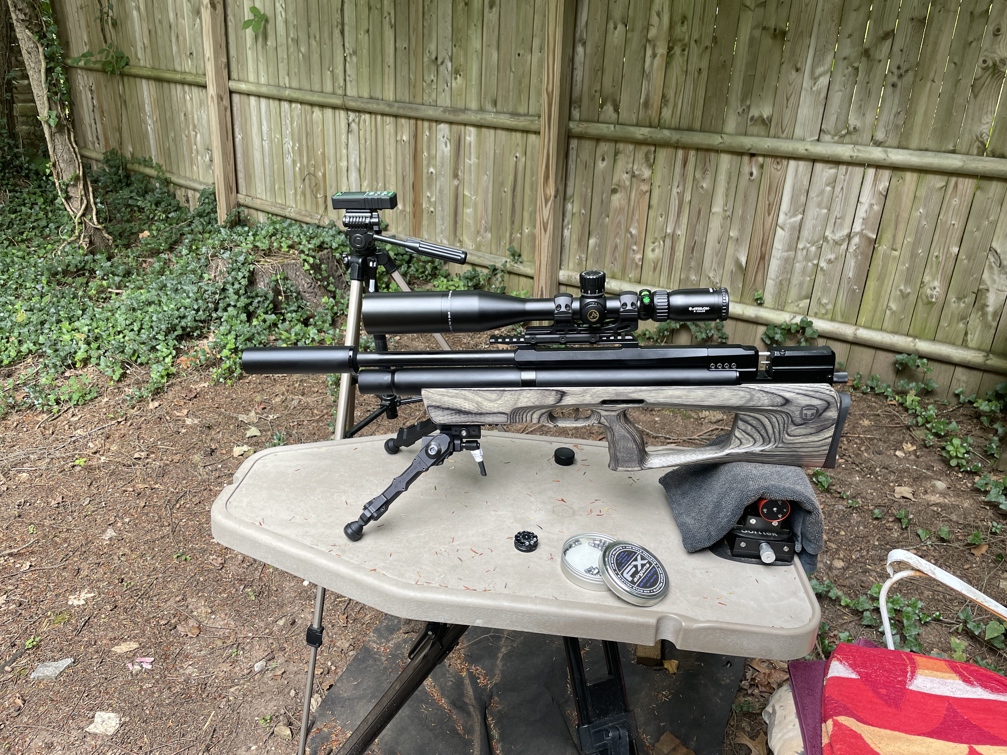

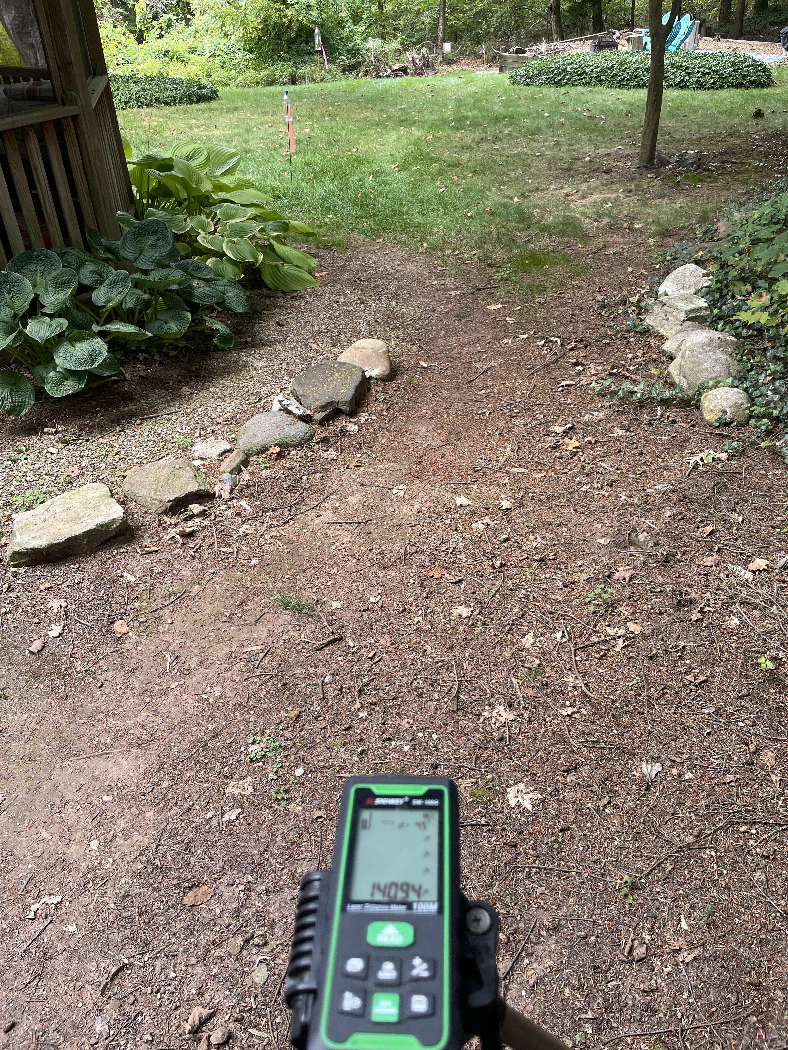

Channeling my own “Ricky the Airgunnero”, I shot a card at lunch - pushing our Challenge target out further than 40 yards.
Shooting conditions were nice - overcast with mild breeze. I shot rows from top to bottom. You can see the mild breeze R to L picked up on rows 2,3 and 4 - pushing my PoI left.
I took 3 sighters during the card. Without the sighters I would definitely have shot a lower score. Incidentally, my two sighters before Row 4 went through the same hole - would have been Xs, lol.
Distance: 47 Yards (laser measured from front of bench)
Rifle: Taipan Veteran 2 .22 (550mm CZ)
Pellet: FX 25.4g (MRD)
Wind: 2-4 mph
Scope: Athlon Midas Tac FFP 6x24 @ 24X
Score: 191 10X
Dang!! Didn’t think I would break 190 at my first try past 45 yards. This Taipan Vet 2 is amazing at holding accuracy further out - using the heavyweight 25.4g pellets.
I’m certain a 45X Sightron and some practice at this distance and I could beat 191.
Now maybe I should try the FX Crown at this distance…
(I’d put target at exactly 50 yards but its too swampy - 49.3 yards and I start to get wet feet, lol)

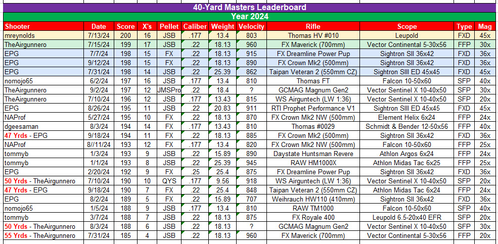

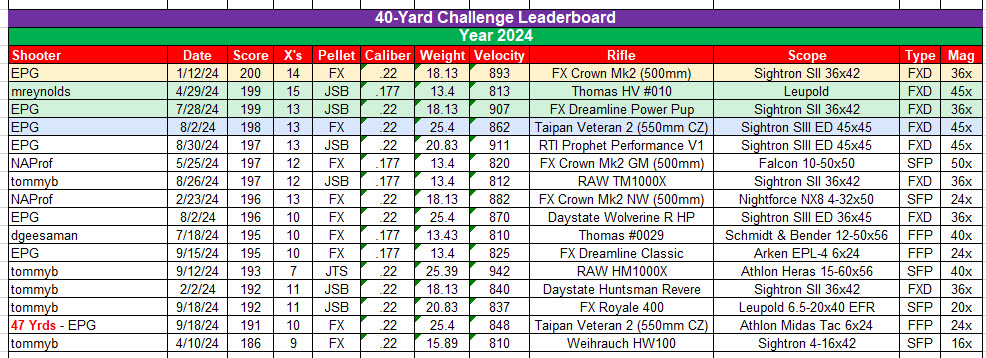

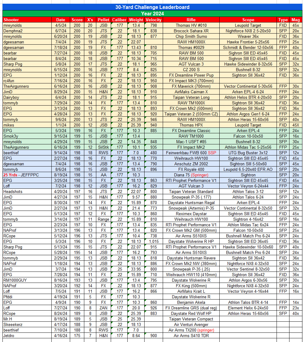

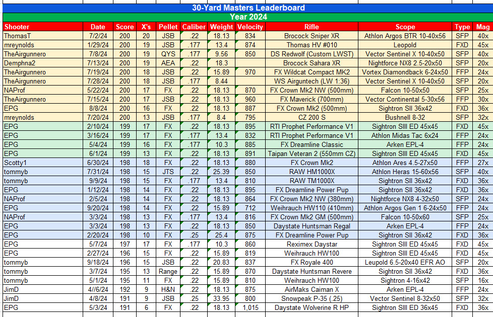

Leaderboard Update - through September 21, 2024
Challenge Shooters,
Despite getting late in the year, you continue to impress with new Leaderboard submissions!
Notables for Aug/Sept:
200s:
EPG shot 200 16X 30-Masters with his FX Crown – his 1st ever 200 Masters score (post# 2610)
JimD shot 200 15X 30-Challenge with his AirMaks Caiman X (post# 2680)
TommyB shot 200 13X 30-Challenge with his RAW HM1000X (post# 2696)
Great Scores:
Smok3y shot 199 15X 30-Challenge with his RAW TM1000 (post# 2722)
Beerthief shot 198 18X (!) 30-Challenge with his Feinwerkbau FWB 600 single stroke pneumatic (post# 2719)
JEFFPPC shot 198 15X at 25 yards with his Diana 75 springer !! (post# 2654)
TommyB shot 197 12X 40-Challenge with his RAW TM1000X – that’s a 197 at 40 yards with a .177 (post# 2678)
EPG shot 194 11X 47-Masters with his FX Crown – taking our card out to 47 yards !! (post# 2736)
Welcome:
Welcome to our new shooters Smok3y, RM1000GUY, JEFFPPC and Mr.H - keep those submissions coming.
Ok, you’ve spent enough time admiring yourselves on these leaderboards – now GET SOME LEAD DOWNRANGE !!

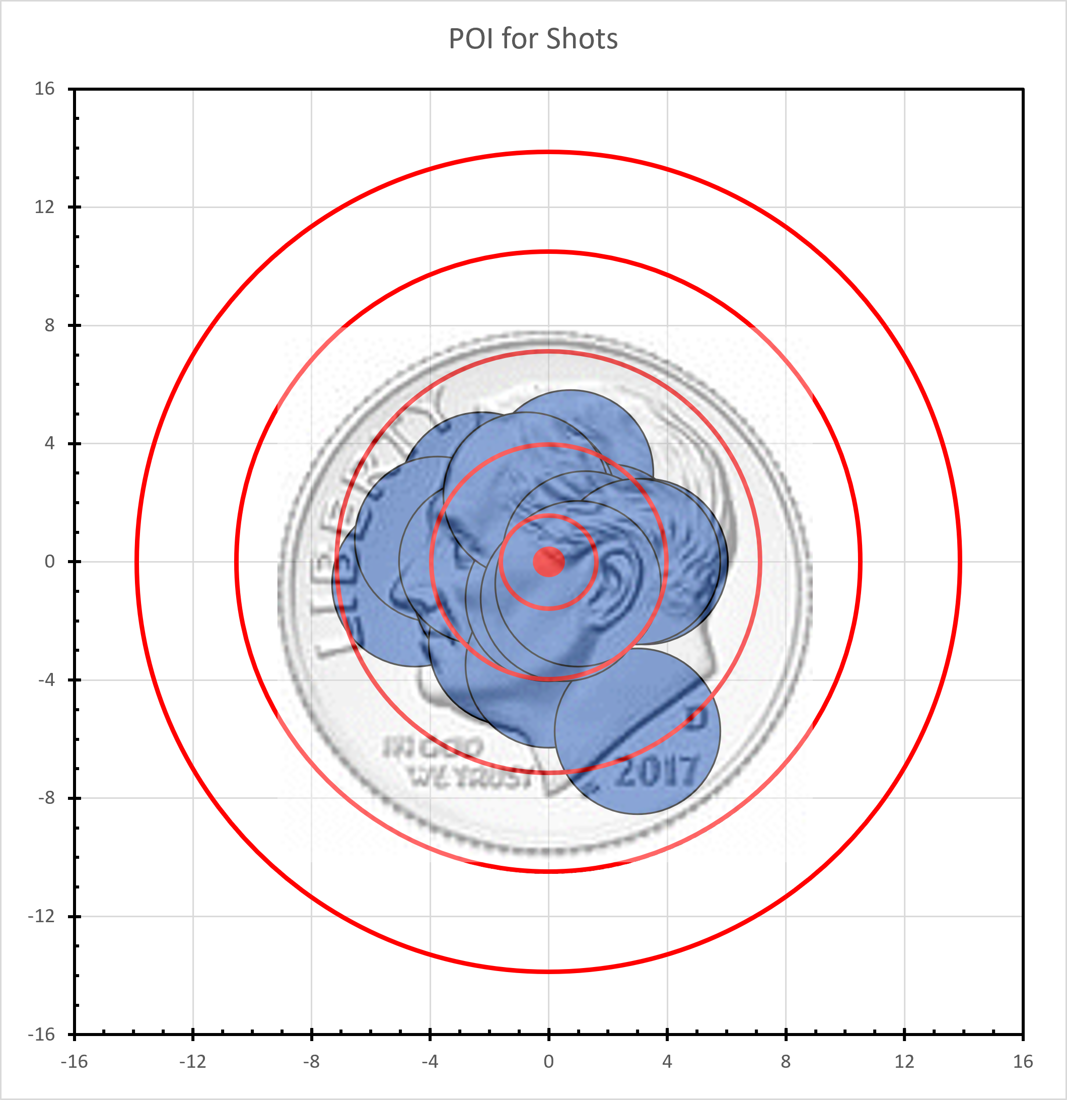

Hi Guys!
It has been a while since I shot any Challenge cards as I have been concentrating on Field Target. I have done pretty well there this year (and I say shooting these targets has helped me), but my wind calls need work. So today is kind of blustery with 6-8 mph winds with gusts to 13mph. A great chance to work on wind calls.
Here is the best 30yd Challenge I have shot this year. A 198-16x. I was holding between about .5 to 1.25 MOA left and just a hair up depending on how the wind felt. More wind more left and up. The first 4 targets on the card were kind of rough, and then I got in a groove.
To give you and idea of how the wind was affecting the pellets I want to show my setup. I tape the Challenge cards to an 14x17 IBS 50yd target and then hang that on my stand (see 2nd picture below for typical setup). This gives me a bunch of bulls to use for sighters. The third picture below shows a closeup
of two bulls where I shot groups with a constant hold while I was trying to figure out the wind. Note the X-dot is the same size as on the challenge targets.
The final picture is my plot of the 20 shots that counted on a single bull to get a physical image of how tight the group needs to be to score high in this challange.
