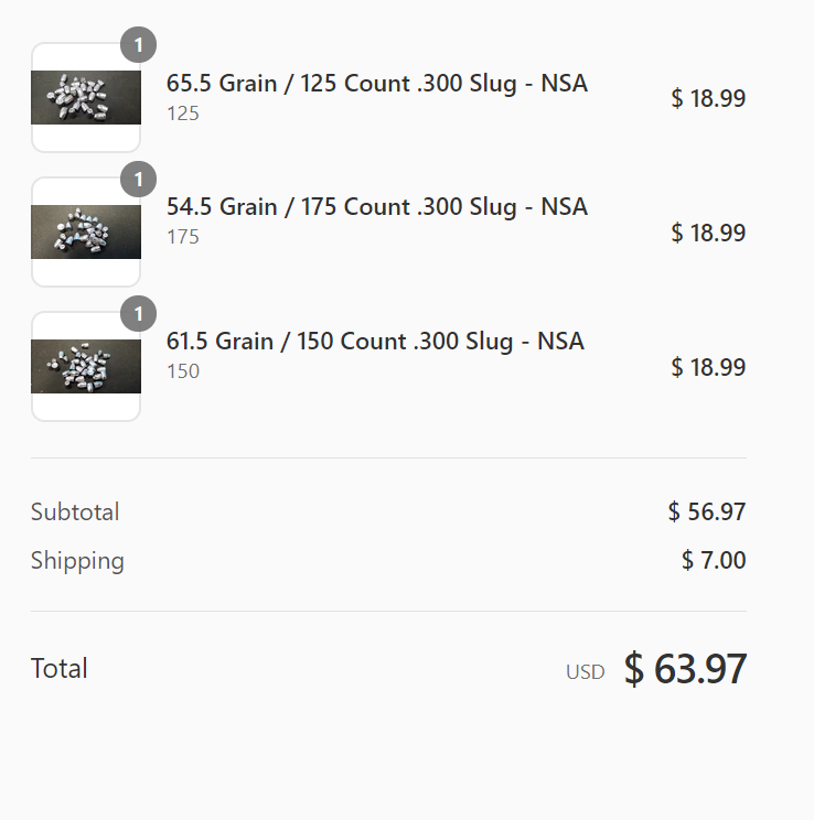

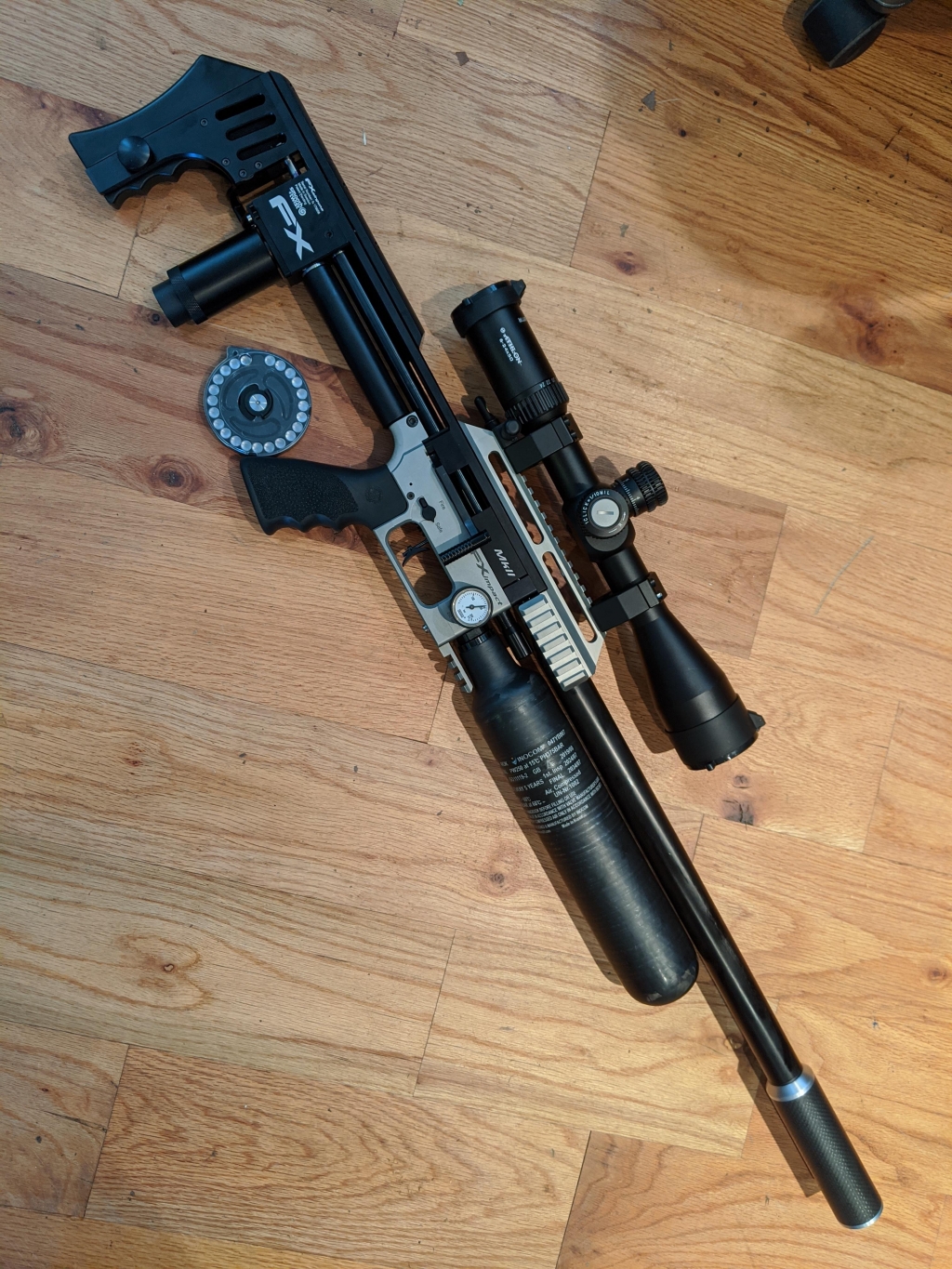

I have finally found enough stores to shop at so I can get a 580cc bottle, 700mm barrel and a slug liner. Finally all of them are in stock and on the way to upgrade Thumper
Thumper has enough air 'n flow to toss a 44.75gr JSB at 1000fps w/ the reg set at 155b and power wheel on max.
I had to turn it way down to get any accuracy from the JSB beyond 50yds. This is 5 shots at 85yds and 110b w/ an 880fps.
But now I'm moving into slugs and another 100mm of barrel.
Wondering if I could get some advise from you folks that have already been here what slugs I should order up and what speeds I should set the gun to for best accuracy.
Thanks in advance.

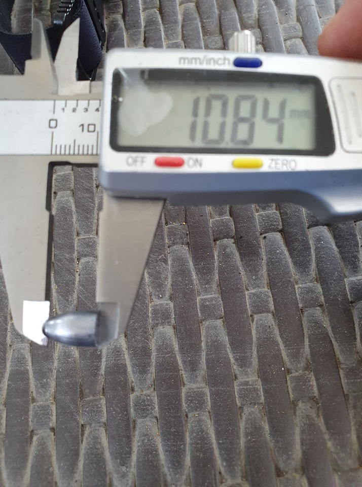

The old 66gn fits ok in the High Capacity Mag .30 100% sure, measuring 0.426 or 10.86mm, so less than that will fit for sure. (I do not have a special mag jaja)

Alright, I think I got the barrel sorted out. Pretty easy once you find the right video...
I set it up w/ chrony and a 75yd target. Hit the trap on the first shot. Yeah!
W/ the 65.5gr I got it up to 850fps & 150b on the reg. W/ the 61.5gr it's at 900fps w/ 140b on the reg. 110fpe. Honestly, I thought the gun had more ass than that.
Looking at the pellet probe, it's not quite all the way into my mark from when I timed it. I think I need to pull the probe out and examine it w/ this barrel and see if it's timed perfectly, then re-time it.
It's too darn cold out there to be fiddling for too long, ran a couple mags of each and had to go inside and warm up. I think I'm on a good track here, but it needs a LOT more tuning

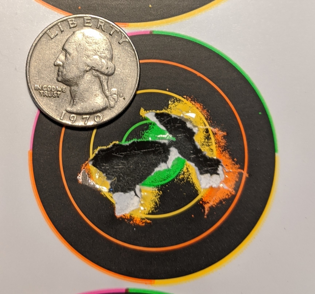

Now that I've timed the probe to barrel better, I'm shooting a 61.5 gr at 930fps on 150b with some dime sized 5 shot groups at 85yds. And it's a windy day too. These slugs seem to buck the wind better than the pellets.
My only downside is that I fill with a scuba tank, so even on a fresh tank I just barely get 250b, I'm down to 200b on the tank now.
Looks like if I could get a full fill, I could run a complete mag at these power levels, as it is, I'm getting 2/3s or 3/4s the way thru it.
Have to tell myself to stop buying stuff and get a CF tank. That darn Great White is calling me...
