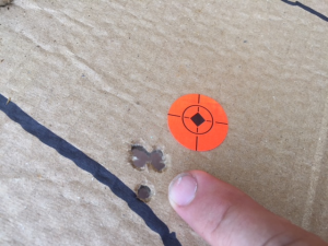

It’s not an expensive gun, but a Evanix rainstorm.30 has a 1-26 twist barrel and is superbly accurate with both pellets and slugs. That’s 7 shots with 55 grain Nielsen @50 yards @ 860fps. And that flier was definitely me.
