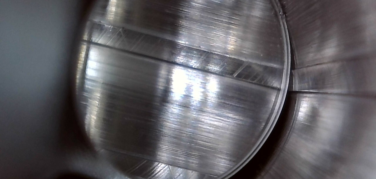

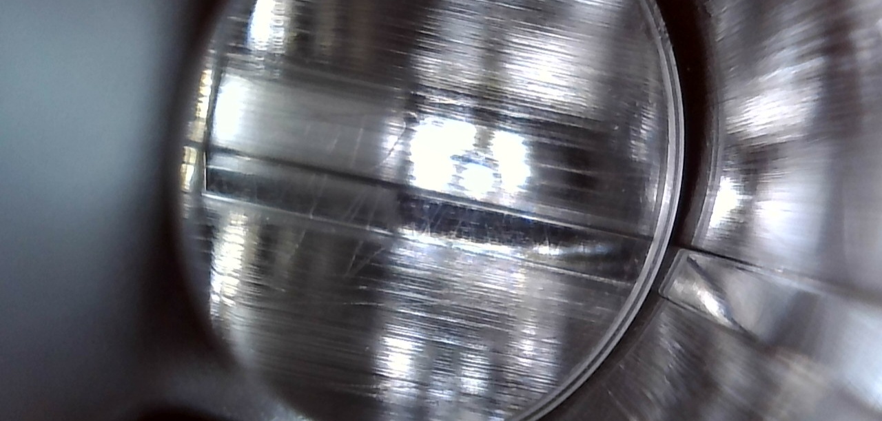

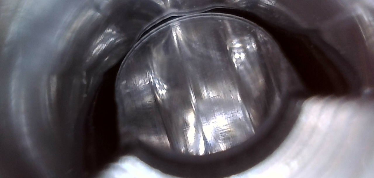

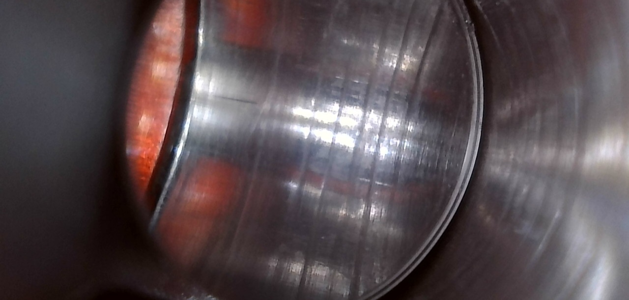

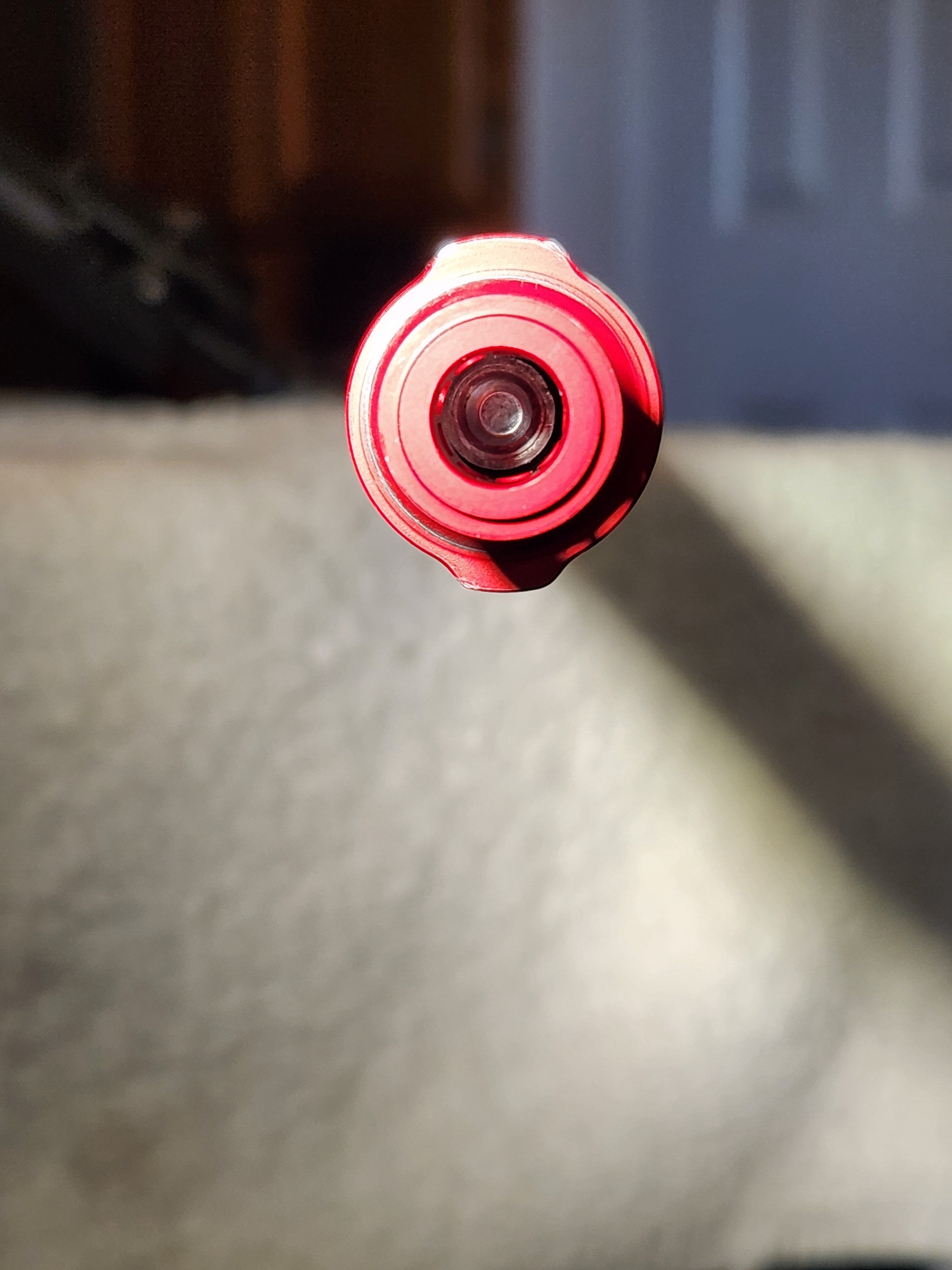

Here's mine with the borescope (just got the borescope today, so working on figuring out the focus).:

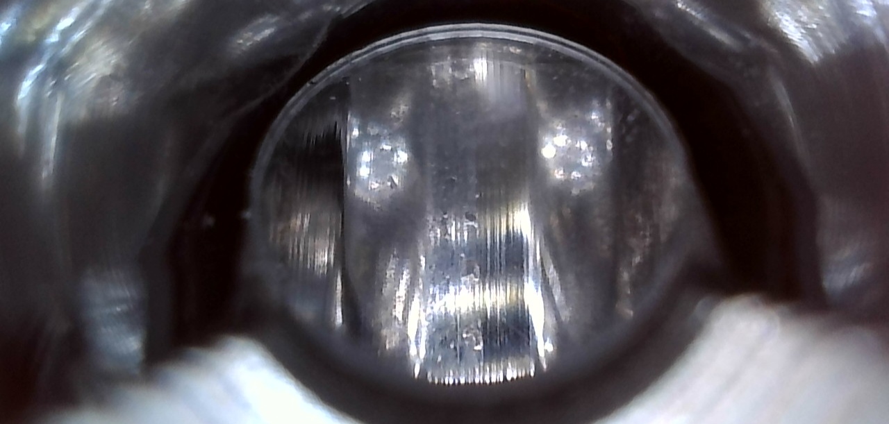

Ring gouges in throat/leade that I polished quite a bit already.

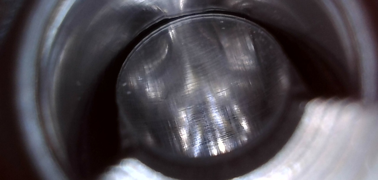

Polished bore in rear. Note the highly polished is the land, the groves are pretty rough even after polishing.
Crown - yes it looks off center and uneven.
Some cross-scratches on the lands.
Fortunately, there did not seem to be any scratches or rough patches near the front end that would account for the "tight" area. That would suggest a choke was added.

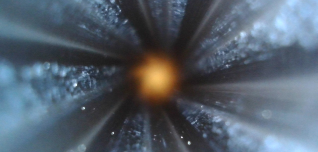

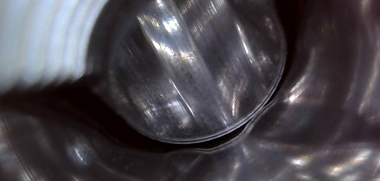

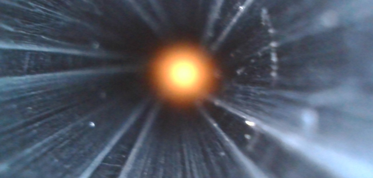

View down the bore:

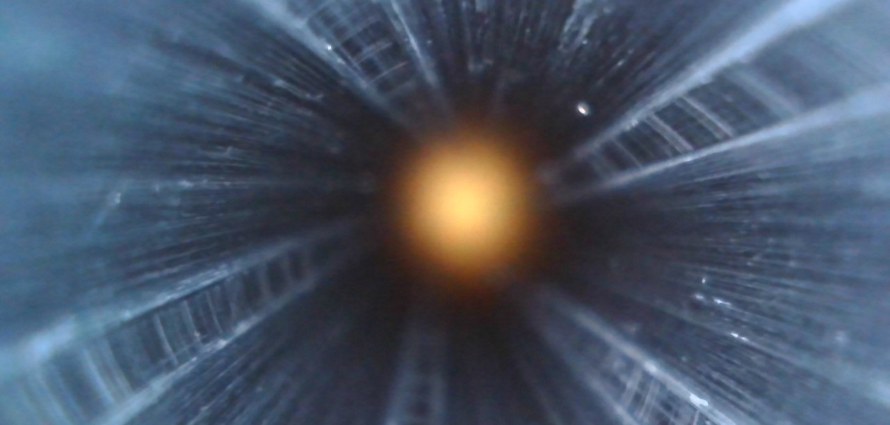

For comparison, here is the 22 L-W Skout barrel - I only ran a dry patch after shooting 2-3 tins. Sorry for the focus issues - the borescope has a learning process.
Throat/leade
Polished rear end (the roughness on the bottom/right is the borescope mirror setup).
Ring gouges in throat/leade that I polished quite a bit already.View attachment 511923
View down the bore:
View attachment 511928View attachment 511929
Throat/leade
Starting to see some leading
More leading
Look down the barrel with quite a bit of lead.
Damn, those cross scratches look pretty deep. Have you tried pushing a pellet through after polishing?
Reactions: MSR Workshop
You probably won't see the cross scratches with a pellet push. The longitudinal ones show up as scoring lines on the pellets. I don't think that it's going to get any better. I will have to relook at the crown to see if anything can be done for it. The ring gouges are pretty smooth now, so the pellet pushes in ok.
After a very deep cleaning with patches wet with Ballistol, followed by dry patches, I had very good results polishing with JB Bore cleaning compound, wet with Kroil penetrating oil. I used the felt cleaning pellets on the 3-pellet threaded adapter for a Dewey rod from Browning (even though the pellets deform and thin on the threads and the adapter only holds two pellets). After that cleaning/polishing, I repeated the same process using JB Bore Bright. This did not totally remove all tooling marks like a professional lead lapping or the like probably would have, but it really smoothed the bore out and polished it to a very good finish.
I don't think anything is going to fix the accuracy of that barrel with the terrible crown until it's re-crowned. They say the crown is the single most important contributor to accuracy as it has the final effect on the pellet as it leaves the barrel, and that crown has to be applying some wonky influence.

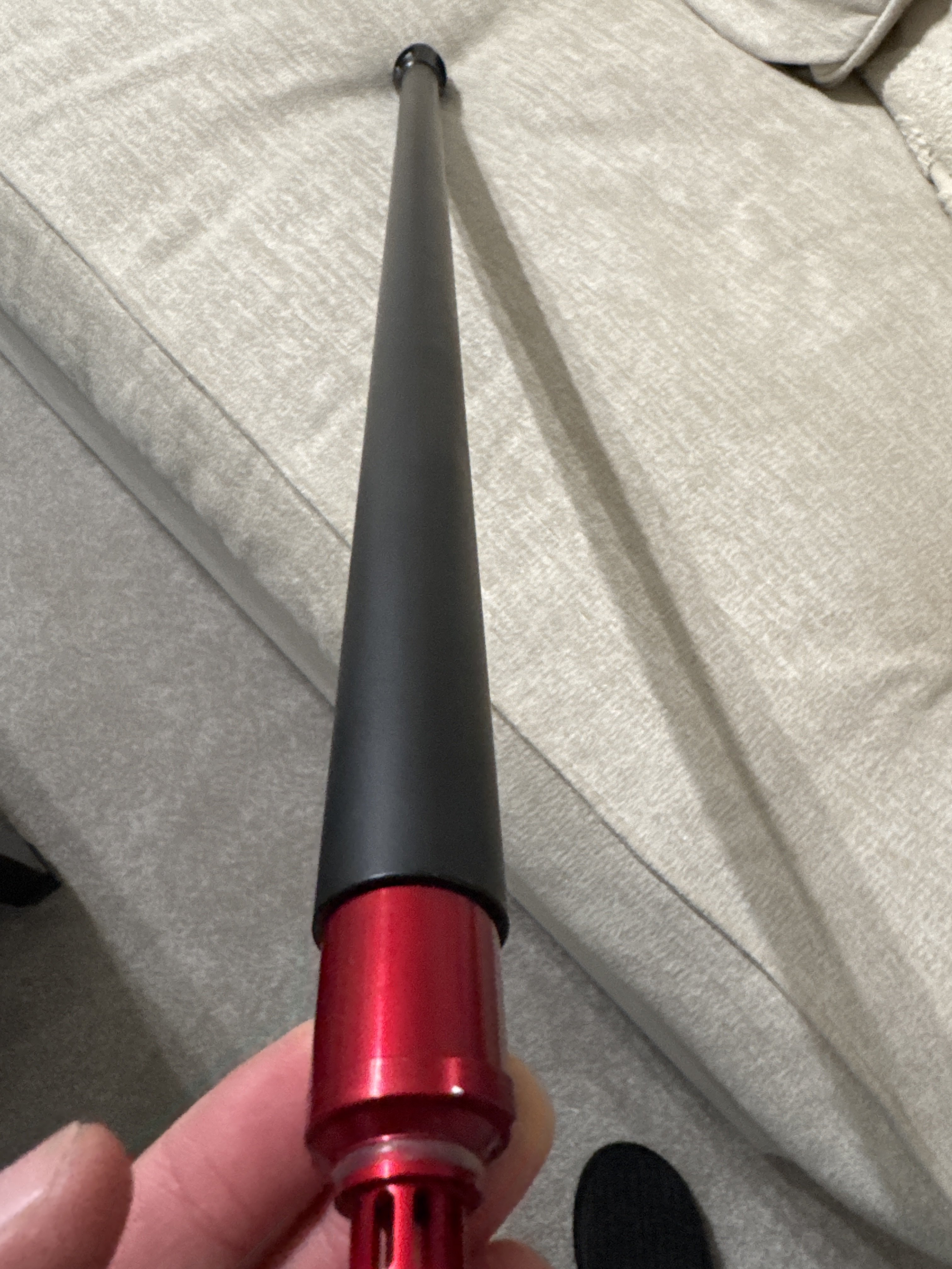

Got my SubMoa barrel delivered yesterday evening, and so far I’ve been very impressed with a fit and finish. I was not expecting it to be in a black finish, which was a nice surprise. It seems like all the Sub-MOA barrels I have seen have been in the natural bare metal finish. Initially, I was worried I was going to have to worry about rust and fingerprints because it’s not stainless steel., so I was going to wrap the barrel. But this black finish they put on. It is fantastic.
As far as how it shoots, I have no idea yet because I’m waiting for the moderator to show up so I don’t get a visit from the cops.

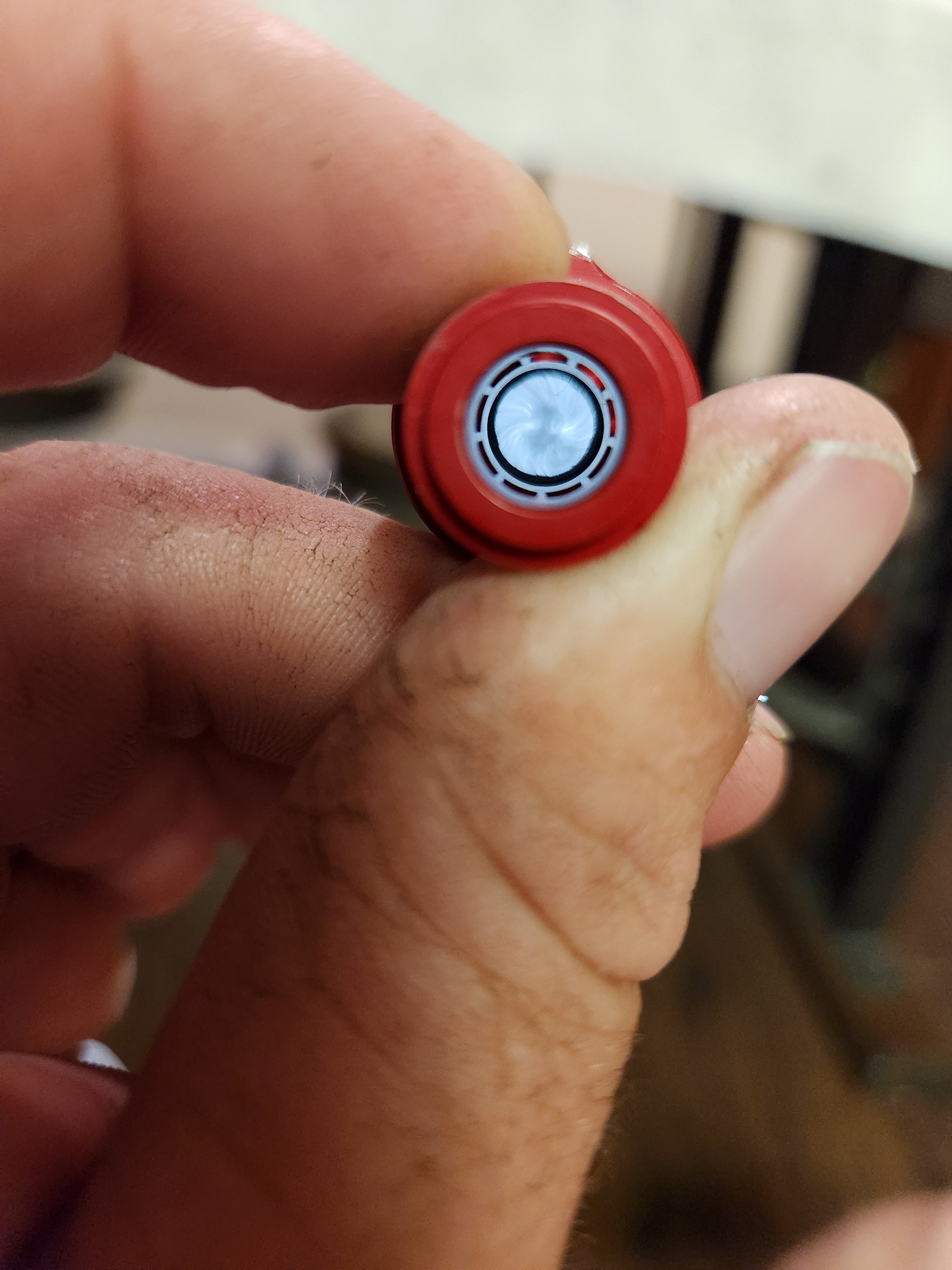

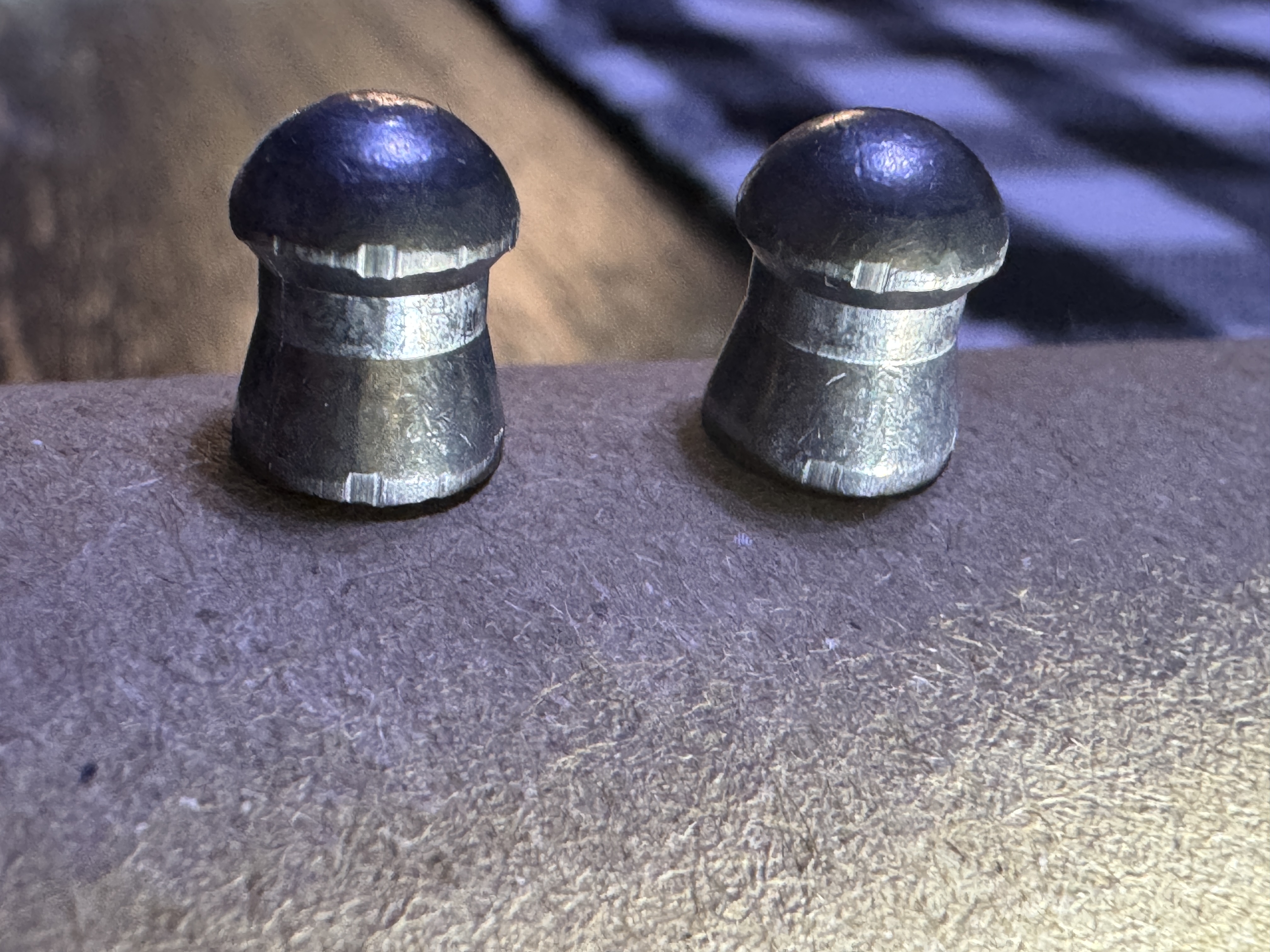

I pushed a couple pellets through with a cleaning rod that I could find, and they seemed fine to me. I didn’t notice any excessive “chew” marks from the rifling. So next is to see how it shoots.
I don’t have a borescope, but looking down the barrel with the flashlight in my iPhone zoomed in as much as possible the finish looks like a beautifully mirrored rifle barrel should.

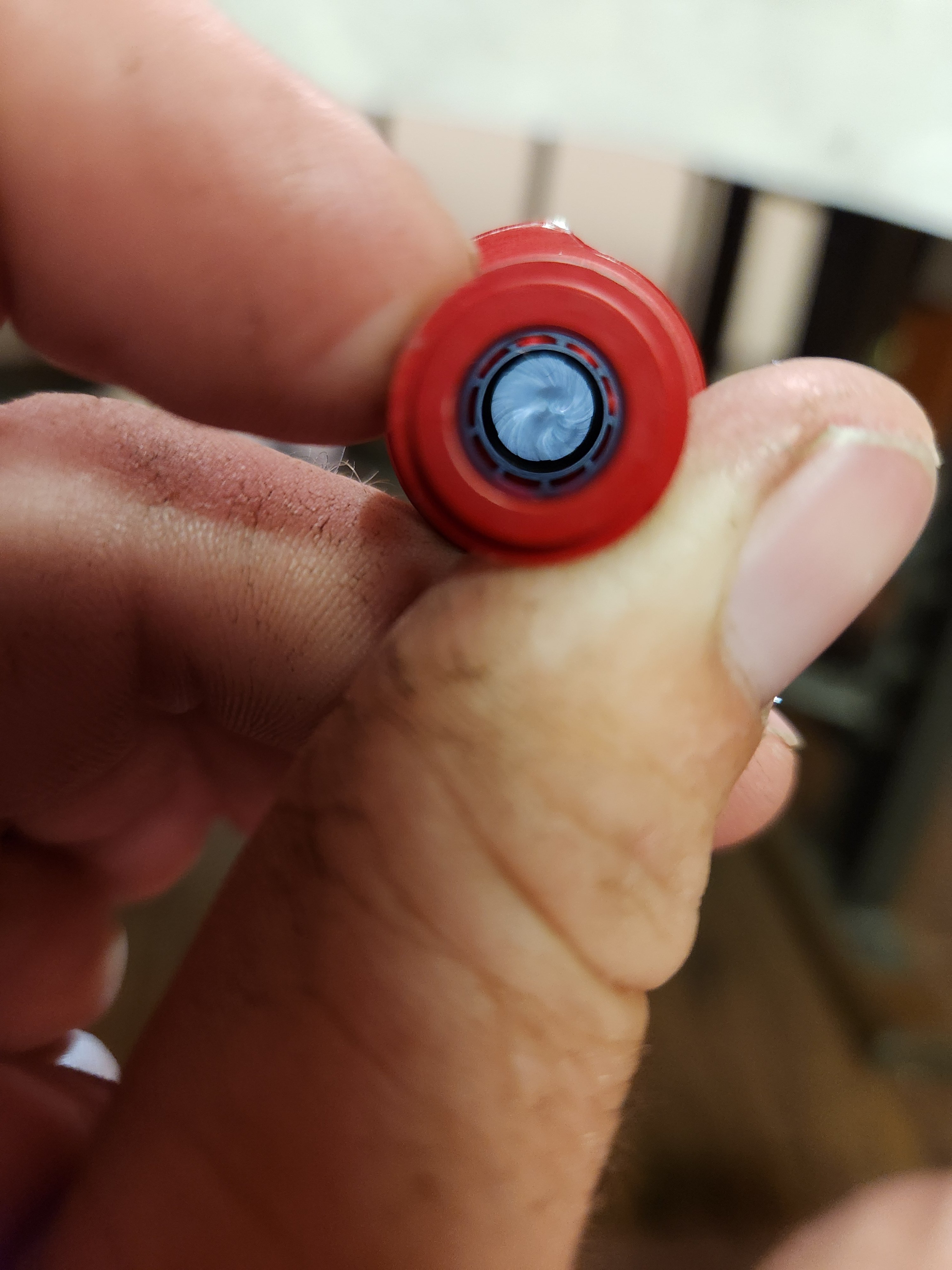

Here a couple pictures I of the pellets that I pushed through.
So far, I think it looks pretty great to my eyes. But accuracy is the most important part. All report back as soon as I get everything installed and get about 100 rounds through it.
