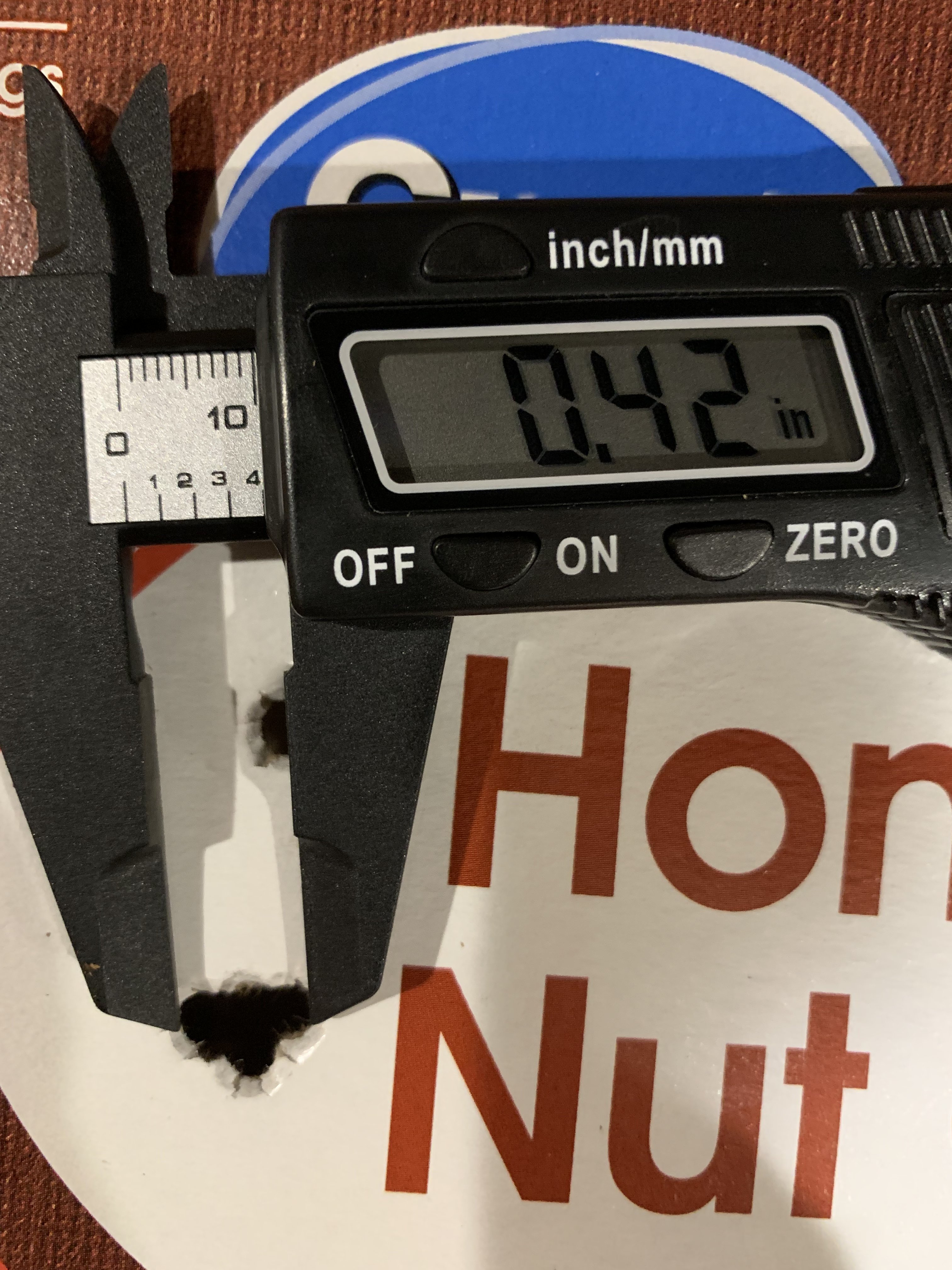

For reference this may be my best 5 shot group with the 80 grain slugs.
Reactions: qball

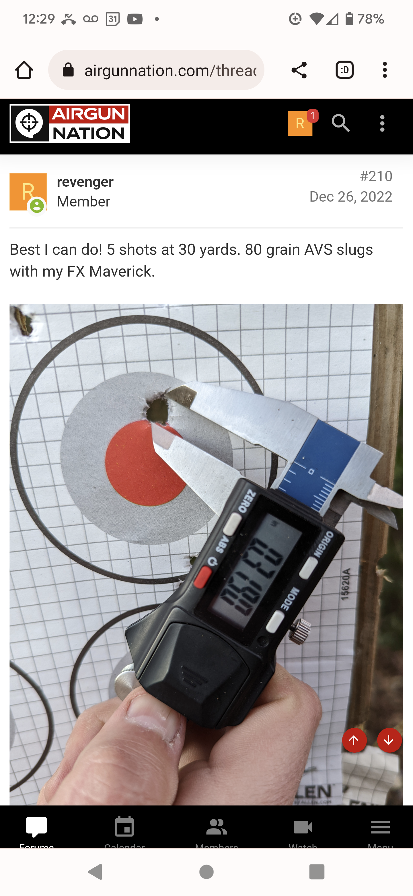

I normally measure group size center to center and that group would be 0.15 if measured C2C!
Yes basically lol. I posted it on the one hole group challenge. Believe this was at near 150 FPE. Maybe not as high as I have reached yet but the potential is there. So sub moa groups are possible at high power but it may be a projectile lottery.
Reactions: qball
Clearly, 1/2 MOA at 150 FPE is achievable!
I could just be lucky as well who knows. Clover leaf type groups are super common at 50 yards too. But I have an odd approach to "Tuning". I try to find the gun's absolute limit for power and then fit the right projectile to that level. I do the same thing with my Avenger also.
