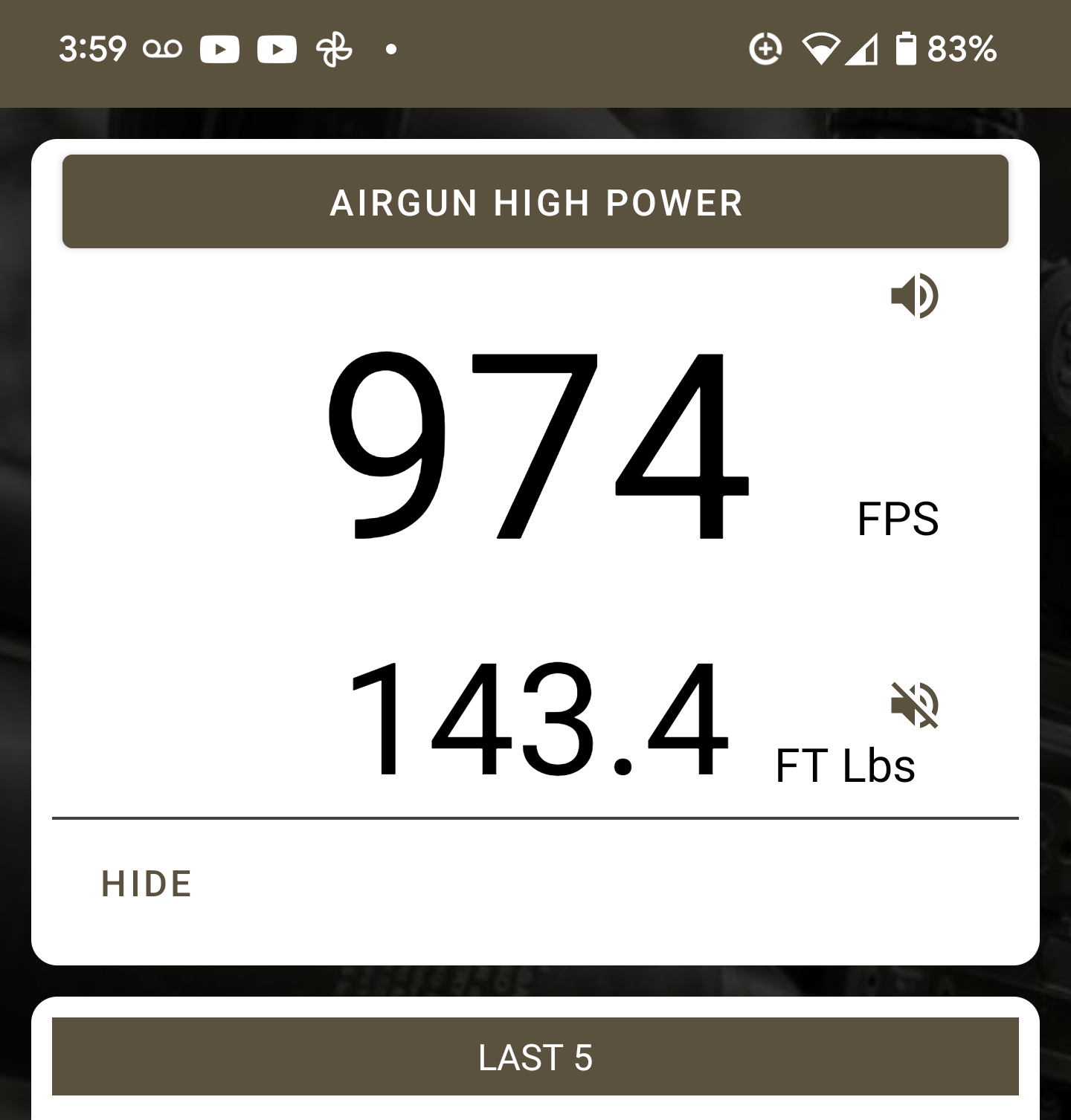

Been doing some mods to my .30 Maverick with 700mm heavy liner in my quest for 150 FPE. I'm starting to get closer and closer. Current mods are Huma dual transfer port, Huma pin probe, Huma 57mm spring, 26 gram tungsten hammer, 300 bar bottle, Huma high pressure regulator up front with the rear one currently bypassed. Reg pressure around 200 bar but will know for sure when my digital gauge gets here. My next mod for power will be completely deleting the bag regulator and installing another plenum piece for around a 160cc plenum. No plans for internal work yet but we will see. Shooting 68 grains ZAN slugs over 970 FPS without much fine tuning. Definitely think some 70+ grain slugs will be ideal for max power.

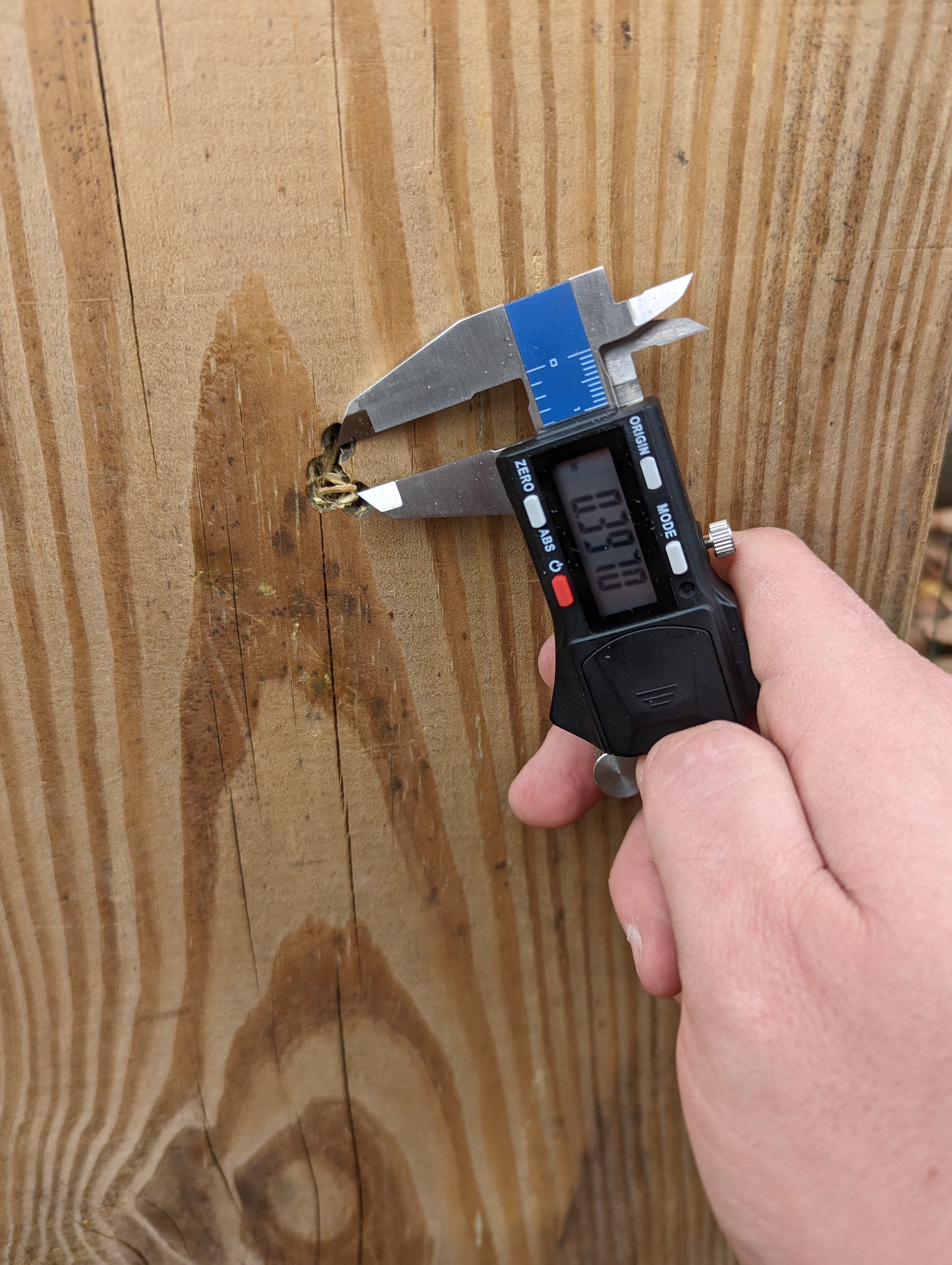

Not a ton of groups as of yet. Havent really tried to get great groups. However first time shooting the 72 grain Griffin slugs this morning I did this... 35 yards just picking a spot out of the 2x12 to shoot at.

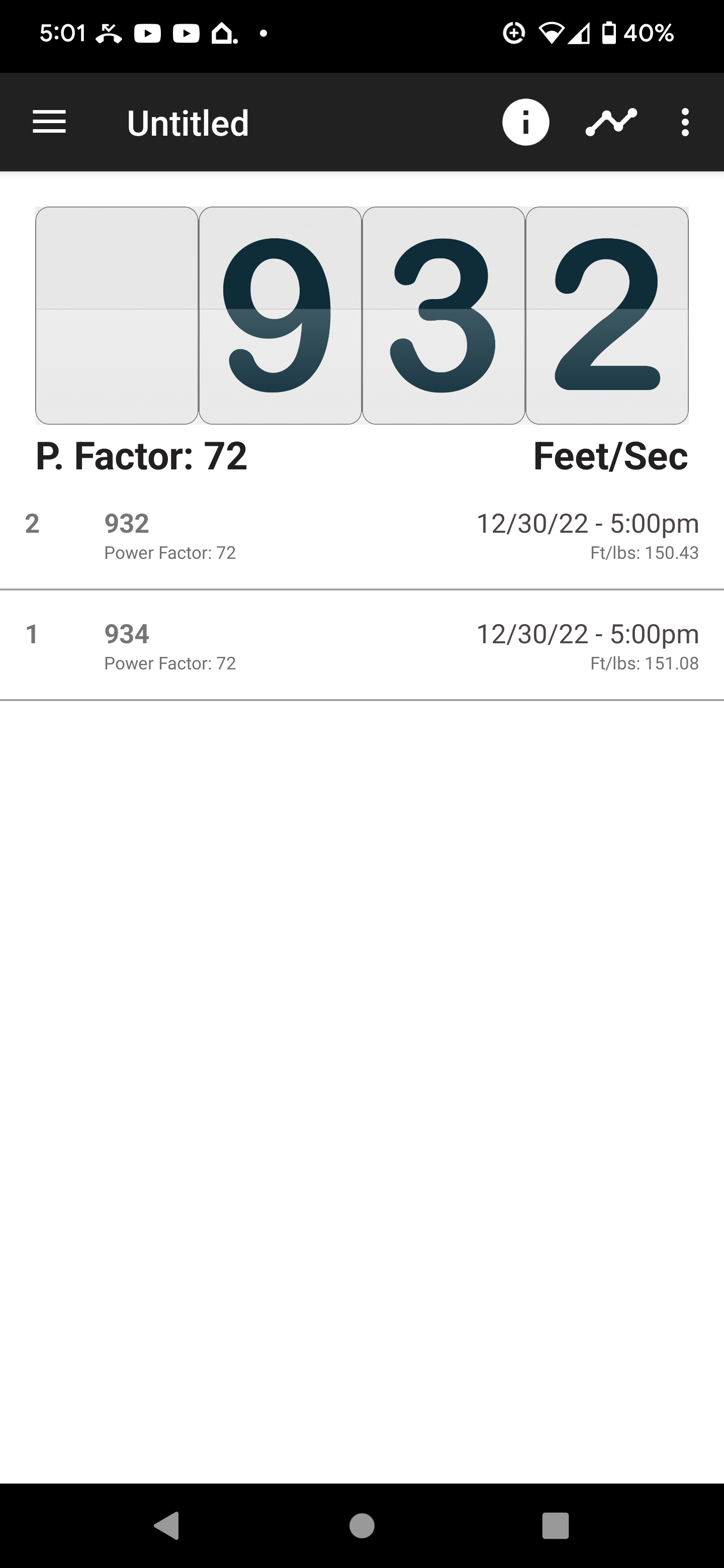

You're doing very well though. I'm slowly working my way up on the vulcan 3 getting 135fpe around 170 bar with a 70gn avs at 932. The control board for the electronic lead screw on my lathe failed but I've got a new one on the way so I can continue making parts to experiment with. I've been putting the lathe repair off for months now but it's time to stop procrastinating and get to work.

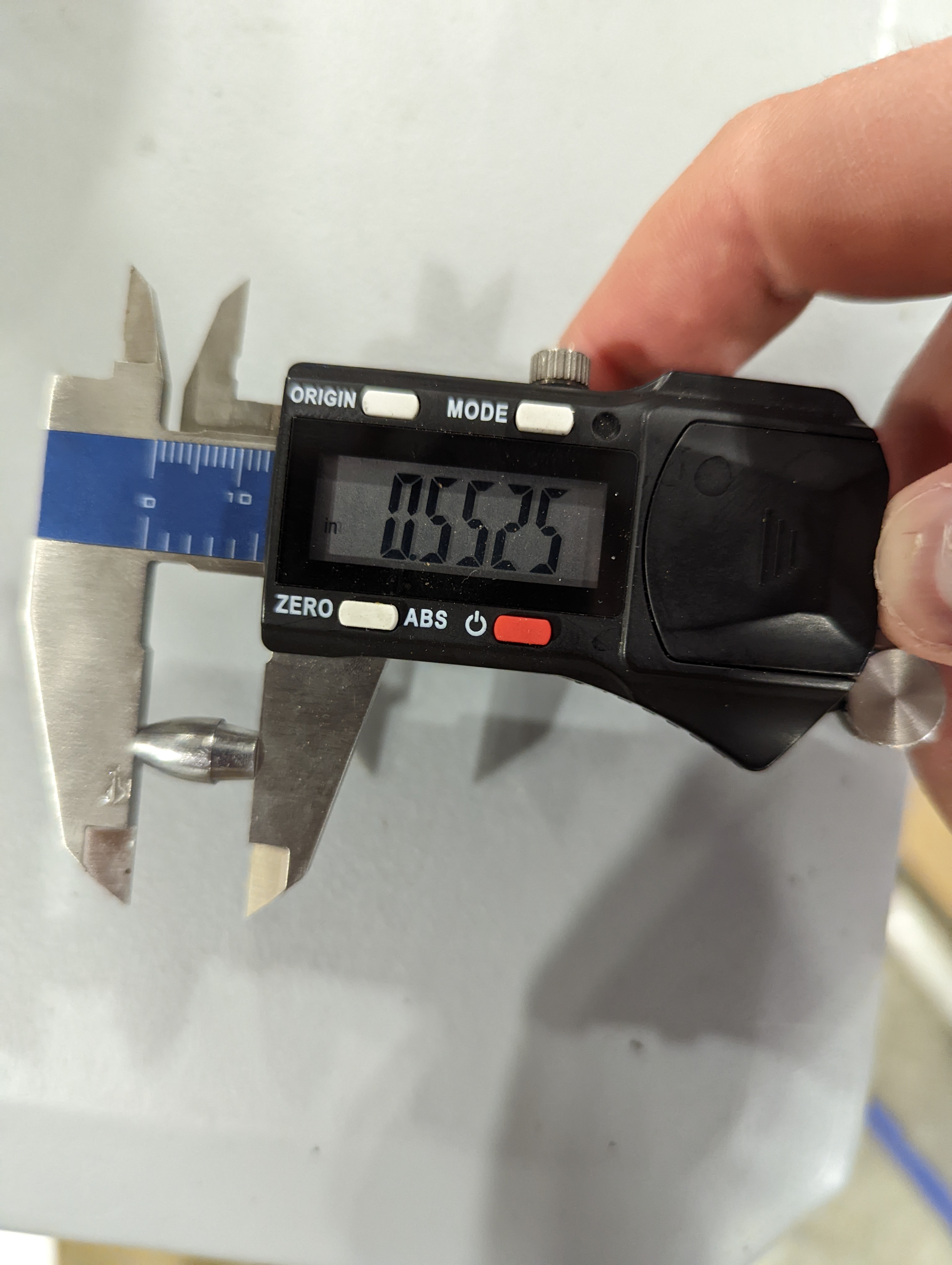

How long are the 78 grain boat tail slugs from Griffin ?
I need to go measure them.. they are long enough that they don't even fit into my single loader. I have to remove that too and then literally put it in by hand. I have some good ideas for a gravity fed magazine that would be able to feed the longest of slugs but would need the help of someone with the skills on a 3d printer or something.
