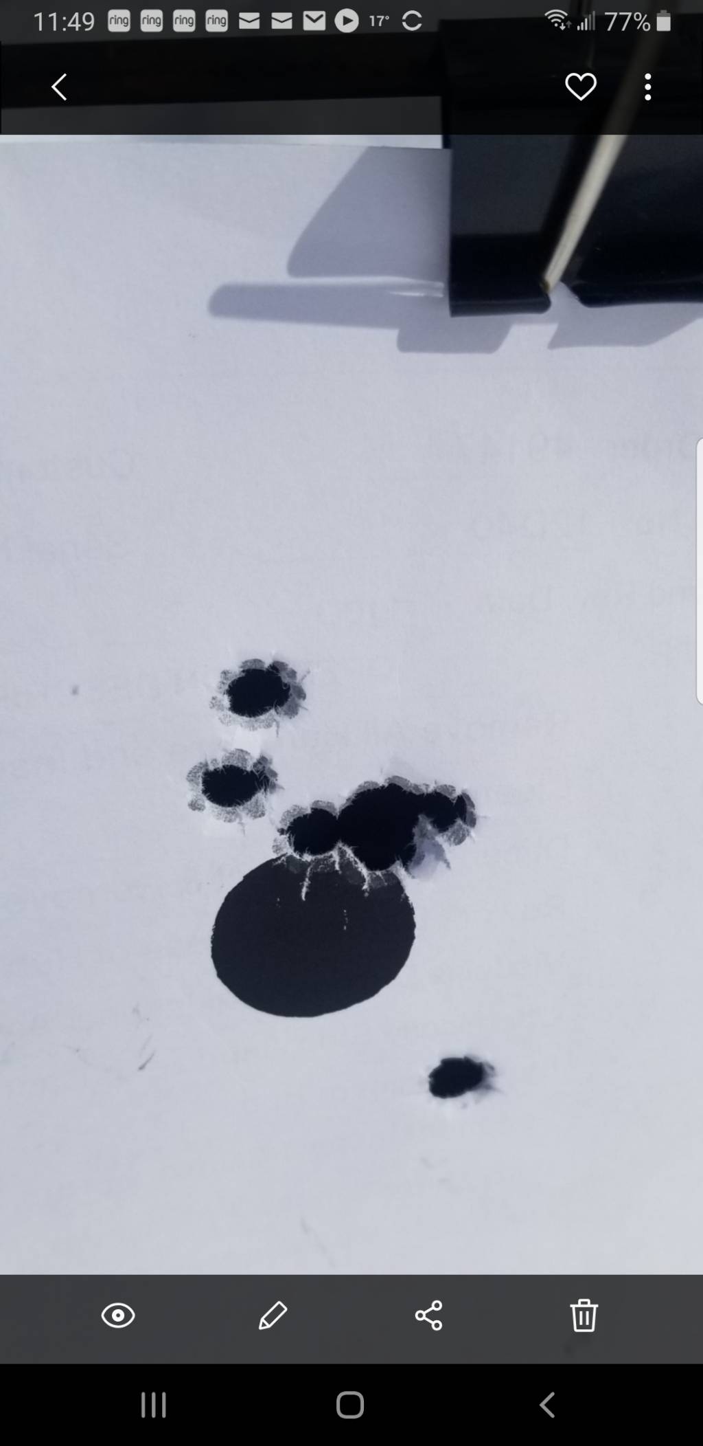

Ok guys and gals here we go. I did a little shooting and tuning this weekend. I set my Reg up to 150bar it was at 130. Did a little tuning and got her shooting .30 hybrid slugs at 914fps through the new superior hybrid liner. When I shoot this time of year here in Michigan I sit in my 3 season room with the heat cranking and the storm windows out of one window. SO, I end up with a lot of mirage as the heat races out the window. But!
that is 7 shots at 50yds with hybrid slugs.

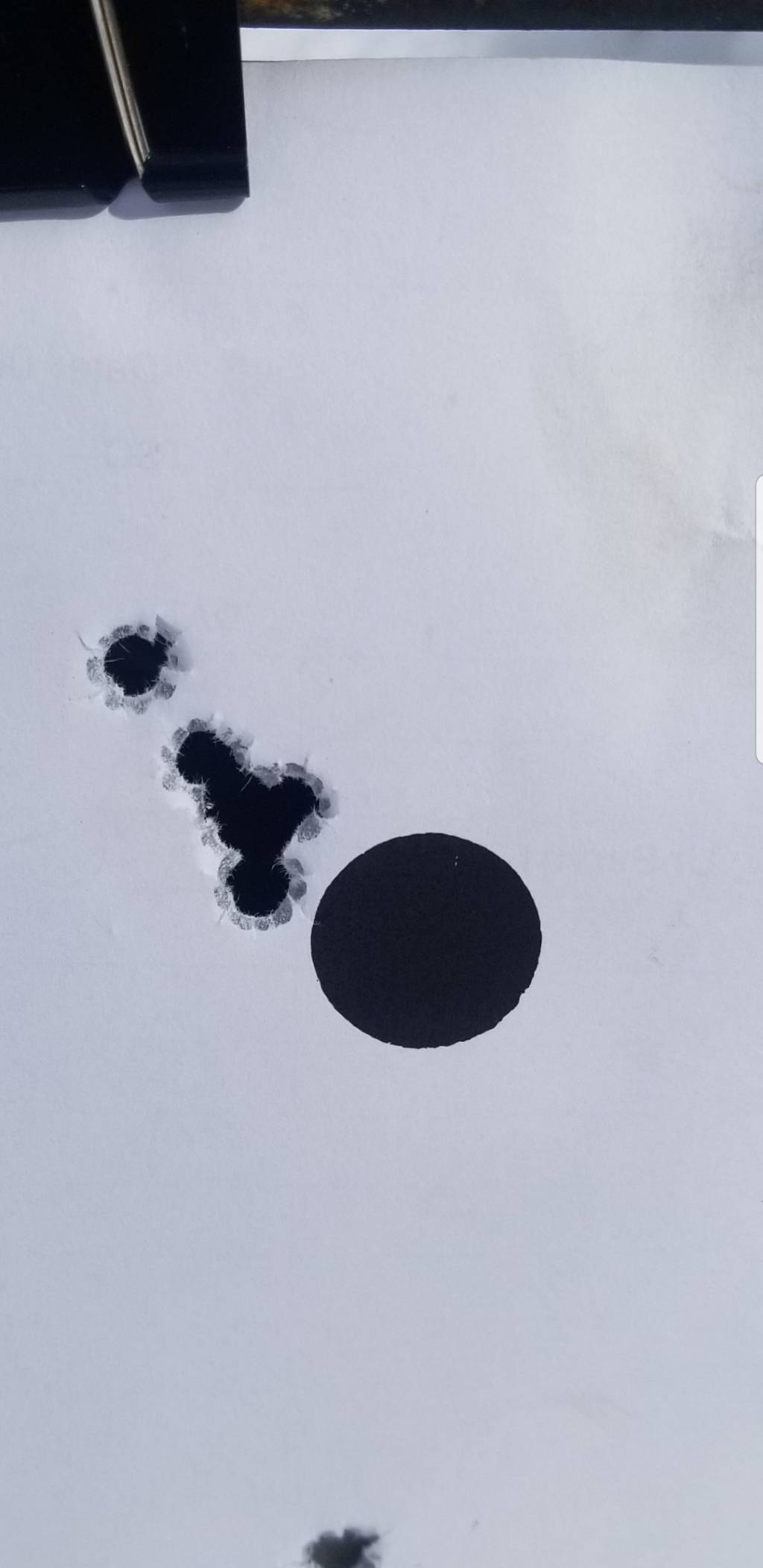

and the second is is 8 shots with nsa 43.8 slugs.
Btw the black dot is a dime I traced and colored in
