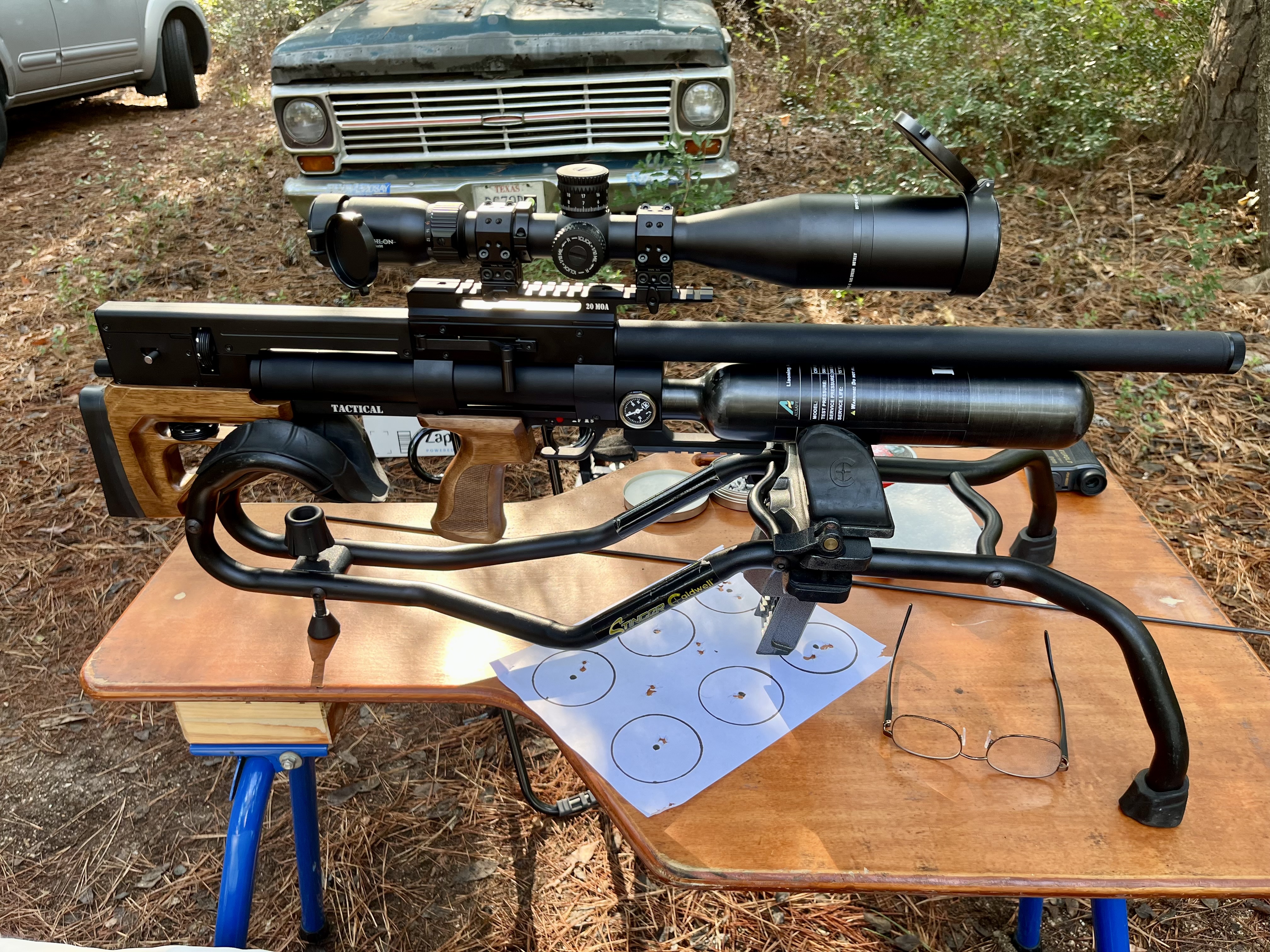

The .30 Cricket barrels are absolute performers. Lothar Walther; 1:29.9 twist, polygonal profiled, 600mm. I’ve sold/made-ready a dozen or so now and all performed beautifully. That’s an outstanding record of 100% out-of-the-box performers and rare, believe me.
Just set one up today with an Athlon Heras (great scope). Pulled a few patches using Gunzilla and then dialed her in across the chrony for 85 FPE with the JSB 50.15 grainers. Got trigger worked to produce a light first stage to a second stage wall that breaks cleanly at 4.5 ounces. Optically centered the Heras, torqued the EV rings (awesome rings) proper & mounted anti-cant bubble level. Plumbed the reticle to the action and headed to the 50 yard bench.

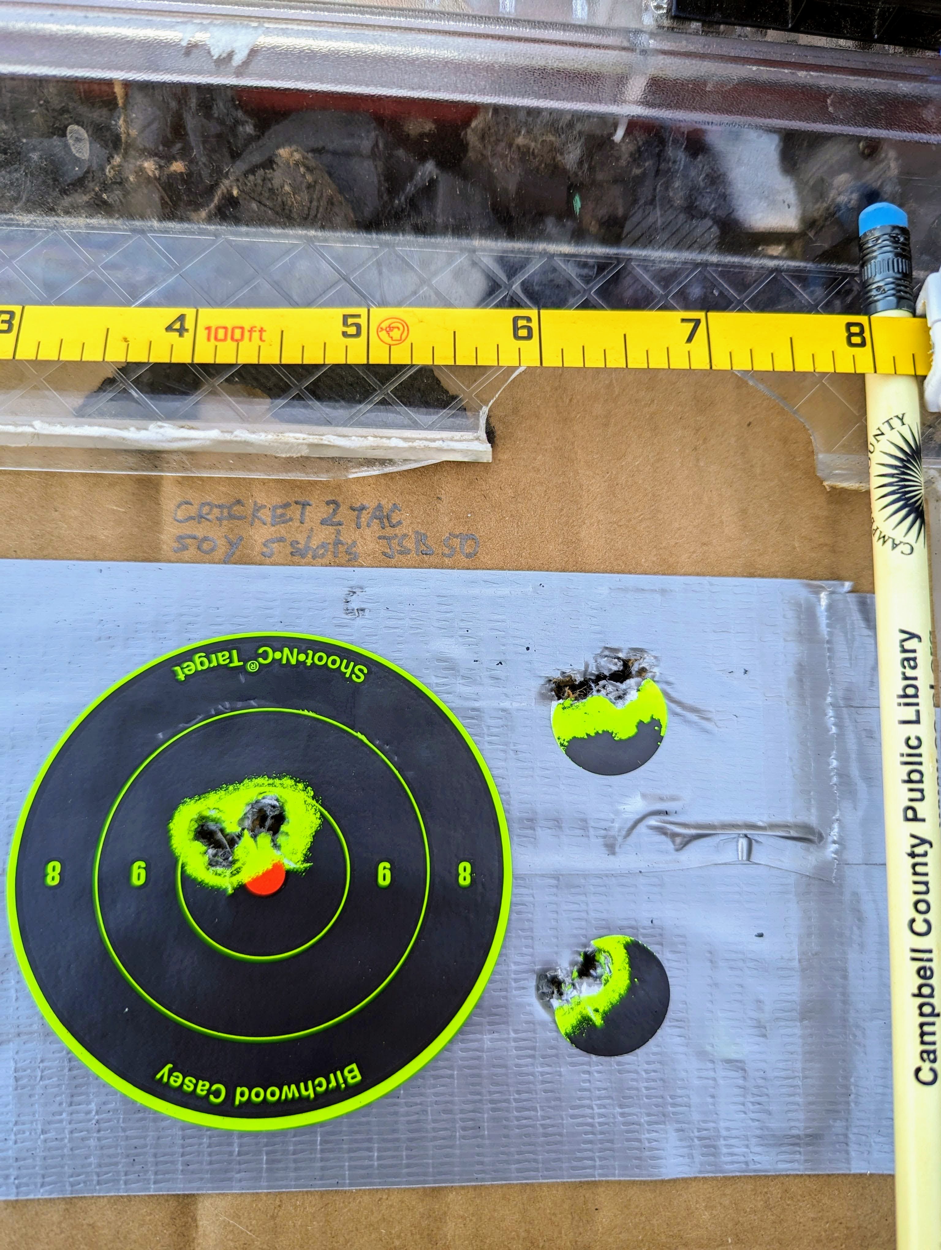

Used the adjustable rings to zero at the Heras’s optical center and started punching 50’s. I’m just letting y’all know, if you overlook these .30 C2 Tacs, you are not doing yourself any favors. 5-shots at 50 in 7 mph winds:
