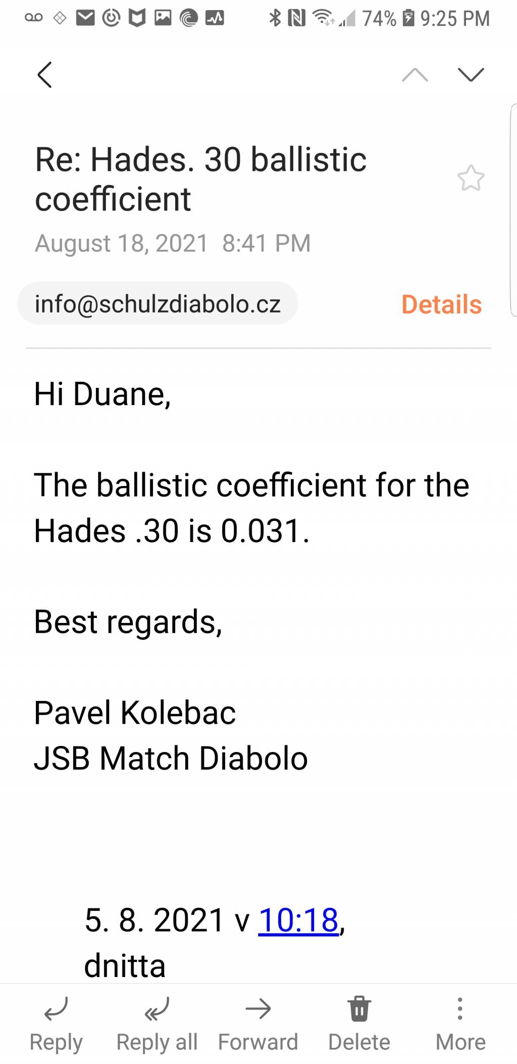

Just in. .30 Hades bc is 0.031
Thanks Pavel!

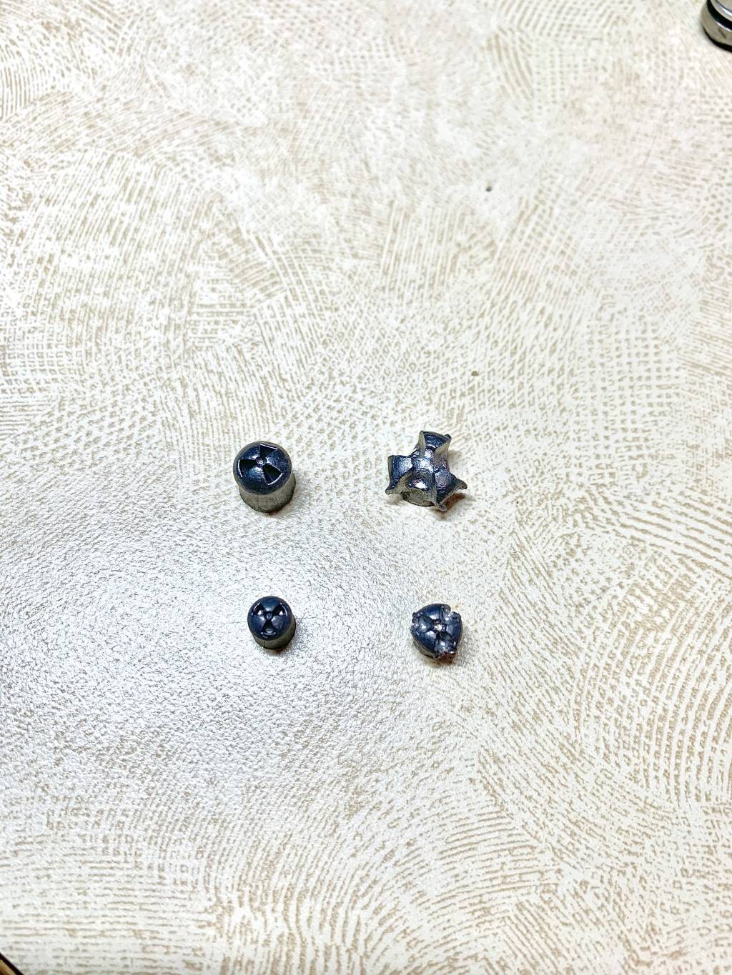

So I just received my order of the recently released .30 cal Hades pellets! I took them straight outside to test them with ballistic gel. I was using my Impact MK2 that I currently have set up for slugs max I was shooting the 44.75 gr pellets at 1024 FPS giving a muzzle energy of 104.2 FPE. I shot into the gel at 20 yards and this is what the recovered pellet looked like.
View attachment 148984View attachment 148993
The smaller pellet is a Hades I recovered from the gel in .22 cal. The .30 expanded to .454”!
