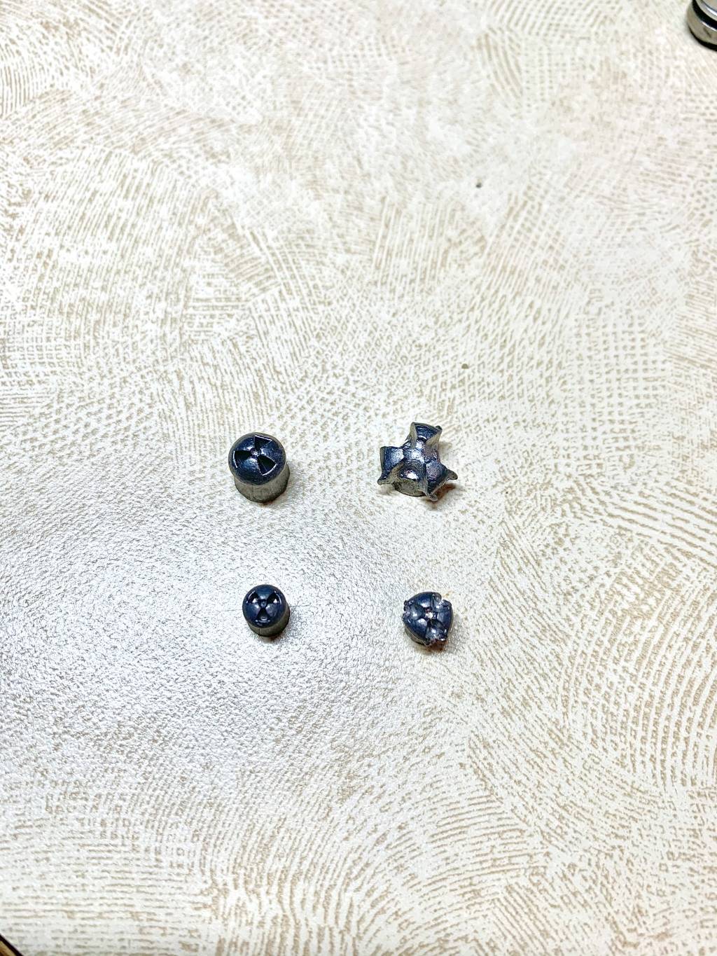

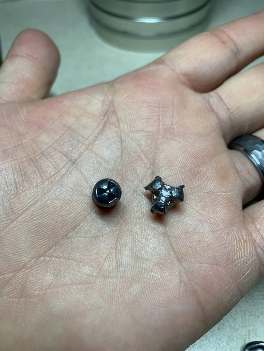

So I just received my order of the recently released .30 cal Hades pellets! I took them straight outside to test them with ballistic gel. I was using my Impact MK2 that I currently have set up for slugs max I was shooting the 44.75 gr pellets at 1024 FPS giving a muzzle energy of 104.2 FPE. I shot into the gel at 20 yards and this is what the recovered pellet looked like.
The smaller pellet is a Hades I recovered from the gel in .22 cal. The .30 expanded to .454”!

Very nice expansion. What was the penetration depth into that gel?
They penetrated 9” into the gel, but it is homemade gel. I did check it for calibration with a bb a while back, but I’ve melted it a few times since then. I’ll be working on a video in the next week, there is still 1 foot of snow here and lots of mud!
