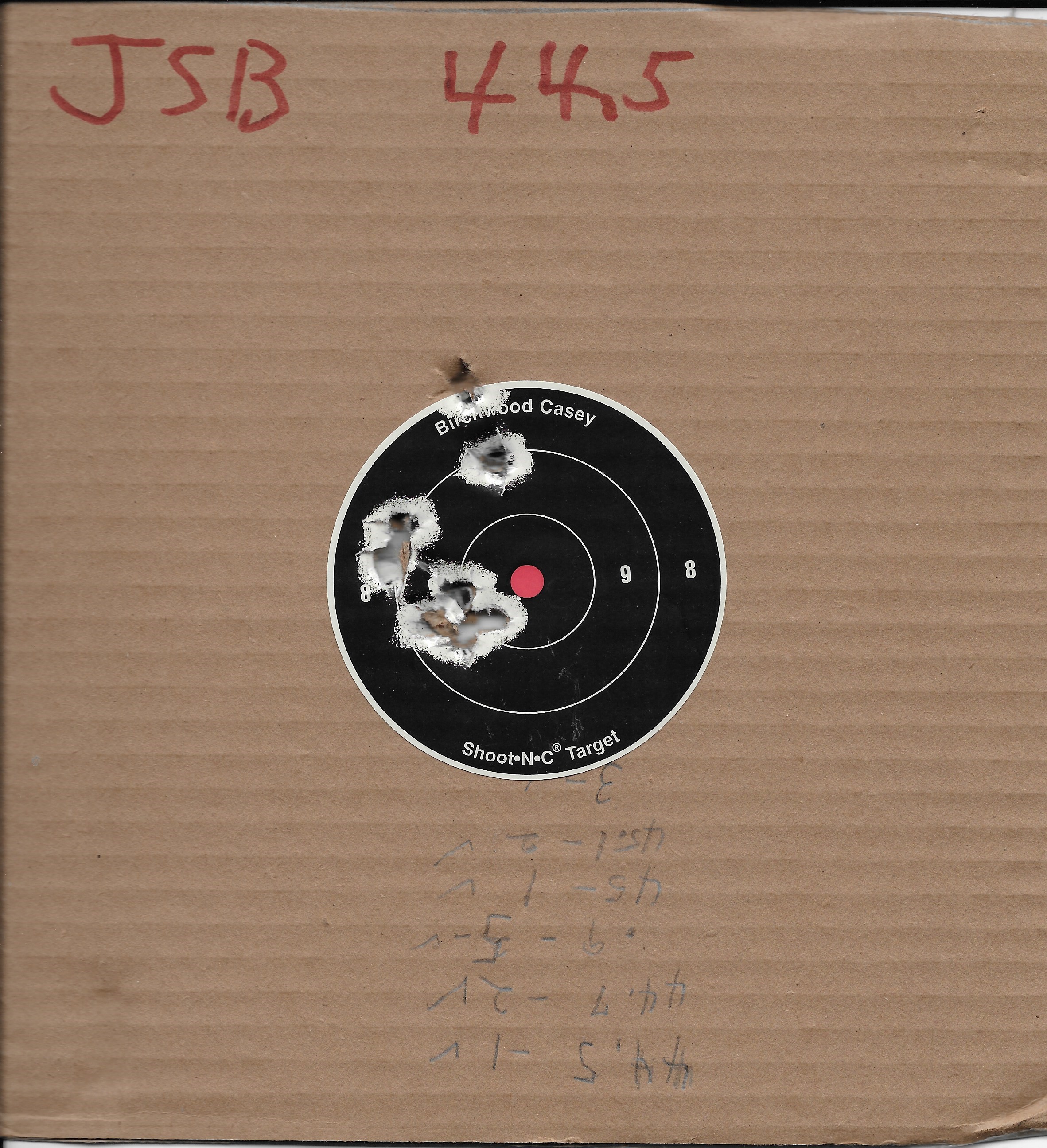

If you study the first target, 44.5, the elevation was spot on for 7 out of 9 shots. I was shooting from a mag and not my single shot tray. Notice this weight grouped to the left.

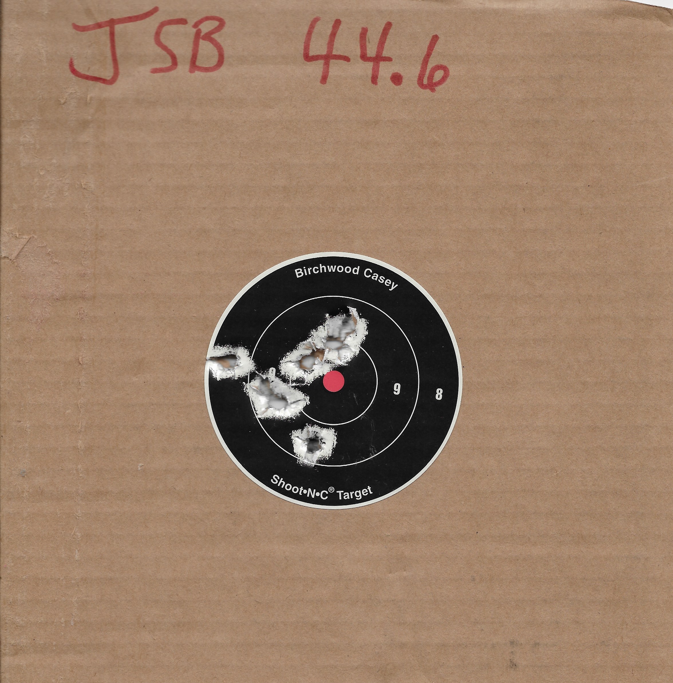

Target #2, 44.6 was also OK on elevation with a couple outliers but had grouped a tad closer to the aim point but still left of center.

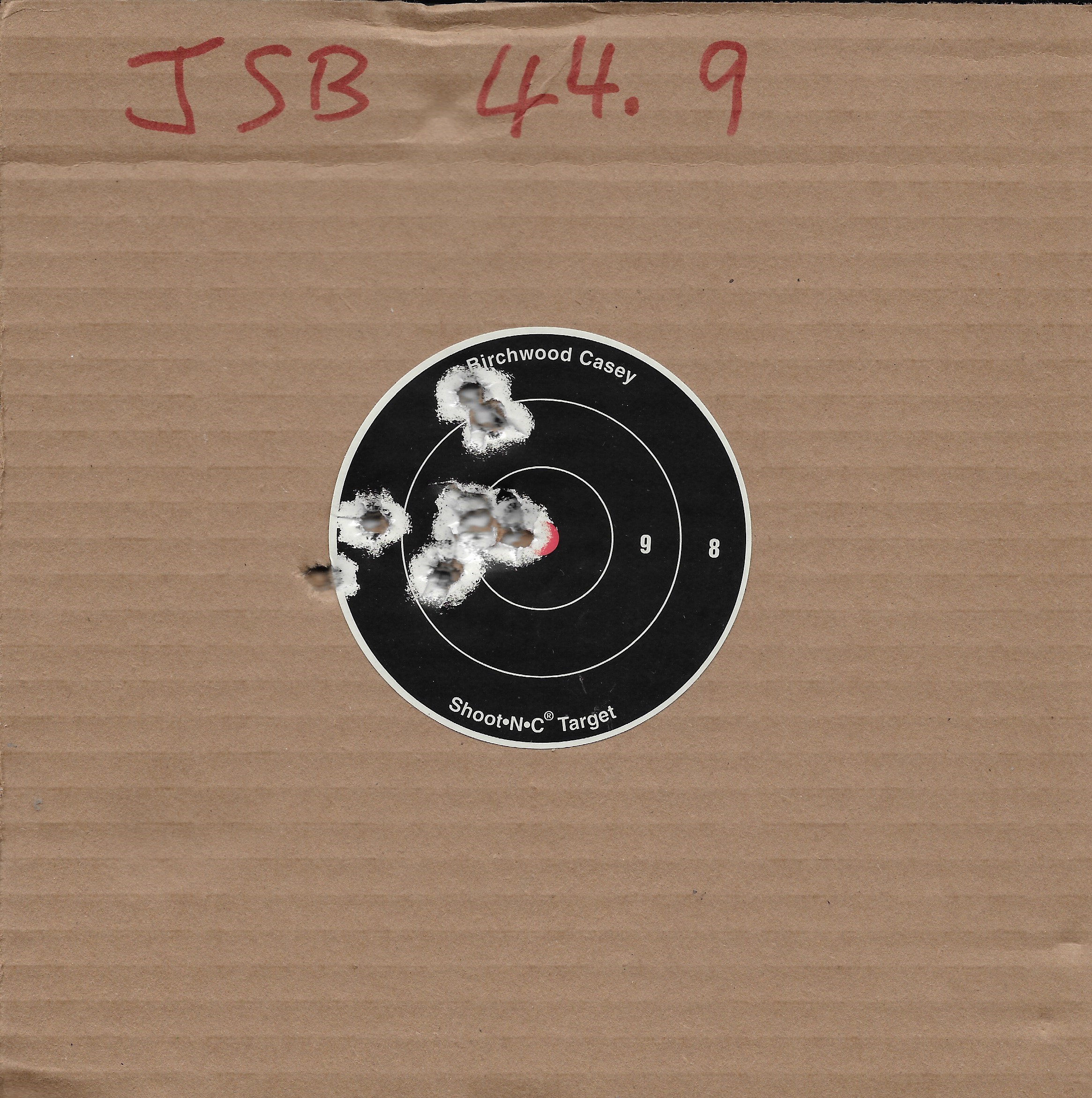

#3, 44.9 is still good for elevation with 2 a bit high but not as tight a group as others and still left of center

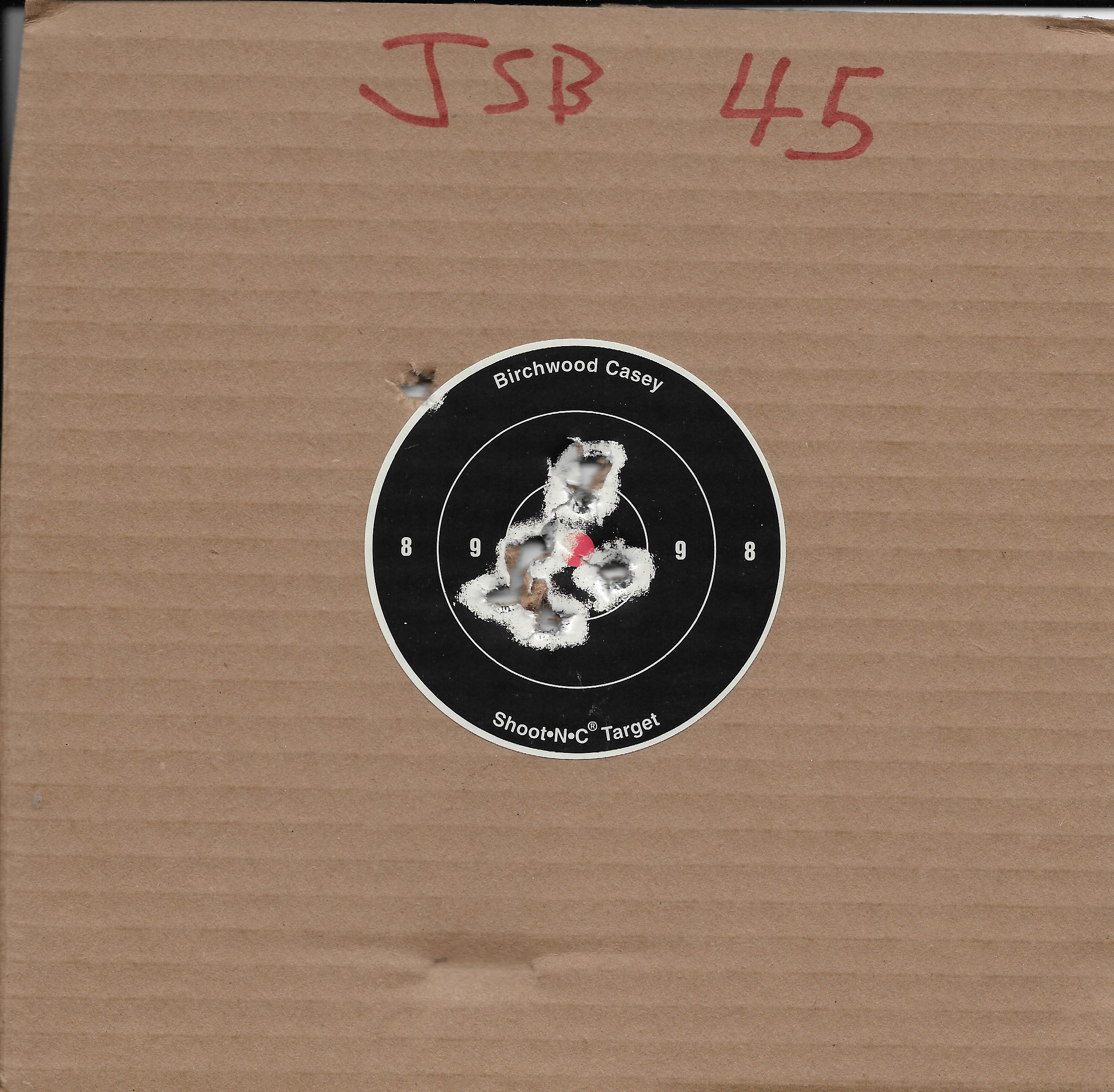

Last target, 45 grain is a nice group, but for one that hit at 11:00, WTF!

Anyway. I found it interesting how the groups migrated left to right as the ammo weight increased.
Thanks for reading this and give me thoughts as to why POI shifts right

I do find that weird that such a minor difference in weight causes a shift to the side. I've only seen something like that switching between different pellets altogether. I wonder if that extra weight is all being distributed into the dome, or the base. I would guess it's all in the base given how these things are probably manufactured.
Of course, I wasn't there when you were shooting to tell you if your technique changed slightly from one group to the other. Otherwise they all look to be within the margin of error.
