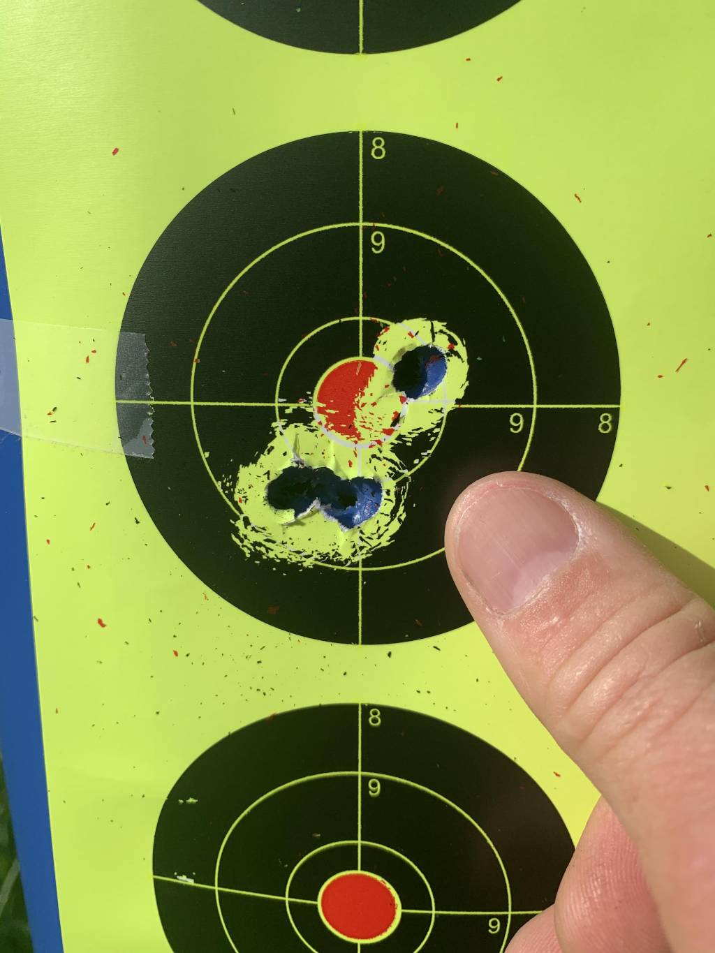

On my .30 cal, if you lightly squeeze the barrel and bottle together and let it go, due to the contact from shroud and body of receiver, there is no way it comes back to the same spot everytime.
That means while hunting, or the gun is handled by the barrel, or any other situation, the poi is going to change.
Hopefully someone will tell I'm totally wrong but having very small gap at that point seems like much better accuracy could be had.
The electrical connection is another story. I dont think that connector is tight enough to hold the barrel in any position. I believe the shroud/barrel contacting the gun receiver does.
