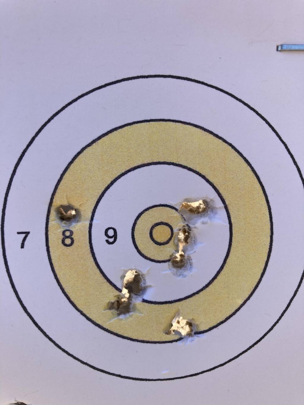

And just so it doesn’t look like all I do is complain, or don’t like the Delta. I call mine White Fang, and it’s positives FAR outweigh its negatives. If I didn’t like it I would have sold it already. FYI, here’s a ten shot group Friday with .25 Heavy (who knows Mk1 or Mk2, mine look the same to me). This group was from a tin labeled Mk2 but they look EXACTLY like my tins of Mk1 and my FX Heavy. Pellets at approx 890 FPS (I think, couldn’t tell). Anyway, 9 ring is 1.2 inches. 102 yards. Fairly windy left to right approx 9 mph.
