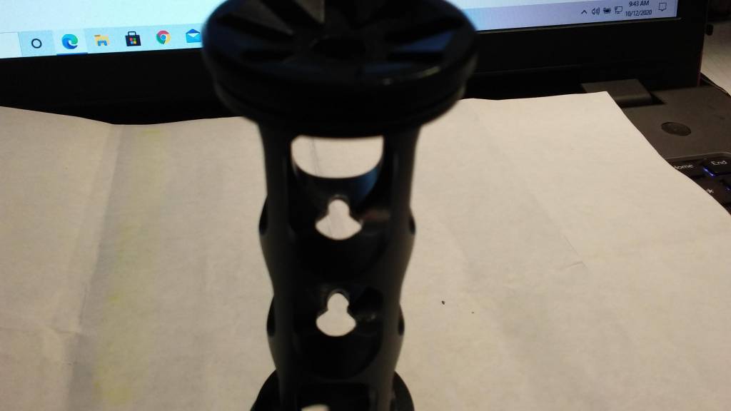

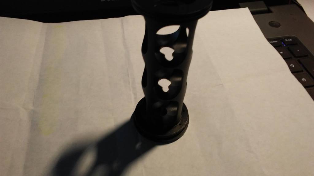

Well after a long time with my gun down I was able to get it together (reseal & mods) . This morning I attempted to run it over the chron. graph ,well I did not have the shroud on tight (still have to look at that) first shoot error second shot bam hit my wall 4 ft. from target . This is what happened (look at the key hole it did to my tatsu .It's a 22 bored to 25 cal. Hell of a way to start the day ! Not even going to mention the last 2 prier days . So be safe out there & don't do something stupid like I did. Forgot to mention it's a puncher breaker
I know what you are talking about I grabbed one of my Impact moderators to do some troubleshooting on my gun a few months back. Screwed it on chambered a round and pulled the trigger. The moderator blew apart and sent its internals flying across the room. It was pretty much destroyed. After a bit of thought I realized that I had tossed an extra pellet probe in a Ziploc and stuffed it inside that moderator a few weeks earlier. Had to have my shroud repaired and buy several/most of the moderator parts as well.
