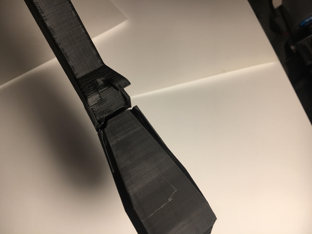

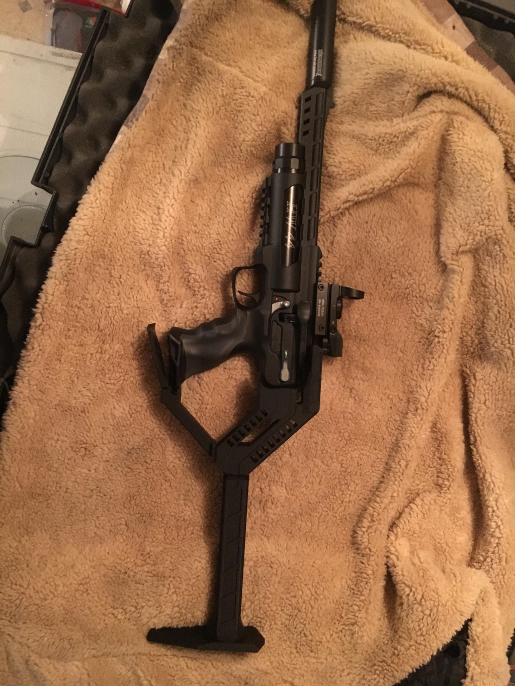

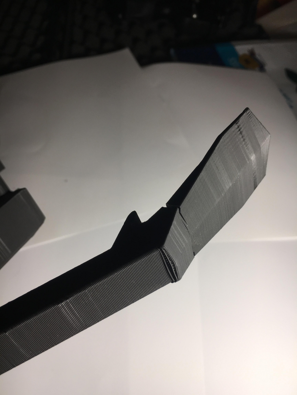

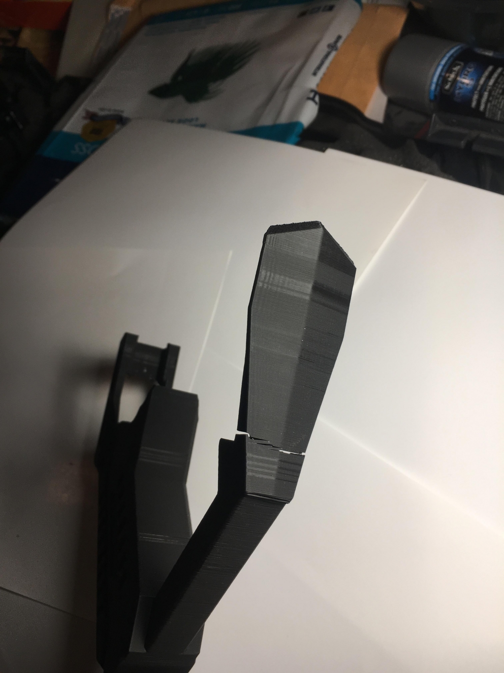

Hi everyone, I got this cool adjustable 3-D printed stock on eBay. The listing is closed now. Anyway the seller sent me two for the price of one ( $54 ) because of how fragile they are. You can see in the picture where the machine stitches it all together, problem is that it left weak spots and both broke in the same place. I’m going to be reinforcing it somehow because it is a great idea and it makes the HW44 into a cool little carbine. Other than the weak areas this is a great idea. I just can’t believe that he’d put them out there before correcting the problem. Just a heads up on my first 3-D printed purchase. The plastic is plenty strong everywhere else that it printed well.

JB Weld - Steel. Strongest epoxy I've found in the last 50 years. Bonds well to plastic, and sets up hard as hell. Paintable, comes in one stick putty form. Squish until even color, apply, smooth surface, let dry 24 hours. After that, you can drill, cut, sand, paint it...I used it on my SPA 700. Put a butt stock and hand grip on. It's the real stuff for things like this.
Uncle Hoot
If you can get your hands on the CAD model, or make your own model, you could go to a provider of 3D printing services and have your stock made using a process suitable for functional prototypes. When I last was involved in this sort of thing we were having prototypes made in Nylon using the SLS process. Surface finish was a little rough, so we would lightly sand and then paint. When we were done they looked great. This article explains the different processes.
