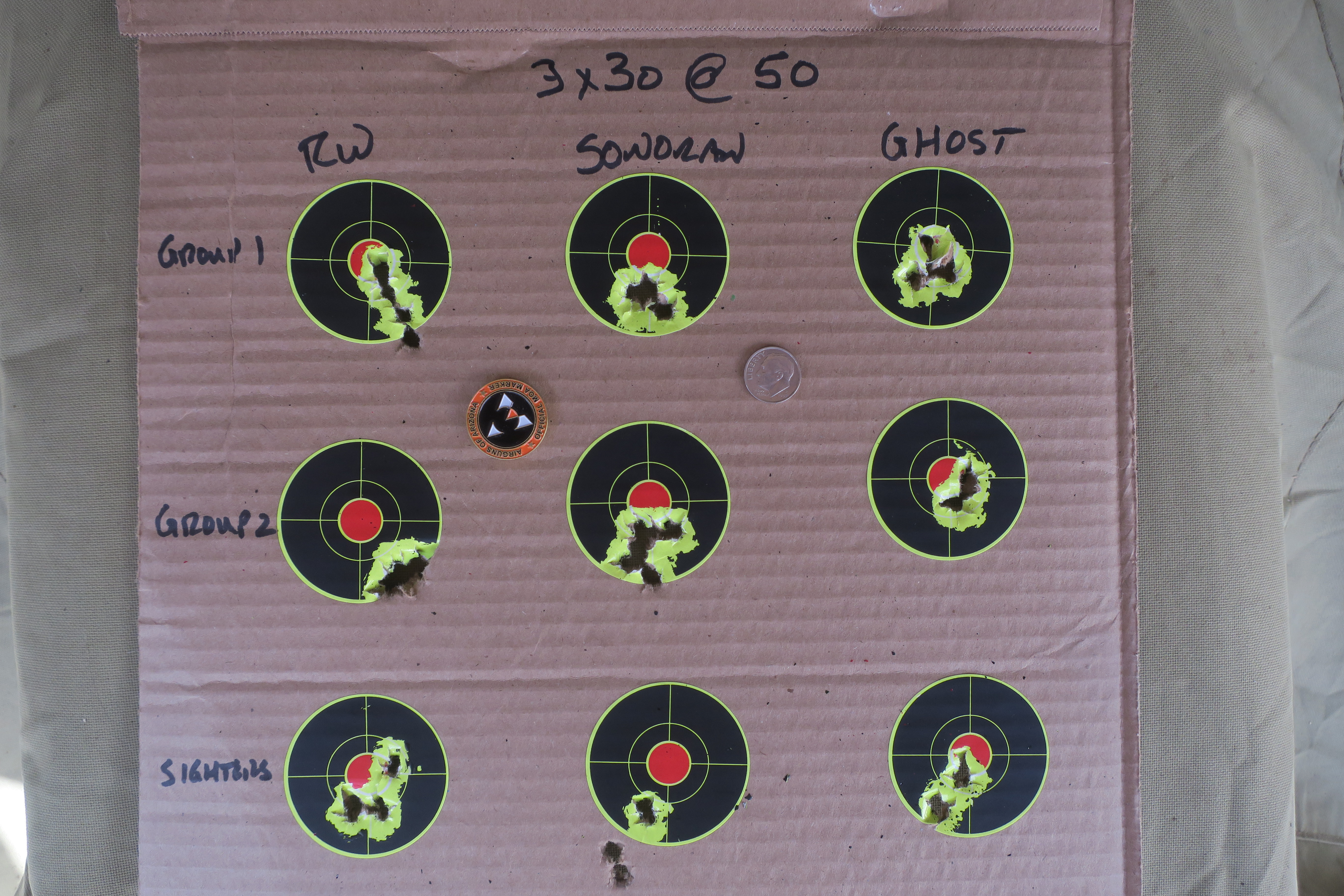

Now I'm much, much more of a plinker than any marksman, but here are my groups from this morning:
Just eyeballing it appears that groups #2 from the RW and the Ghost are the best, with maybe the Ghost's being slightly better. I have no clue as to why shots #3&4 from the RW's group #1 dropped in the 5:00 direction from the others. Shot #5 was back into the initial group. Likely operator error.
Thoughts after shooting all 3 back-to-back? The trigger on the RW was the best (no surprise there for me). Ghost was really good too, and the Sonoran came in last. RW and Sonoran big, long and heavy. Funny because the Sonoran is shorter than the RW due to its 'semi-bullpup' stock and shorter (?) barrel, but it felt just as long. Great for the bench, but boy the Ghost sure felt light and handy in comparison. And just fine on the bench too, except for my current set up (more on that later). Shot cycle was smoothest with the RW, and very nice with the Ghost. Once again the Sonoran came in 3rd place here. And for this shooter, today, and with these pellets, the outstanding SubMOA barrel of the Sonoran did not provide any magic benefit, as it came in 3rd place in the accuracy department. Of course that could be all on the shoulders of this shooter.

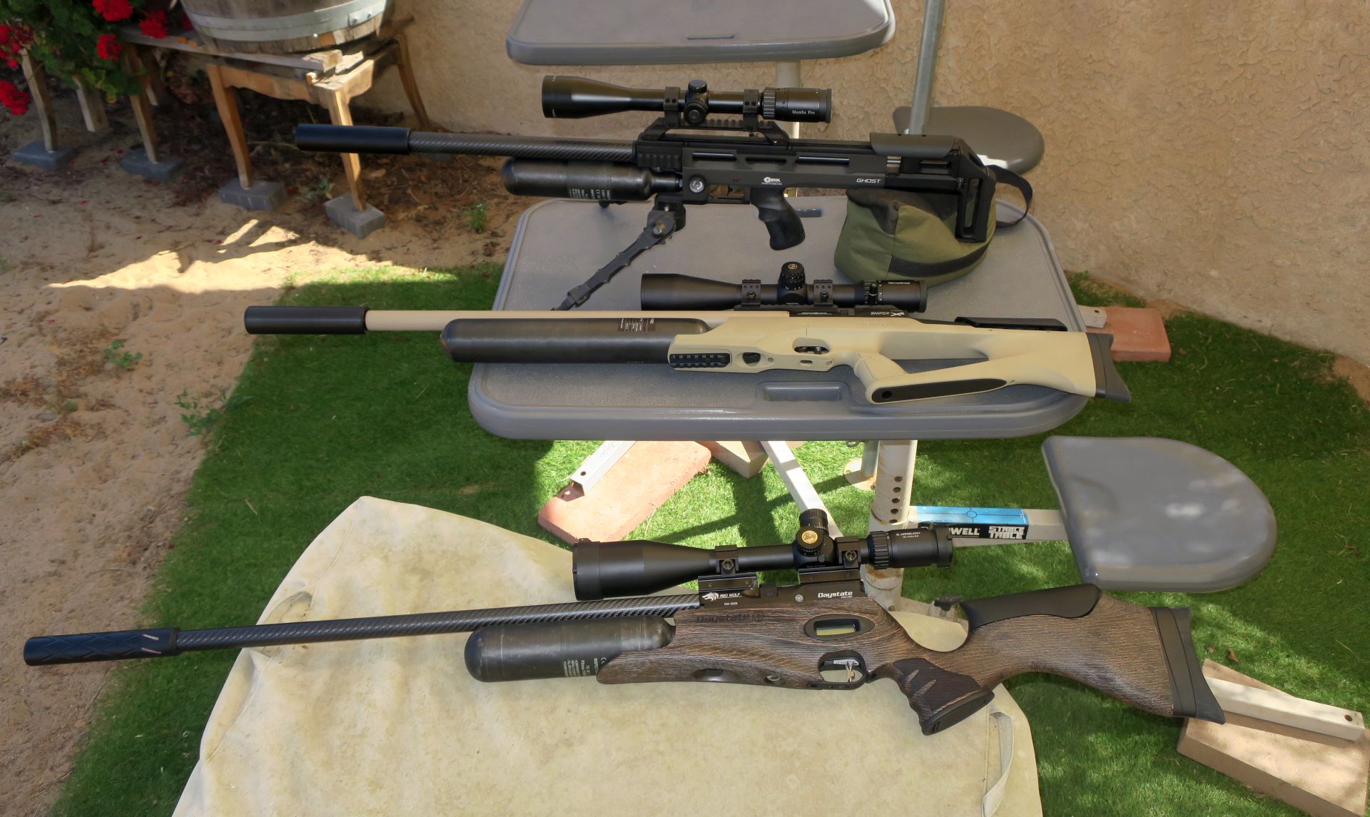

The 'contestants' - all would win the swimsuit competition in my view:
