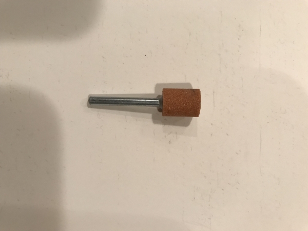

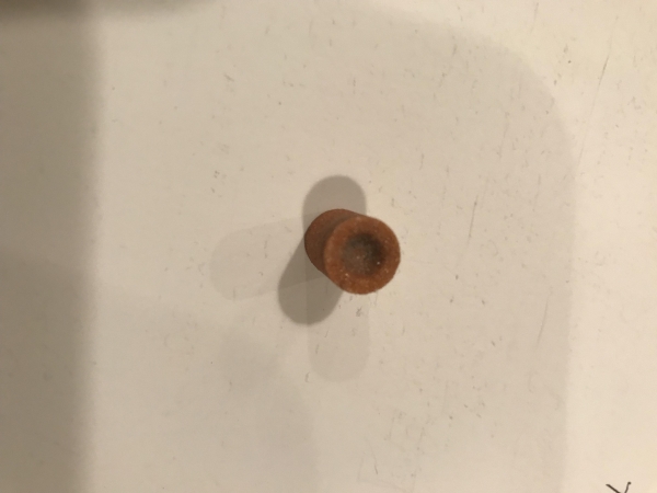

1- Yankee trigger tune link https://www.ctcustomairguns.com/hectors-airgun-blog/archives/12-2014 2- screw from Home Depot
 3- Dremel accessory
 I shaped the screw point to to a round convex point using the Dremel accessory and polished the point with 600 grit emory cloth. My son had a R.C fuel line I used for a washer. The mode was easy and effective.
