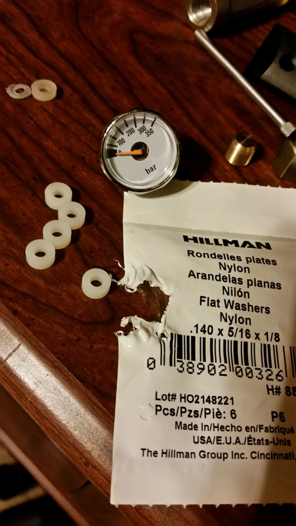

For you frugal guys, like me, here is what I used.
