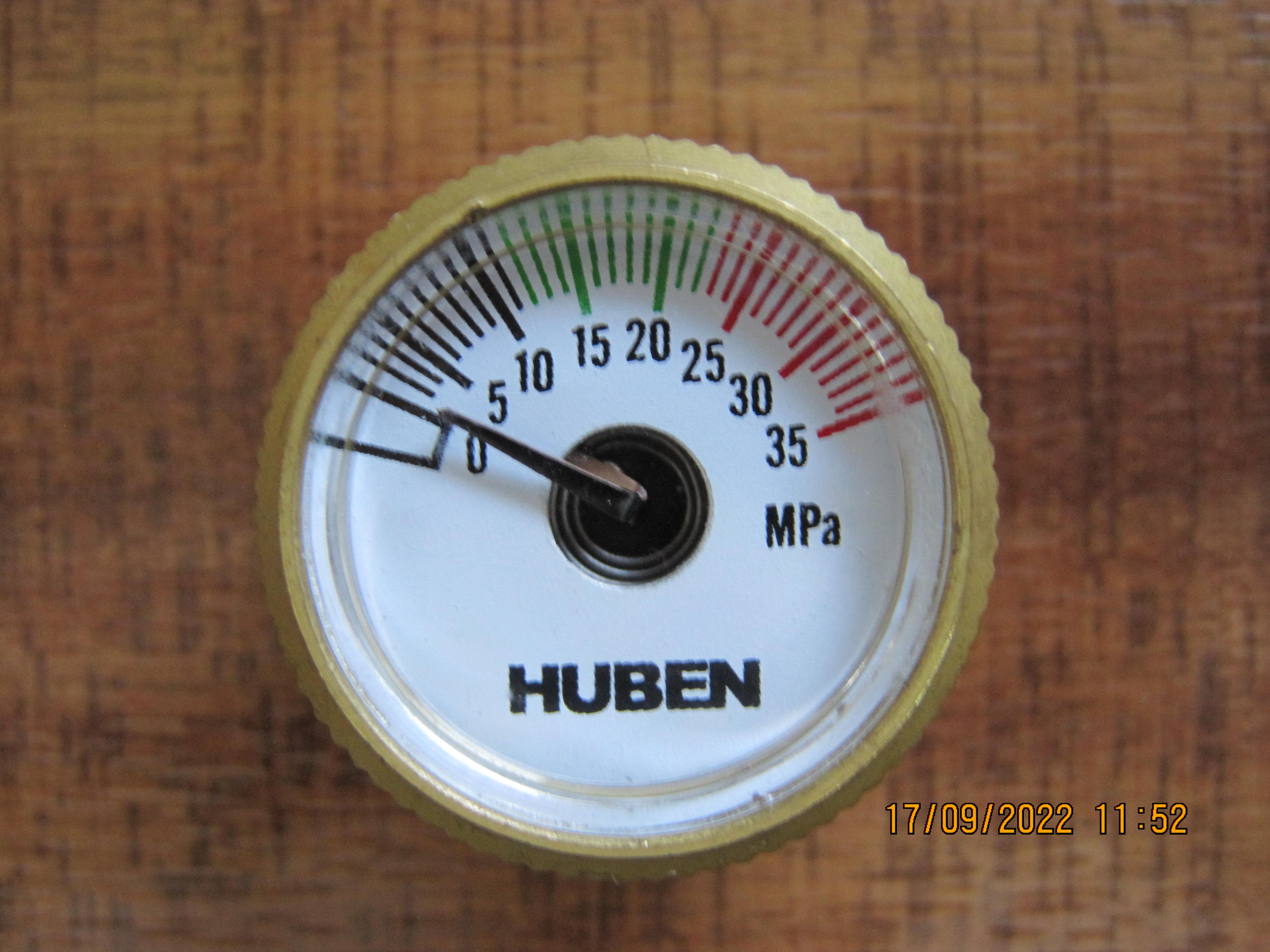

With my gun (Huben K1) completely drained of air, the manometer needle is not at zero exactly which is not doing my OCD any good!:mad: I want to to adjust this (I know, I know, first world problems). Is there any way of removing the plastic window without cracking it, and if not are there any plastic clear window replacements in case there is no way to remove it without cracking it. Its a 25mm manometer gauge, looks pretty standard. There doesn't seem to be any sideports where I could insert a syringe and pop it off.

In a couple of cases I was able to squeeze the gauge body and pop out the lens. Padded jaws on a bar clamp.
lol .. i have a couple of times 'adjusted' a gauge that was severely torqued ...its a simple matter of carefully bending the stem over (NOT the needle) .. in the direction it needs to go to get it where you want zero ..this by no means makrs it accurate, but it will be better .. anyway yeah, use a very sharp tiny drill bit by hand dead center to access it, and the same bit to bend your stem over..patch it with an ultra cool micro sticker from a sheet of some kind of model your into ..
*note - the most accuracy will be achieved with stem end centered in the hole of the dial, see how yours is 'high' ..so bend in the direction to center it to achieve zero ..
