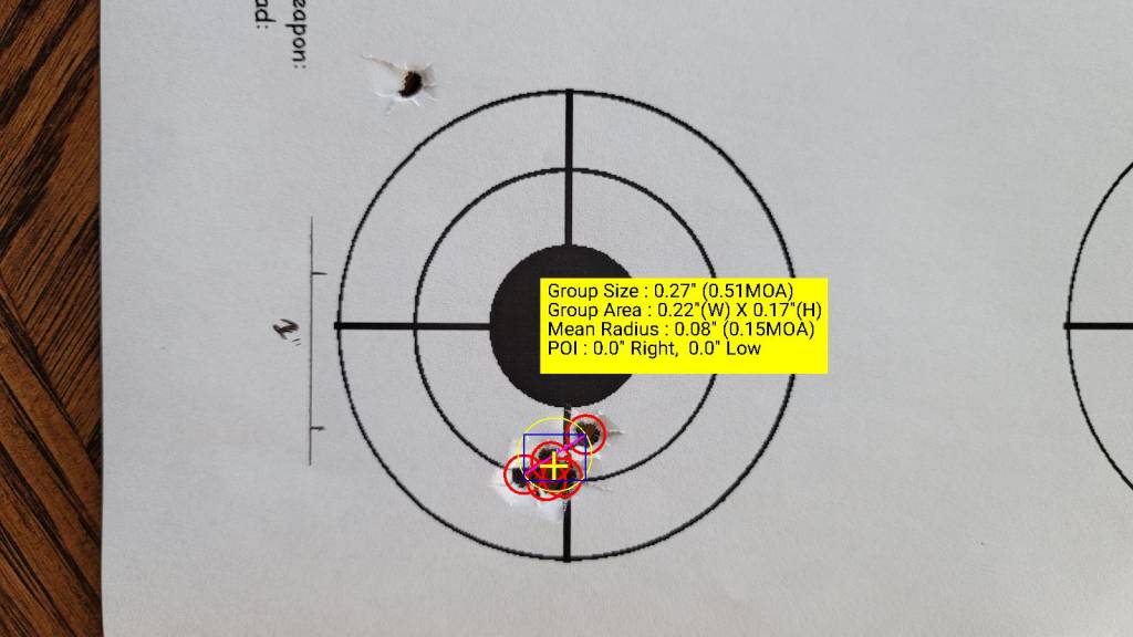

This is the first time I went out to shoot groups at 50 yards and this was the best one of the day. I'm guessing it should do better, or I should be.
edit to add.....25gr JSB Kings at approx 900fps. 700mm Superior liner with Earnest Rowe carbon fiber sleeve.

I don’t have an Impact but I regularly shoot both groups and scoring cards ( N50 ) at 50 yards outdoors. “IF”……. And I emphasize “IF;” …. Your gun is averaging 1/2” groups at 50 yards outdoors with any kind of wind, you are getting excellent results. .27” is spectacular, even if that was cherry picked!
I have a RAW HM1000x .22 HP and RW Safari .22 HP And both guns are capable of shooting 1/2” groups. I normally shoot between 5-10 Five shot groups and average the group size.
I would be happy if your gun is shooting MOA or sub-MOA at 50 yards!,
You think it should be doing better than half MOA? Don't believe the hype that they should all be in the same exact hole. That's very very good at 50yds. Lots of internet "professional shooters" will tell you same hole all day long. Don't believe them. Anything under MOA shooting outdoors is good, half MOA very good. I have only shot one 5 shot group at 50yds where it was the same size as a pellet hole and that was with my WARP Cobra .30. I've owned many many other guns believe me same hole all day is the biggest joke ever especially outdoors.
Anyways like Jason asked, what's the rest of them like? Were they way bigger?
I’m guessing your pellet will move 1/4” at 50y in a 1mph wind. Depending on the wind angle….it will also move up and down. Nobody has the ability to accurately determine what the wind is doing between the muzzle and target without flags and velocity indicators. You cannot sense a 1mph wind change. Therein lies the challenge of Benchrest shooting.
Mike
That one shot could be a flyer, wind or even your heartbeat. Minus the outlier that groups is amazing, even with the outlier the group is still fantastic. No matter how anyone boasts that’s really good at 50 yards. Can they all touch at 50yards? If stars all align, sure. I’ve gotten almost all touch 5 shot groups at 50 yards with slugs but pellets get affected by wind too much.
Nice! That is a very decent group for 50 yards for a first time with shooting groups, especially. That is five squirrel headshots at 50 yards! I like to run multiple groups so I know the gun is producing consistent groups. The groups can bounce around with the human and wind factors. Don't sweat it, It is good. Those speaking of single hole groups are not being realistic. I have done it at 50 yards but that's far from the norm and more of luck.

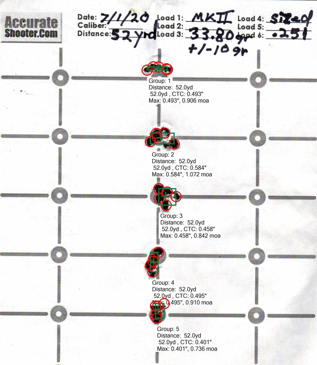

Here is an example of my groups with my .25 600mm. They are about the same as yours and I can hit what I want with them. I like the MKIIs. I don't record many groups, but have several like this when I use to record and post them.
