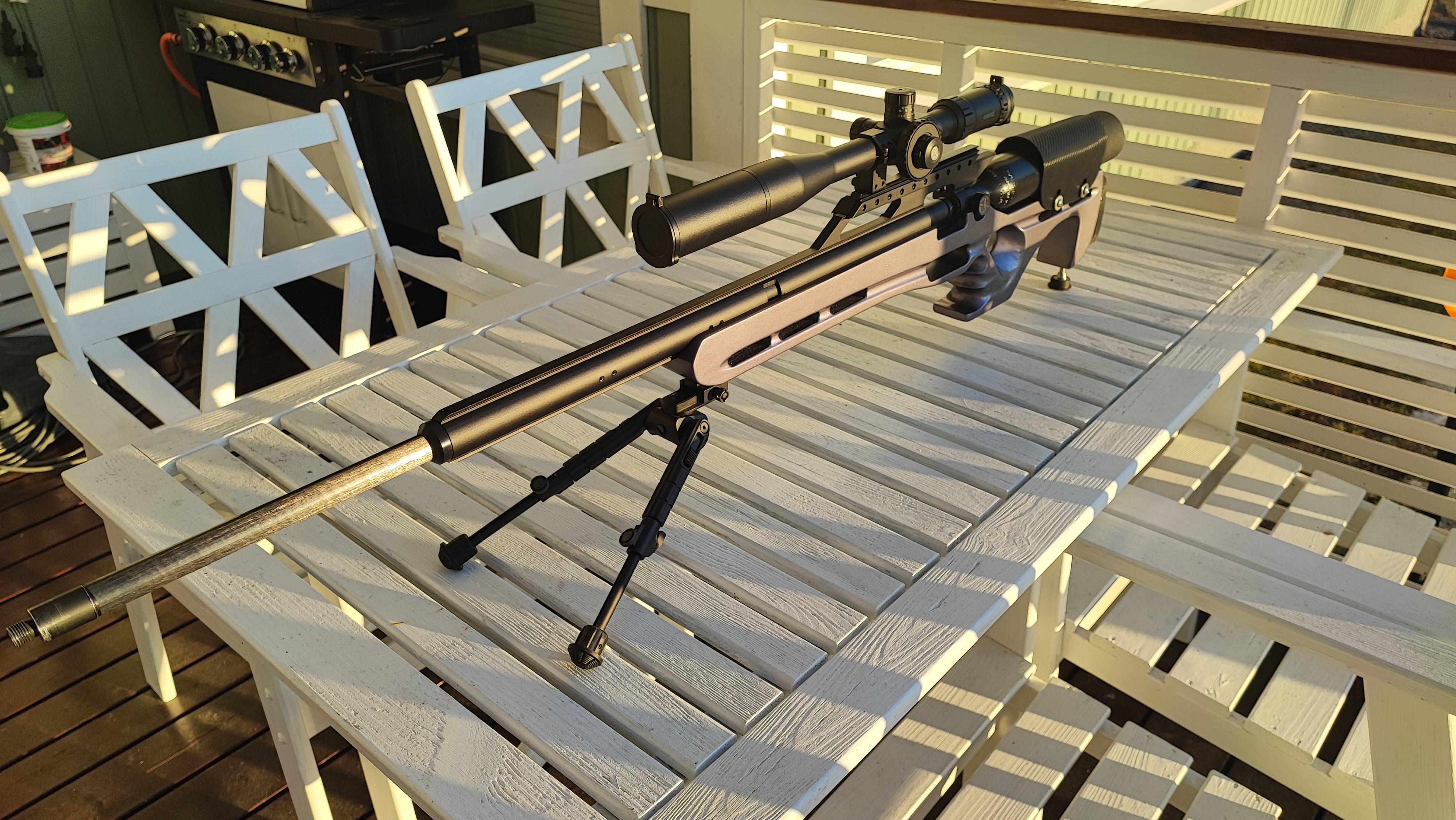

You do any hunting with it?Nothing really. Its solid performer out of the box.. if you want to improve it get stock for it and if you have change to use lathe you could thicken barrel with carbonfiber. Thats what I have done and its by far most accurate pcp Iv ever shot at 100yds and beyond.

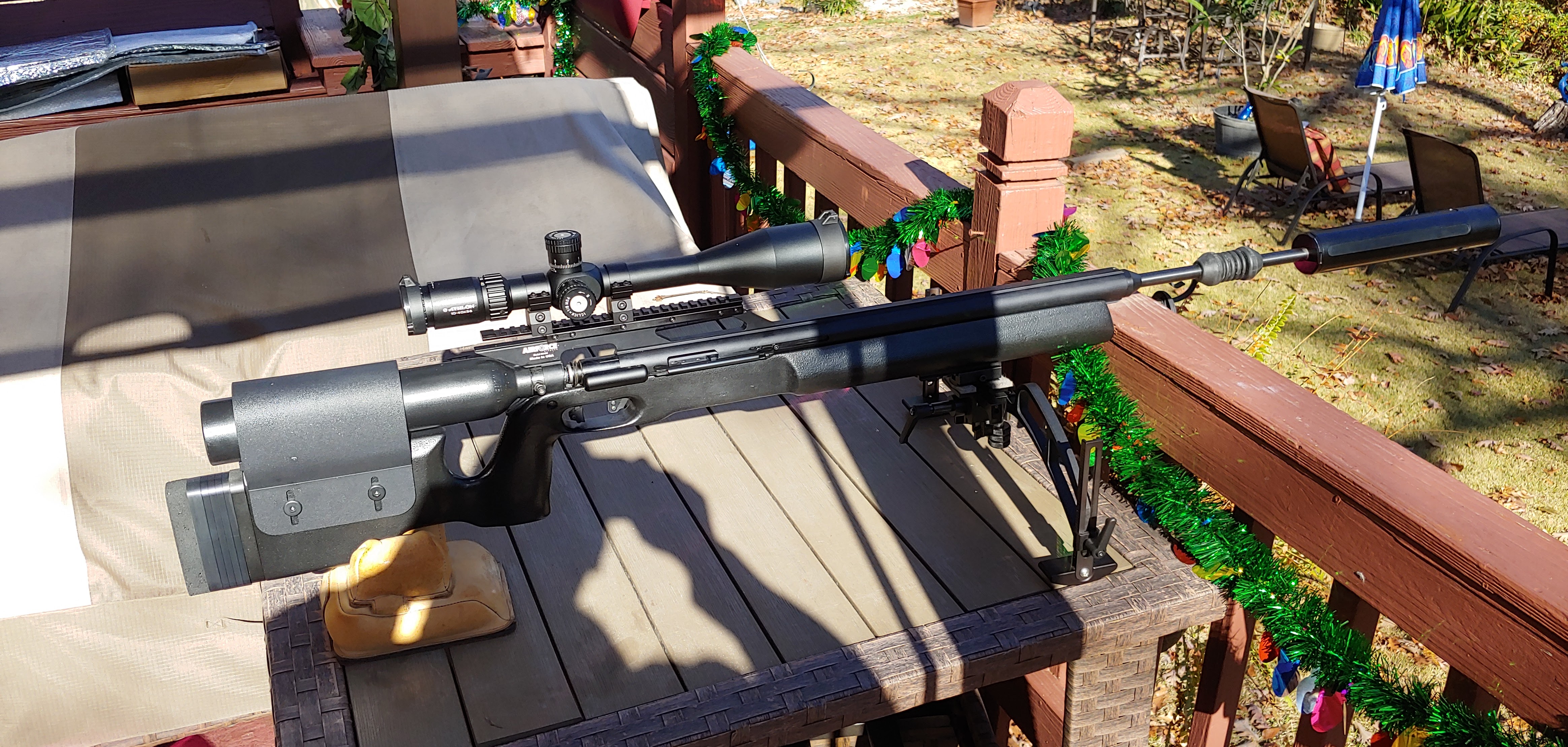

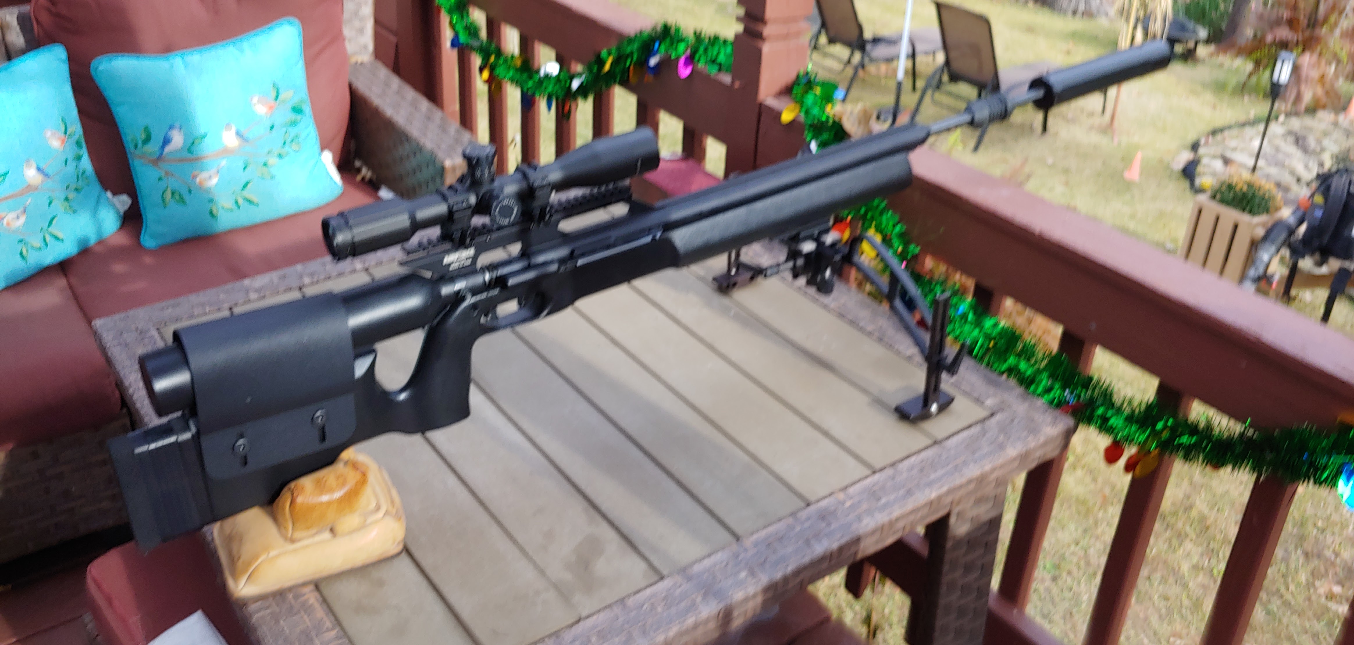

That sounds about right. I think I paid that for mine, but mine went on a TalonP, not a Texan.I think I paid $250 for my mad dog stock, it really made it a lot easier to shoot. I do have the .457, not a .257 but I don't think there is much difference in this context.

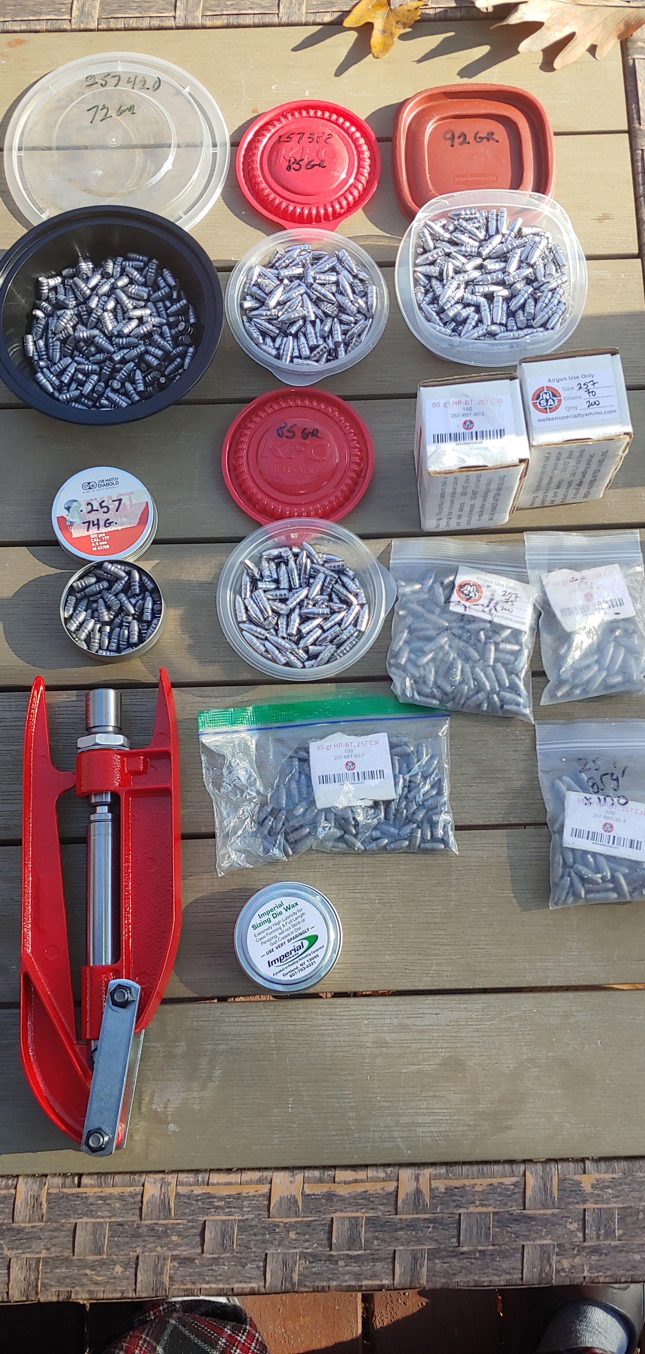

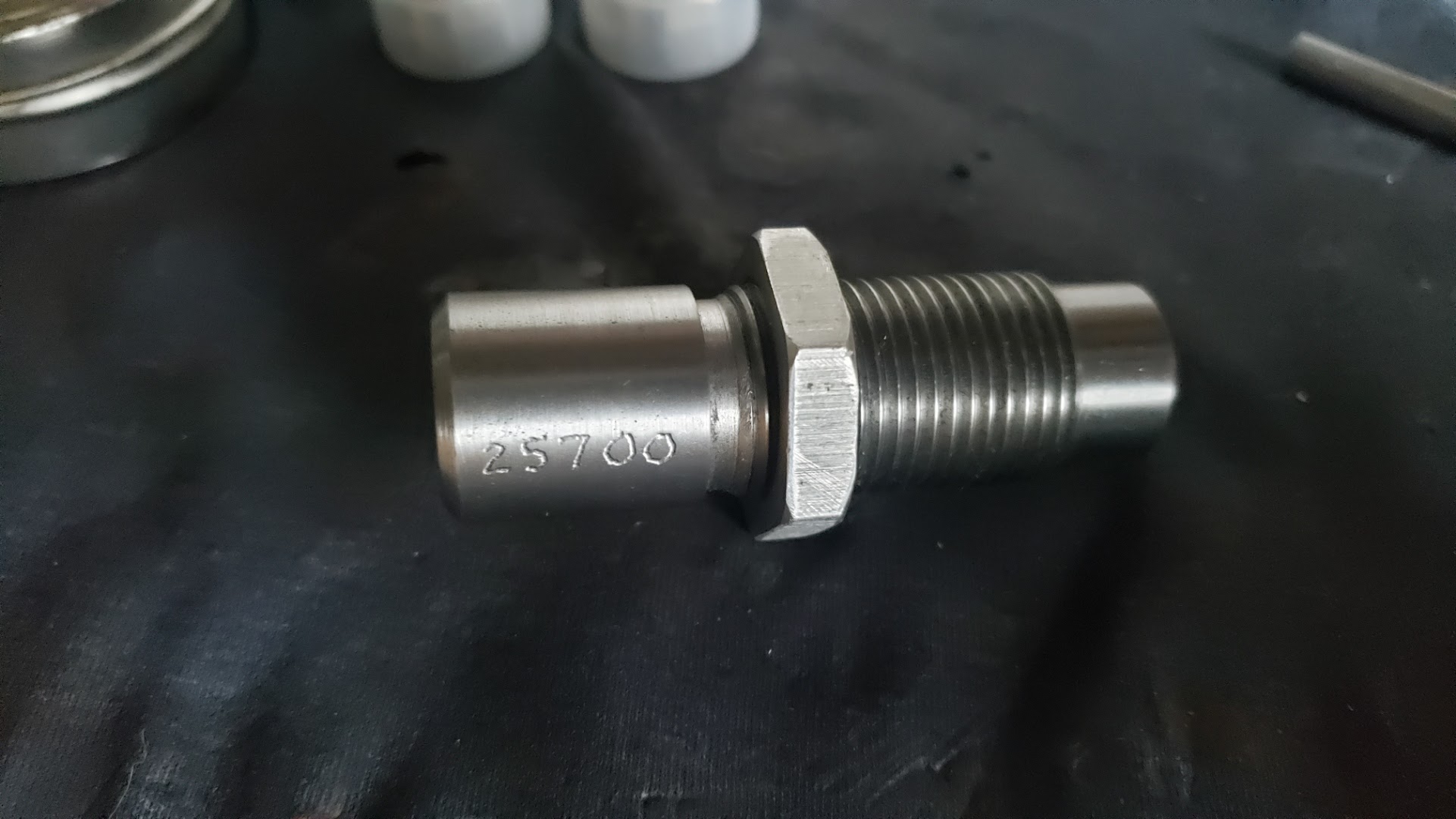

Sweet setup! How do you slug the barrel?A few things come to mine. First slug the barrel and order the correct sizing die. This is very important for accuracy and control leading. A good set of cleaning rods . Gotta keep the barrel clean . The maddog stock is high on list. Sizing lube. Rc shock oil for bullet lube and a good external regulator. Assortment of slugs and big air tank and you are good to go. Ps, don't forget Donnyfl if you have long bbl.
Not to bad I thought it would be in the 500 category!I think I paid $250 for my mad dog stock, it really made it a lot easier to shoot. I do have the .457, not a .257 but I don't think there is much difference in this context.

Thank you! You do anything internally? Like hammer spring, valve, etc…Get a stock... Slug your barrel... Fire lap or hand lap barrel.... Tether with decent regulator... Get a regular cleaning rod and brass brush. Keep your barrel clean no leading!!! Hopefully you get a decent factory barrel and go from there.. I made my own stock for my Texan from my old crossbow stock. You can buy thick carbon fiber tube and completely cover your barrel making it full 1.0 inch and everything is tight. If you cast you should powder coat too. Quite a few benefits.
