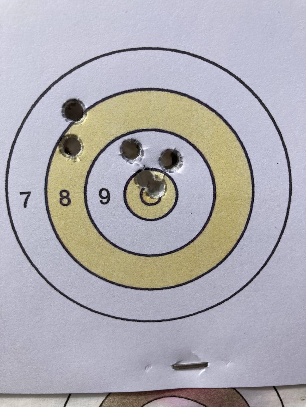

Accuracy seems to be very close between the two, but as of now I’ll give the nod to the NSAs. Below is a typical 100 yard group with the new Zans in light winds left to right.

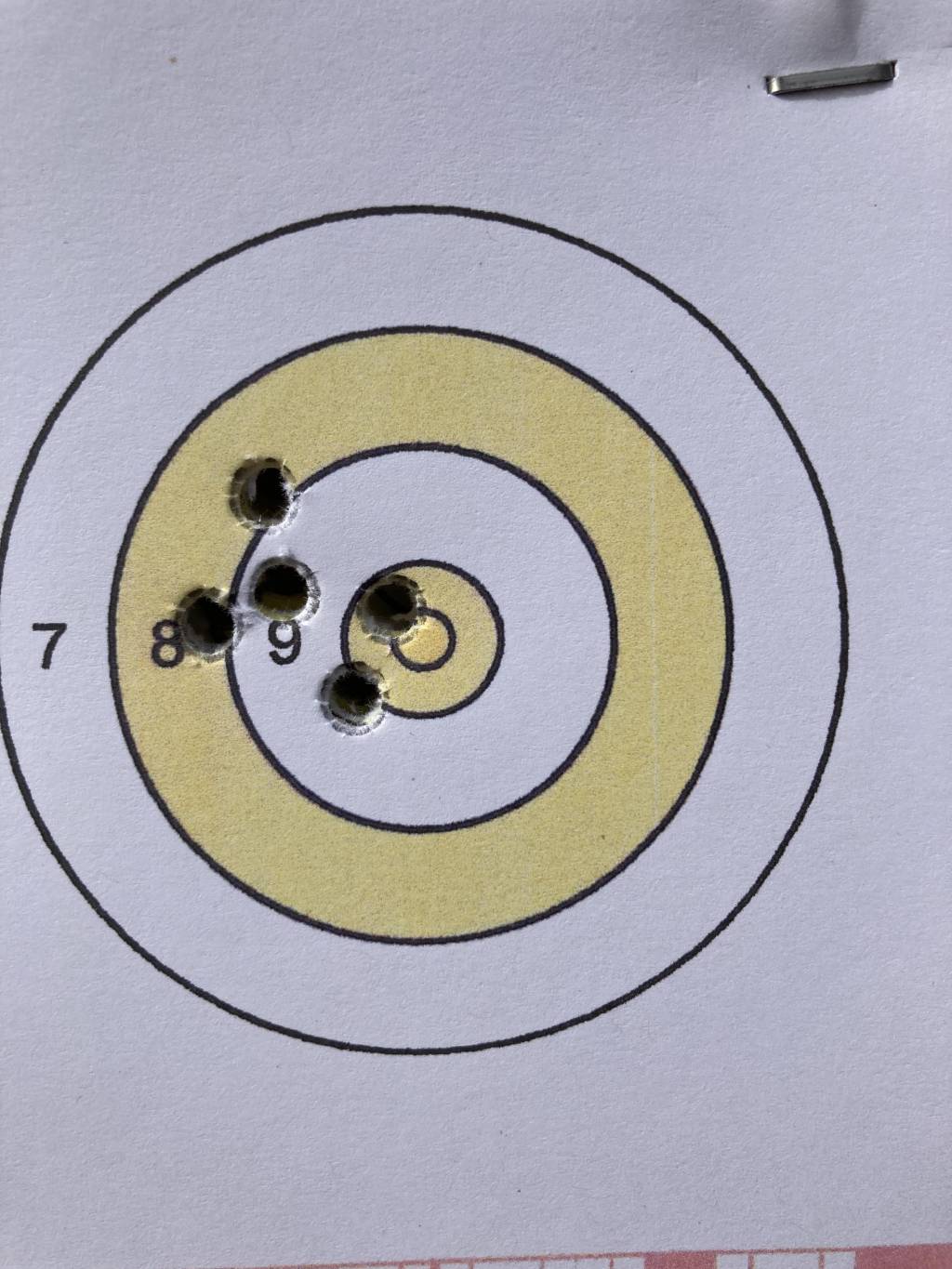

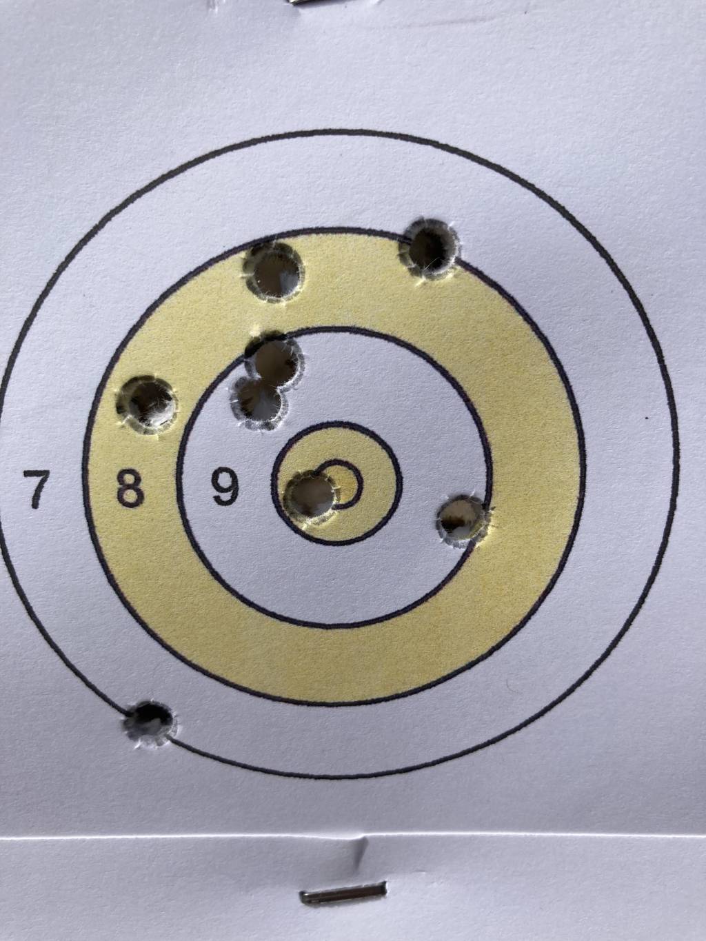

Next two are cherry picked five shot groups at 100 yards. Same wind. Bottom group is 1/2 MOA.
Thanks. Yeah, the bottom one is the best of the day. The 9 ring s 1.2 inches so you can see that group is about 1/2 MOA. The top 5 shot group is about 1 MOA. But those were the two best. The normal group with the NSA 43.5 is about like the top 8 shot group. The Zans are very good just don’t seem quite as consistent in my gun
