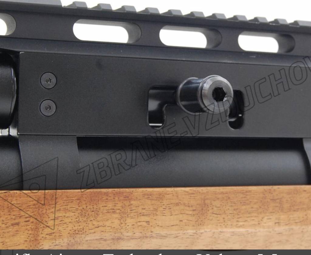

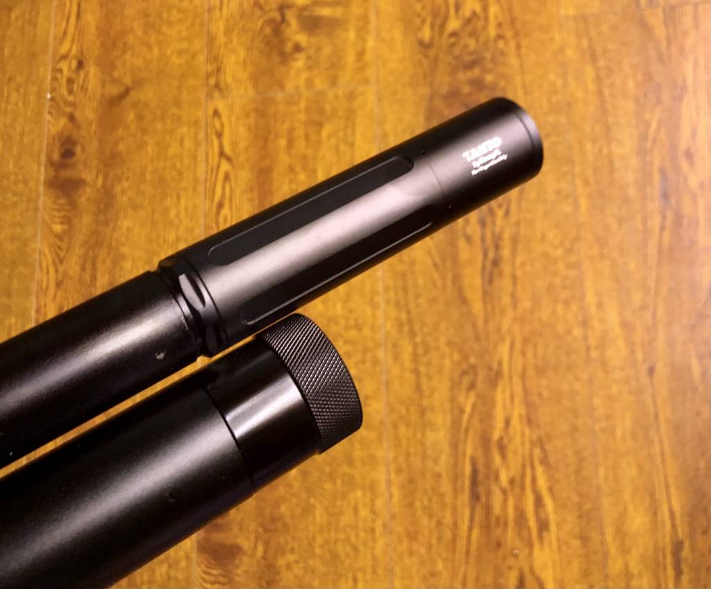

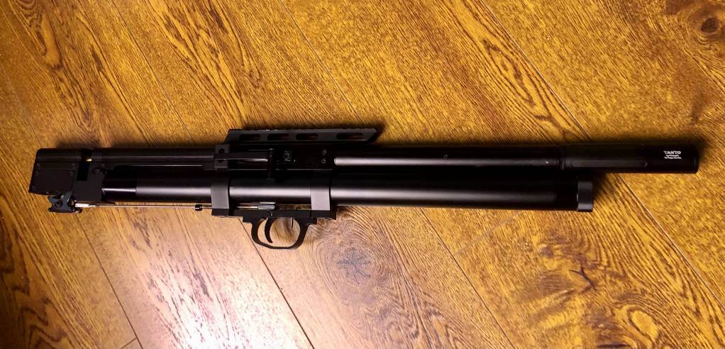

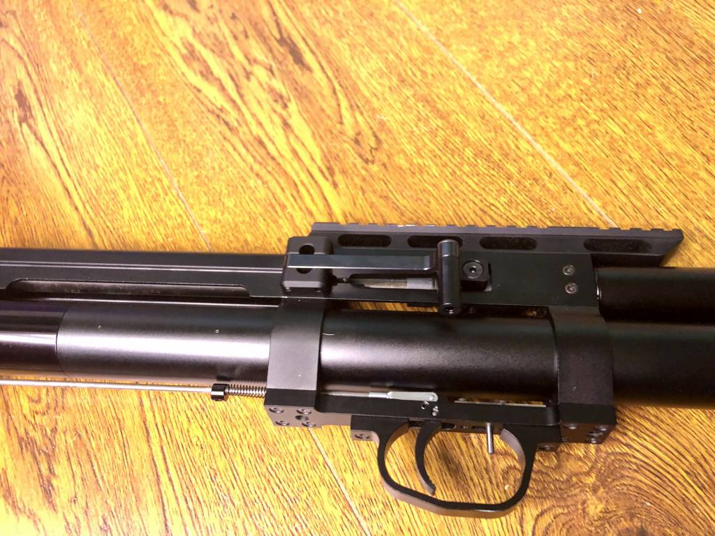

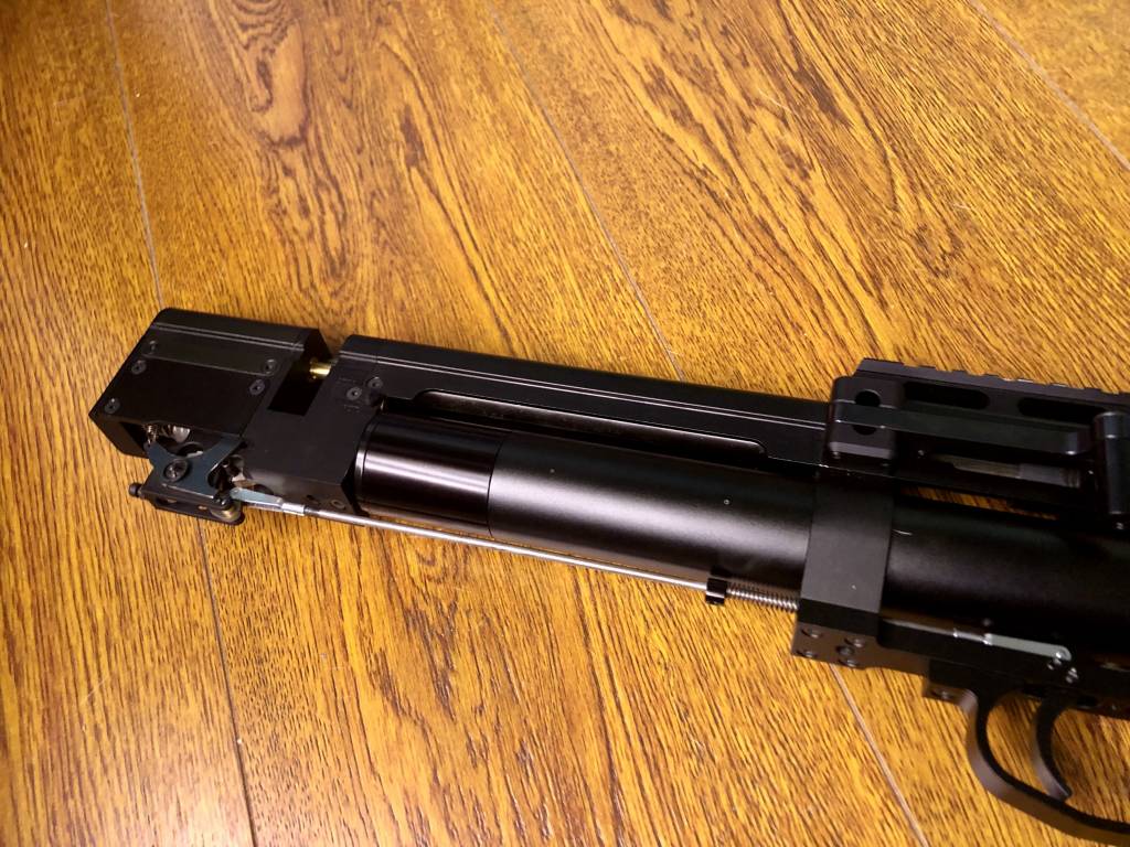

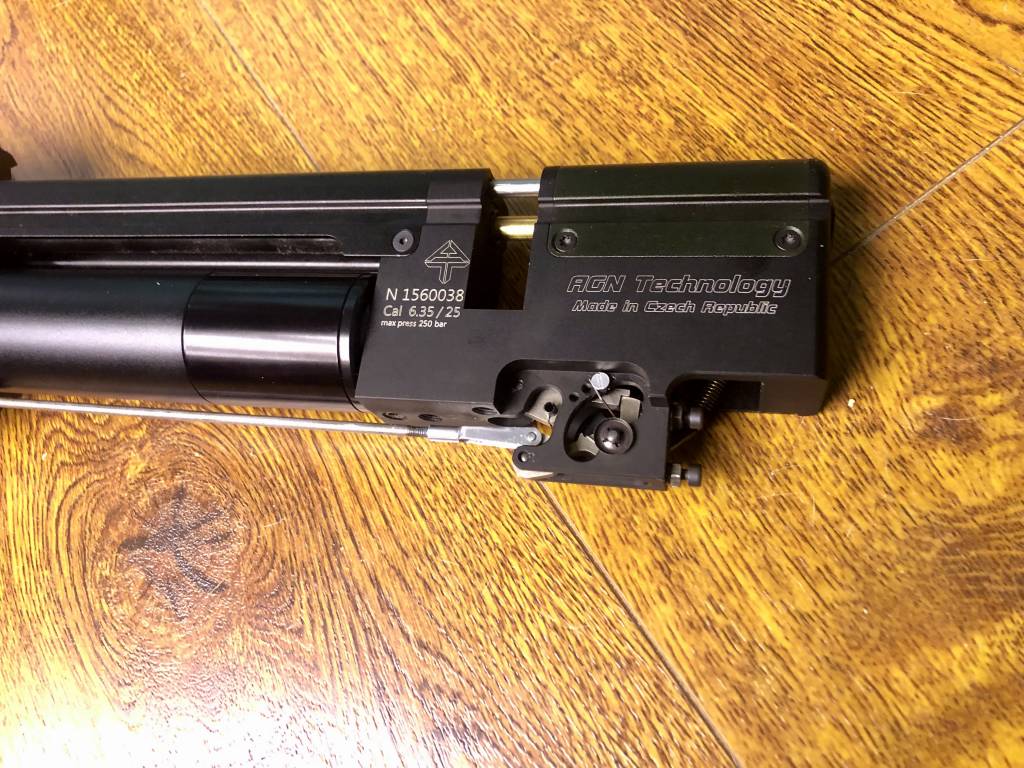

Customer has an original Vulcan 1. Gun is about 8 years old and has never gotten a reseal. He wanted to power tune her a bit and add a biathlon lever instead of the old bolt.
What great little PCPs these are. I installed a power plenum and the biathlon lever. Installed a new gauge, power modded and resealed all. Also got a DonnyFL Tanto with the deal. Set reg at 155bar. 25.39gr Kings are doing 940 fps & 33.95gr King Heavies are doing 860fps.

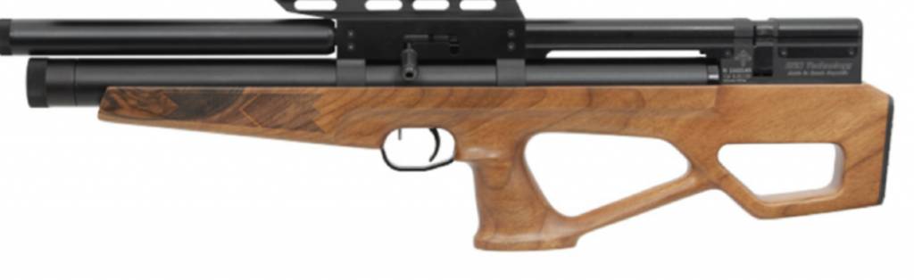

I agree, the AGT Vulcan, no matter what year or iteration, they are very high quality and beautifully engineered. This one is very compact with only a 450mm barrel and 250cc tube.
I’d say this same tune with the 25.39s at 880 fps would yield 36 plus shots which is 4 magazines worth with this Vulcan which has a 9 round mag. The Vulcan 2 has an updated magazine which is a 10-shot capacity.
