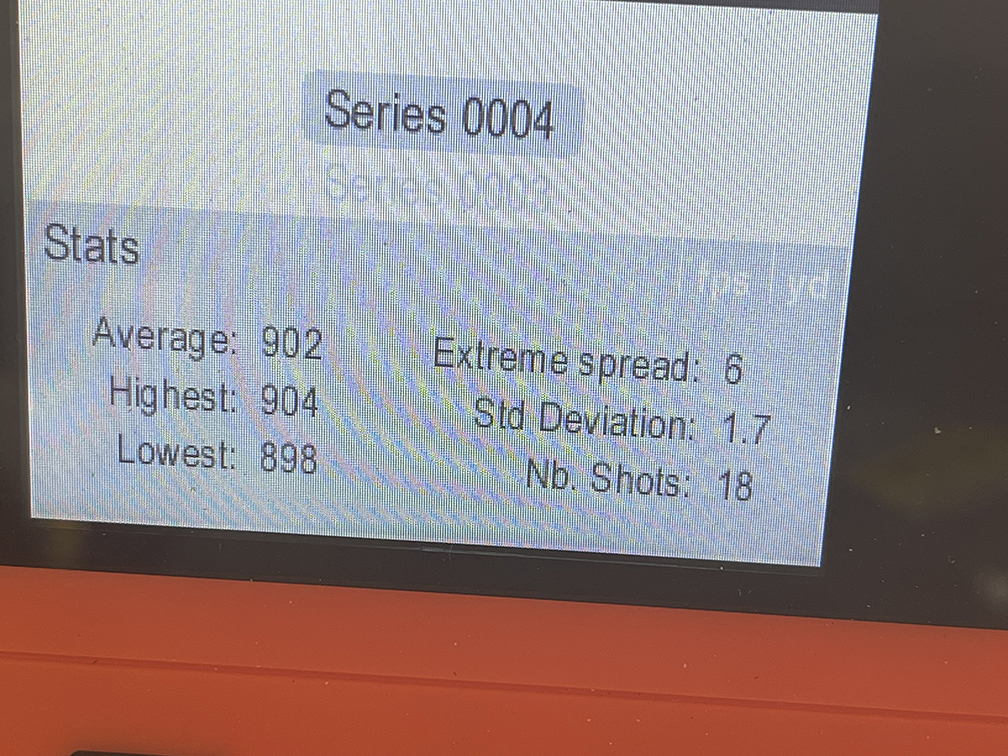

.30 ammo ain't cheap and the tins go FAST when the guns shoots so darn good. Rather impressive accuracy and consistency with .30 cal Hades running 902fps. Reg at 135bar and getting 1 1/2 mags with 250bar fill, 2 mags with 300 bar fill.

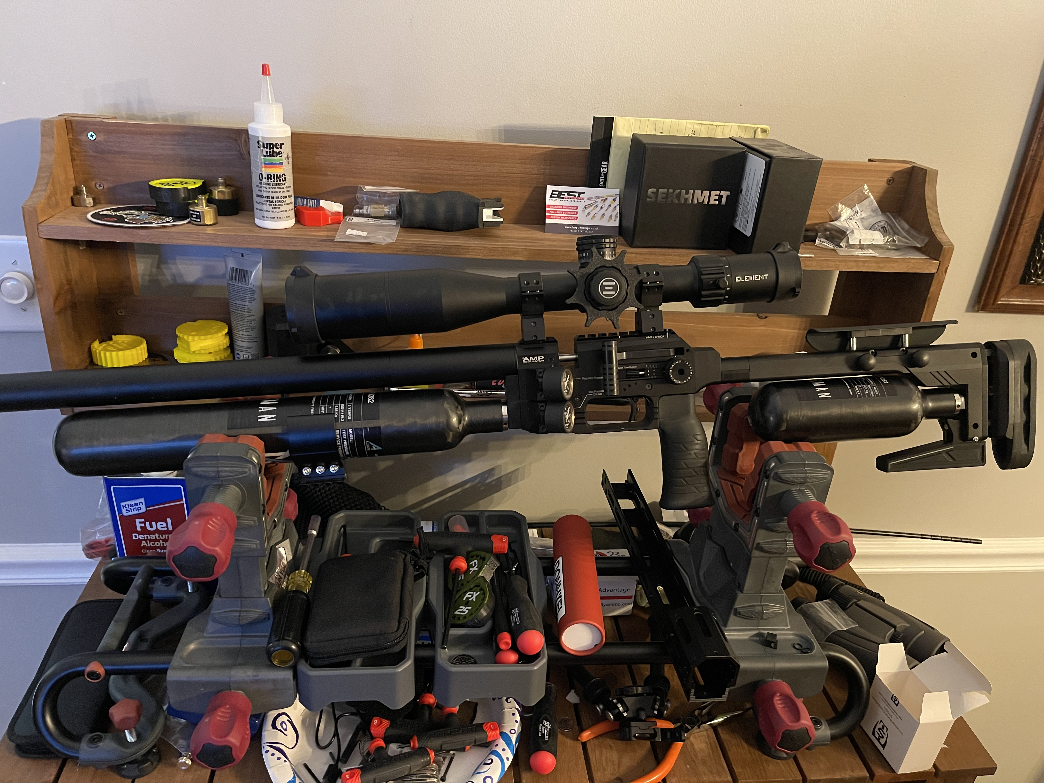

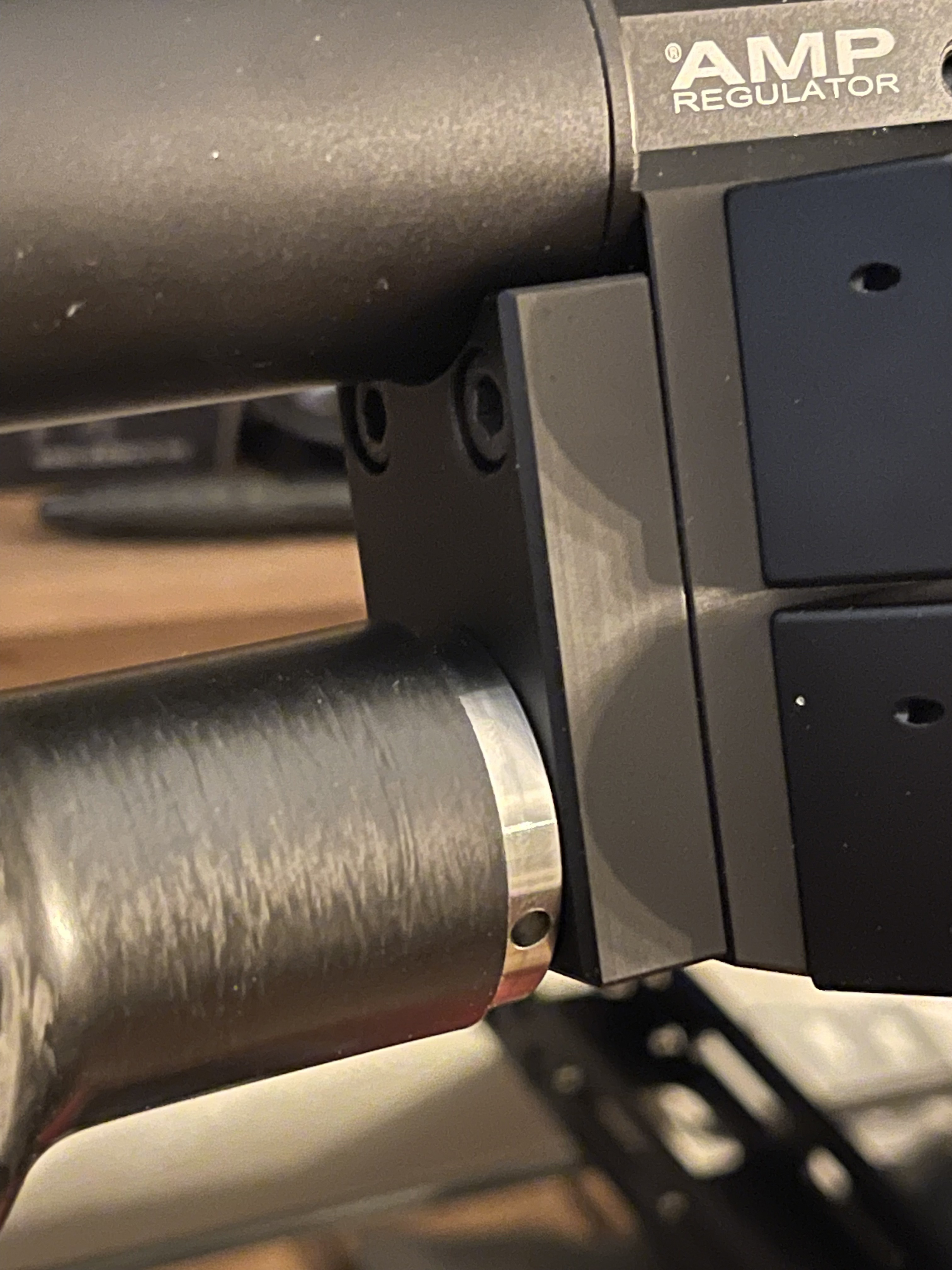

I installed the Huma double bottle adapter and added a 700cc bottle to the front of my 500mm 30 today. Really like the Huma kit. It isn't just a bottle adapter. It adds a block/cover that is really robust. The block also has a substantially deeper recession for the valve pin over the factory block.

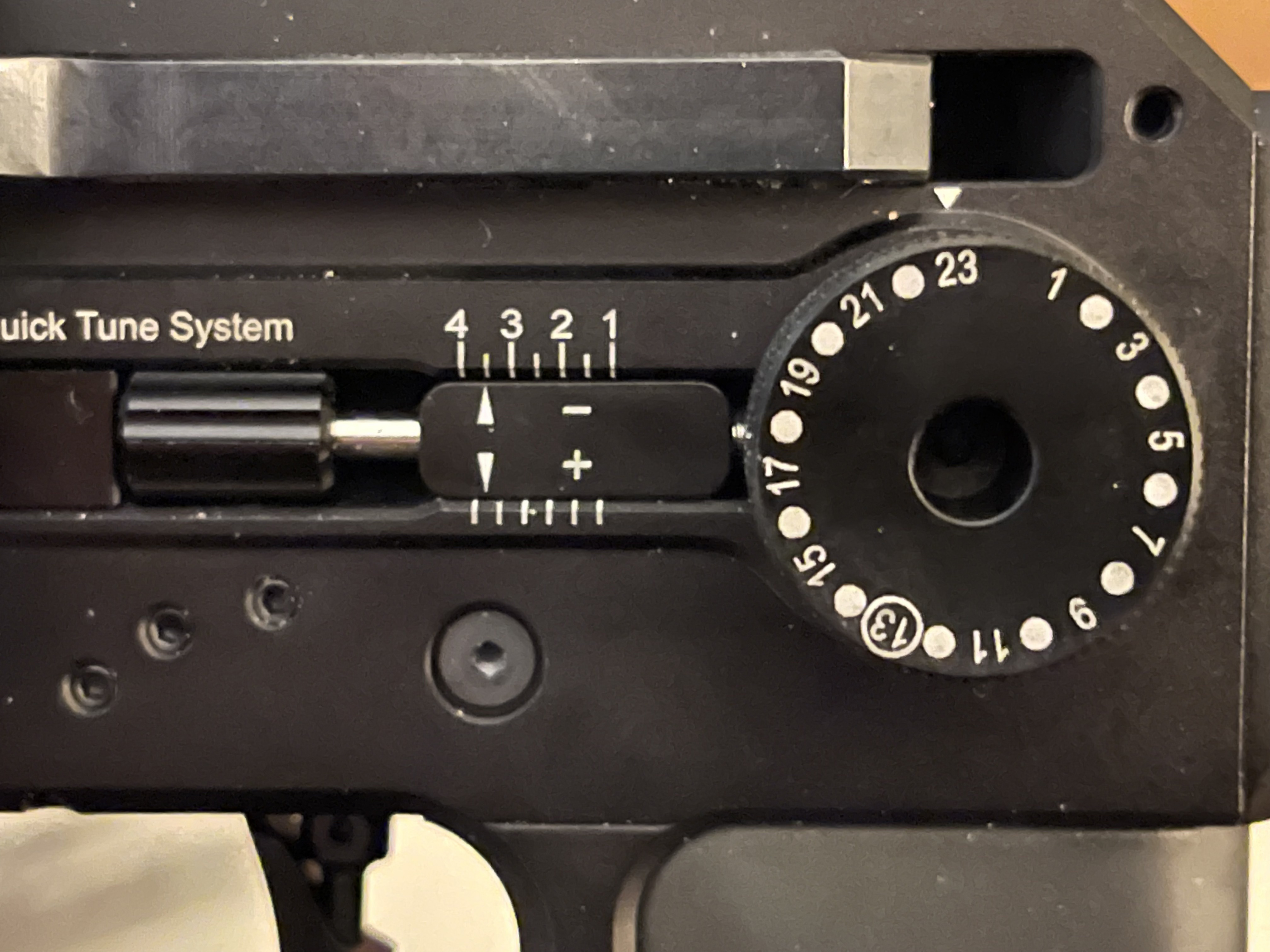

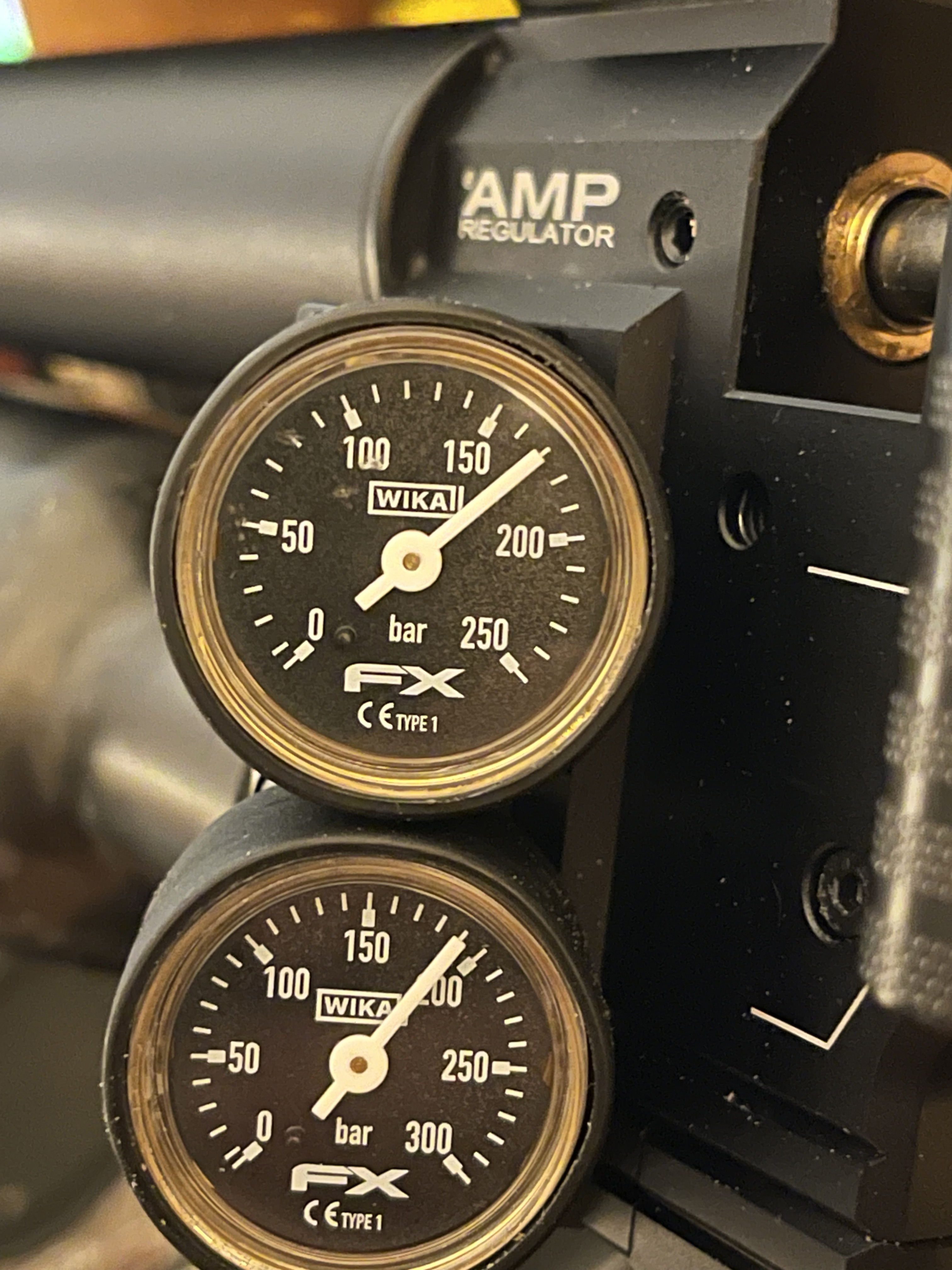

I have been determined to get hybrids to shoot well and after re-installing the 8mm hammer weight, turning up the reg to 170 I have got it shooting them very good now. Lab radar data showed out of 20 shots, my avg speed is 974 fps. Extreme spread was 8.34 and the standard deviation was only 2.27. Grouping very well at 50, but I'll really put it to the test over the weekend. 94lbs of energy at the muzzle, still carrying 75lbs of energy at 50 yards! Should be devastating on a turkey's head this spring.
I'm going to say it. The Panthera is MUCH easier to tune than my Impacts in my experience so far. It just settles in much faster it seems. Super consistent, shot to shot.
It is much noticeably a heavier rifle with the dual bottles but the shot count, as expected, is drastically better. Confident that if I top it all the way to 300 bar, I could get 3 mags = 39 shots. Please excuse my disaster of a workbench below.

What is your regular pressure set at?
