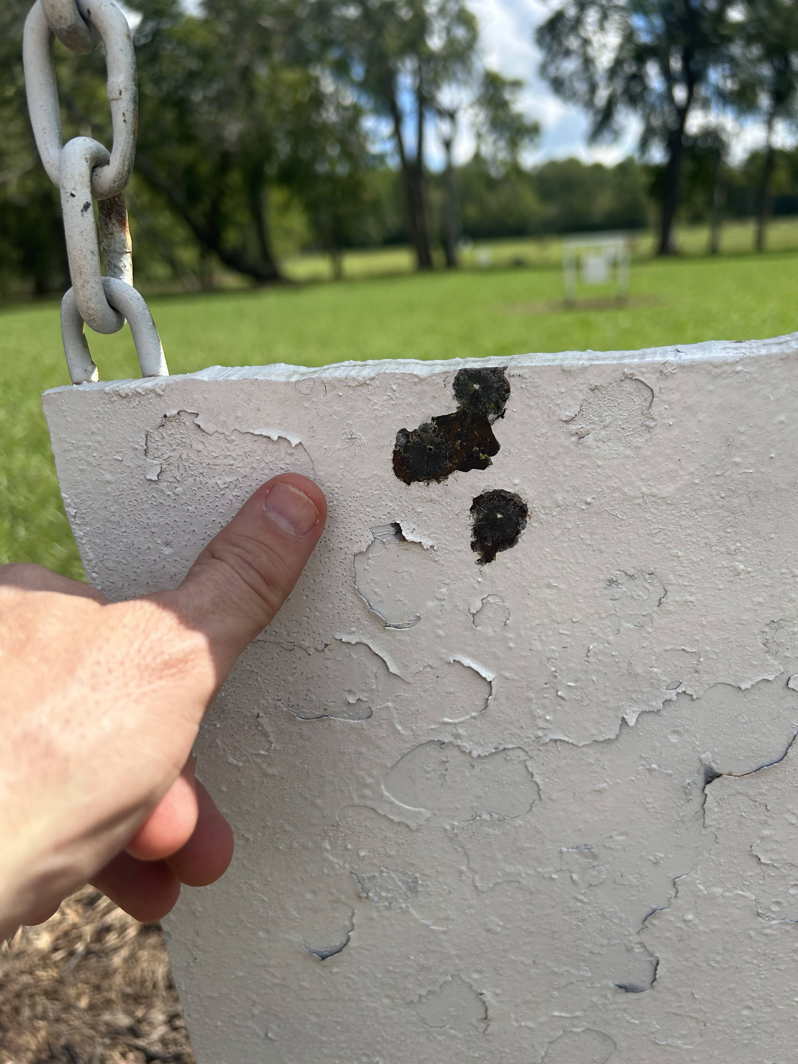

Short and sweet. This gun is pretty dang awesome. The Altaros slugs are pretty dang impressive. 175 yards and does it over and again:
