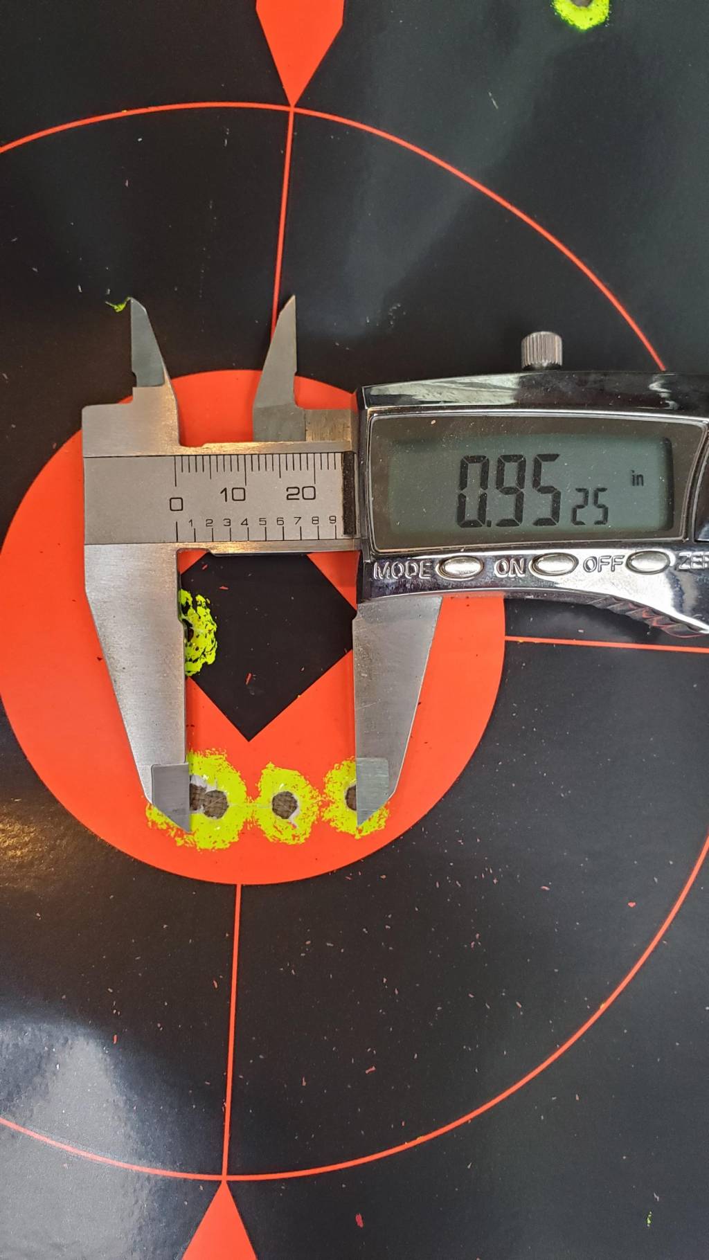

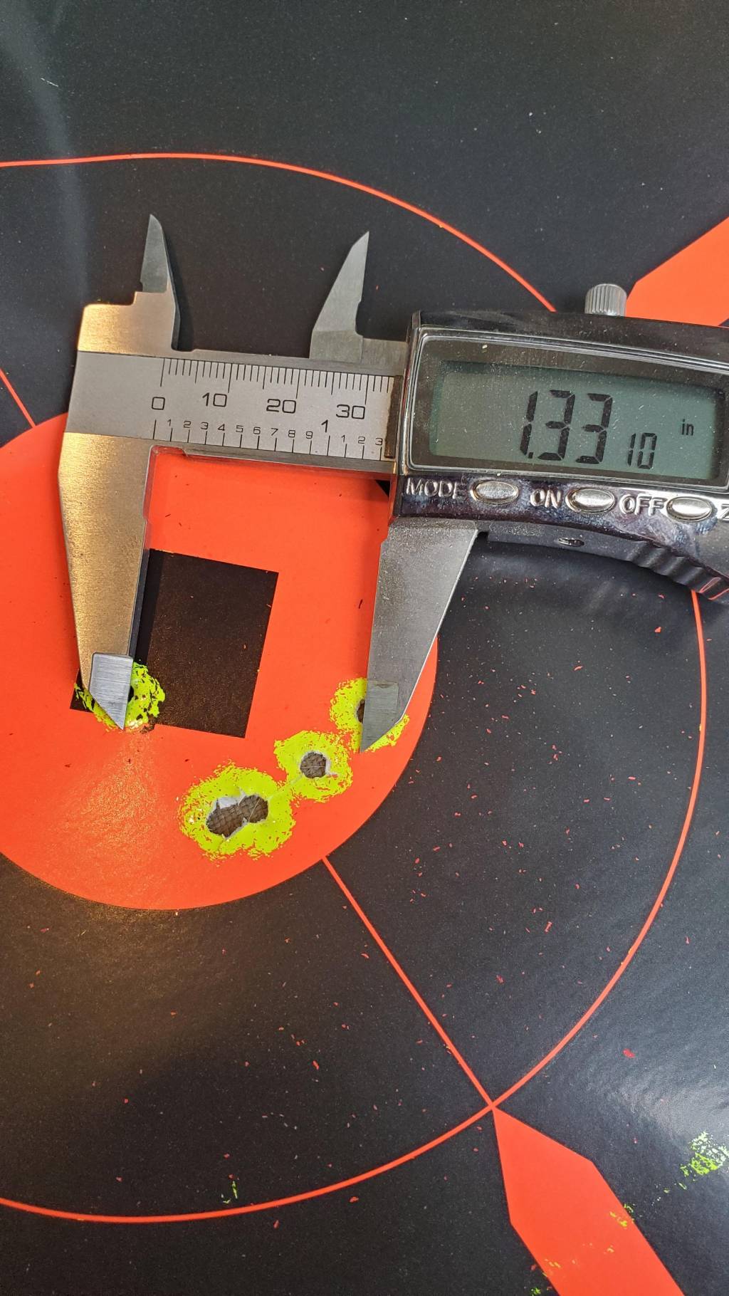

The next day I shot the h&n at 100 yards and was very happy with the results considering the conditions. I don't shoot at this distance much and I don't claim to be a impressive shot so this group was a pleasant surprise. Take away the flyer that was either me or wind shift and that's insane for a shooter like me! With some practice and maybe some tweaking this could be a insane combo!
I'm sure many of you can do better than this but I was super happy with these results and a feeling of accomplishment came over me. I finally found slug lead that my barrel liked and had enough skill and effort to make 4 shots go under an inch at 100 yards. Very satisfied.
What I took away from this: your own research is the only data that matters. You can watch and read about what others are doing for ideas but you HAVE to test everything yourself. Assume nothing. I never really saw any vids that told me .25cal h&n 34 slugs were viable. Had to test for myself.
