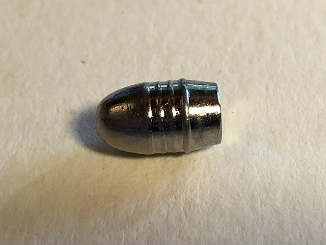

If you're shooting it from a LW barrel with a 1:17.7 twist, the slug performs very well. The longer the barrel, the more stable the slug will be. But the slug likes the choke in the barrel. The LW barrel has a groove diameter of .254, and the largest drive band on the slug is .254.
Don't use a .257 slug in the .25 barrel. It will NOT perform well. Don't ask me how I know. :D

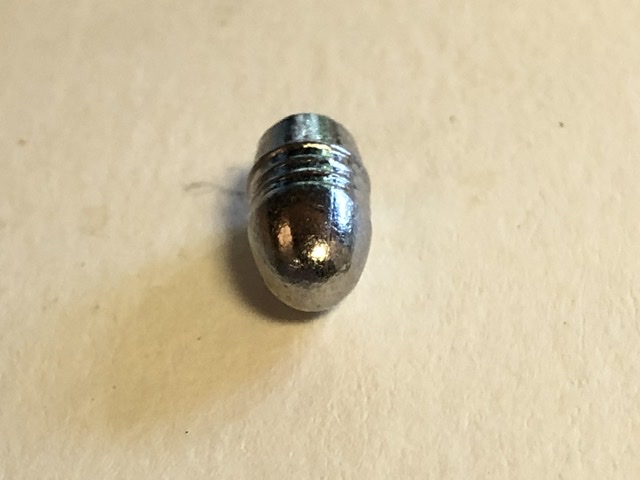

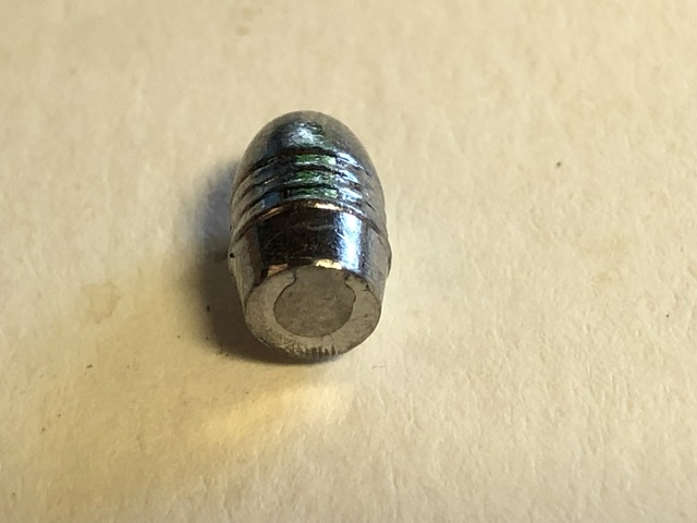

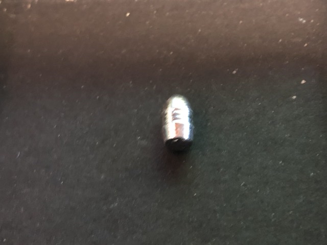

Success!

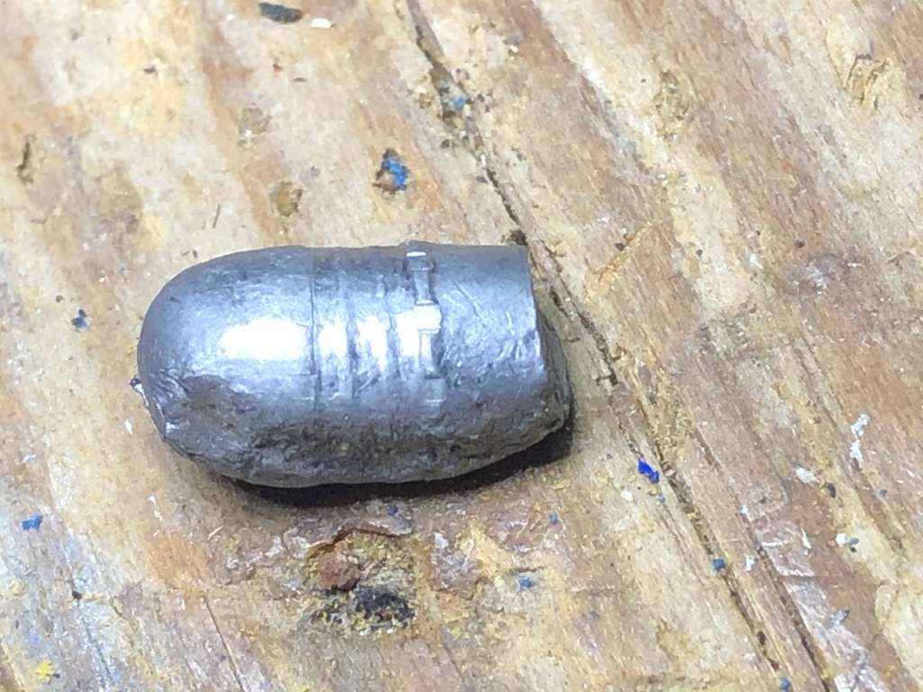

These behave quite differently from anything else I have shot with the TalonP. At 10-15m these bullets are way more penetrative and destructive than the other slugs and pellets I have. I can see why Yo is always cautioning people to be sensible with these types of projectiles.
I have a plasticine clay ball that will stop all other pellets shot at any power out of the TalonP. These plow through it an hit HARD on the other end, hard enough to flatten and partially shatter. I added another 2” of clay. Right through.
likewise a hard cover (old edition) math textbook that stops everything else cold. Never been able to get a slug or pellet all the way through. These go right through and out the other side, even near the spine, again retaining much energy and smashing things on the other side.
I have been trying to capture a fired slug using clay and foam - what works for any other projectile - and have not been able to stop them without something like a steel plate or a log.

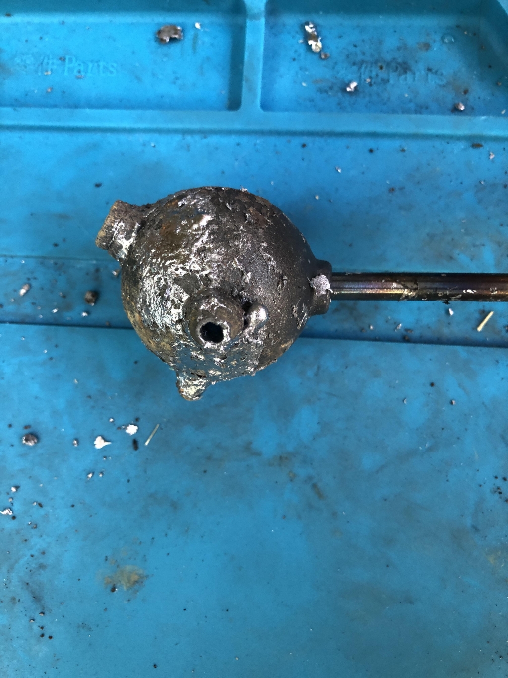

I’ve been using this cast iron dipper to fill the cavities in the mold. It retains heat very well and has a pour hole in the bottom that makes it very easy to use and allows you to apply a good amount of “head pressure” when filling the mold.
basically I fill the dipper with lead and tip it back so the pour hole is horizontal. Designed to work this way... then I place the sprue hole against the dipper spout-hole and tip the whole thing together 90 degrees so the lead drops straight down into the sprue hole right beneath. At this point the entire volume of lead in the dipper is exerting pressure, as the spout kind of seals up against the indentation of the sprue. Then you just tip it back to horizontal and move on to the next cavity, tip, hold, and return. I can really crank out the pellets this way and have very little waste - the nozzle in the dipper fits the sprue holes perfectly and just a little cone of lead filing the sprue remains.

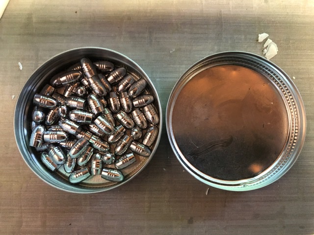

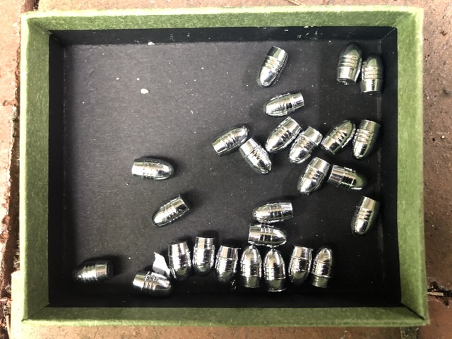

Did a little shopping around for molds. This MP mold is a freaking great deal given that it has eight cavities and didn’t cost as much as some of the two cavity molds being sold by other manufacturers. And I can’t imagine it being any better. As long as I heat it up properly I’m able to get eight full perfect fills in all eight cavities every time. Using a ladle with a pourspout in the bottom I’m able to produce a full tin of these in just 15 minutes or so, after the lead has heated up.
At 47 grains these pellets are a little heavy, I’d prefer something in the 30’s but they’re actually pretty much perfect for shooting in my indoor gallery. They shoot a little high compared to my JSB diablo pellets so that’s better than the alternative I suppose. Being heavy, I have to use higher PW settings to achieve decent velocities so I have to do more hand pumping, get fewer shots per fill... a small but noticeable price to pay.
Accuracy seems comparable to other pellets at the close range I shoot.
So now I can save my expensive store-bought pellets for some occasion when I need something with better accuracy or perhaps a flatter trajectory, or just get tired of pumping every 20 shots.

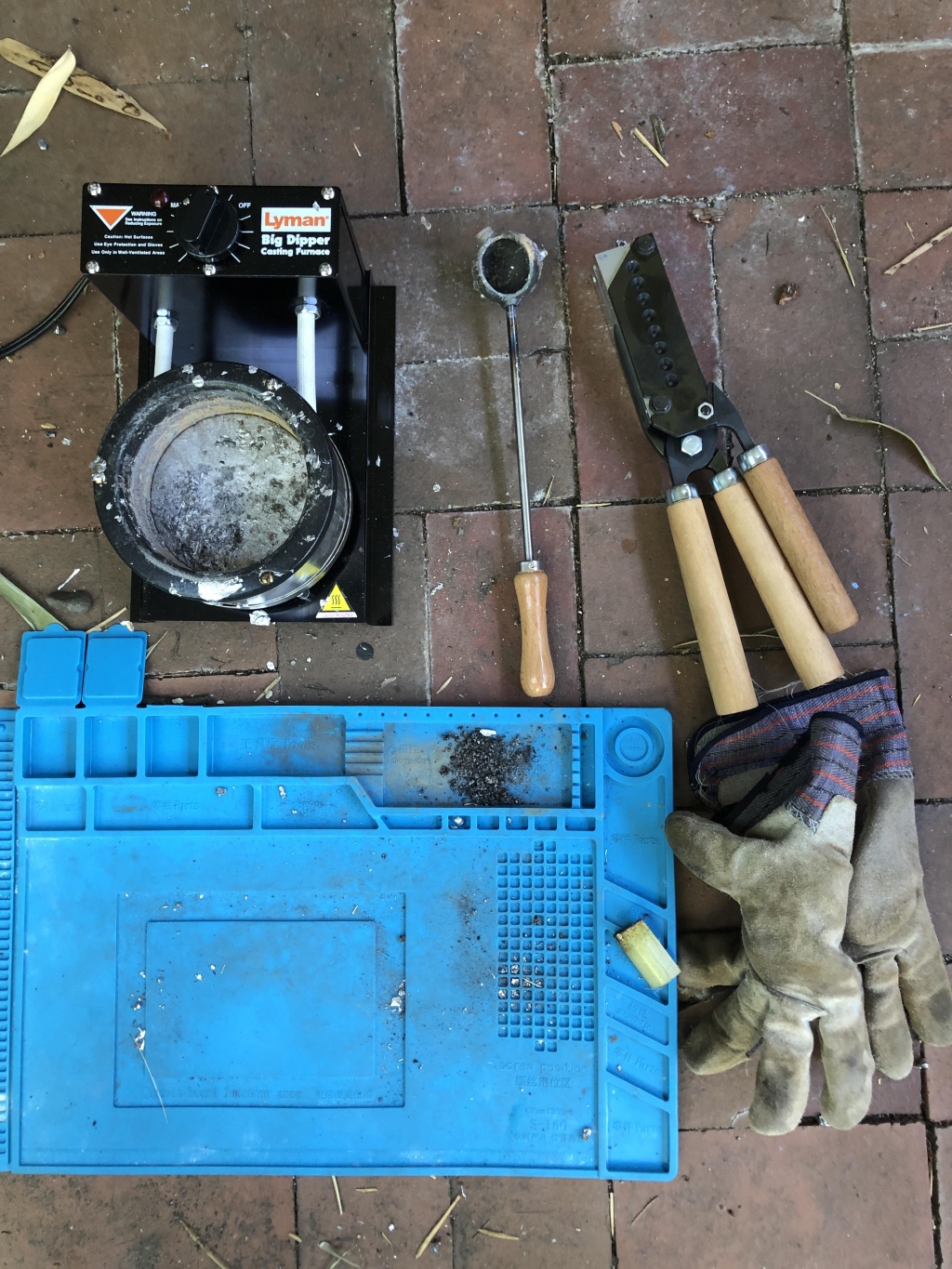

I’m amazed at this thing is actually practical and kind of economical actually. It will have paid for itself after another couple of months. I’m doing this all outdoors I don’t feel like I’m really being exposed to any risk. I’m able to stay up wind... still, all the interaction with lead is aggravating just because of all the vigilance required.
I did not realize that the Lyman pot doesn't have a spout. For a similar price Lee has a pot that pours, so you can fill directly from the pot (and it's taking lead off the 'bottom' so you don't need to worry about the junk floating on top.
If you get an annual checkup, ask them to test your lead levels (a good idea for any shooter, but especially a caster) - it adds $0 to my checkups - that'll let you know if there's a problem or not - otherwise you're just guessing. Keeping it all outside goes a long way in the right direction. There's also a product called "Led-D-Solve" that converts lead dust to some relatively harmless compound.
