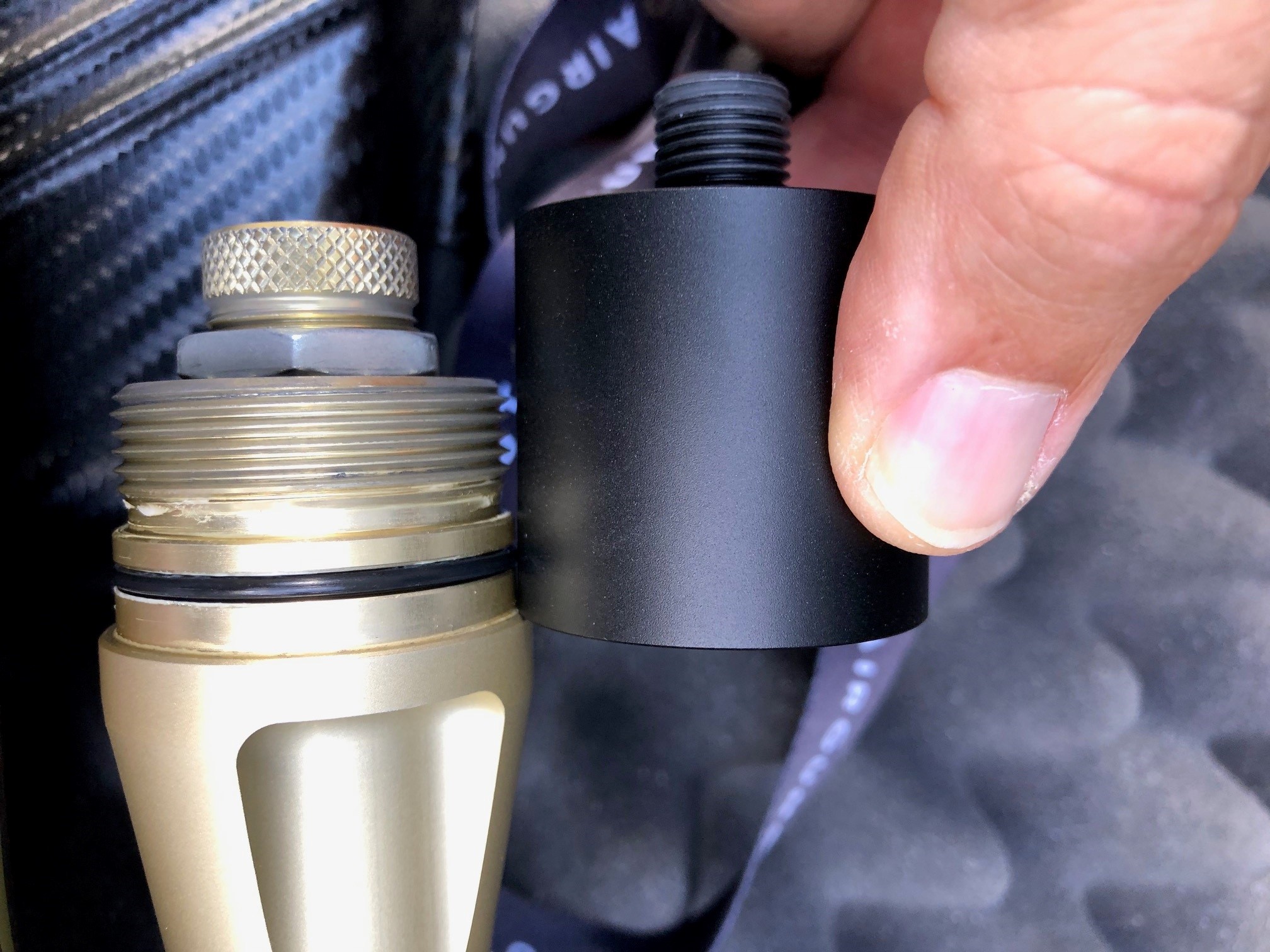

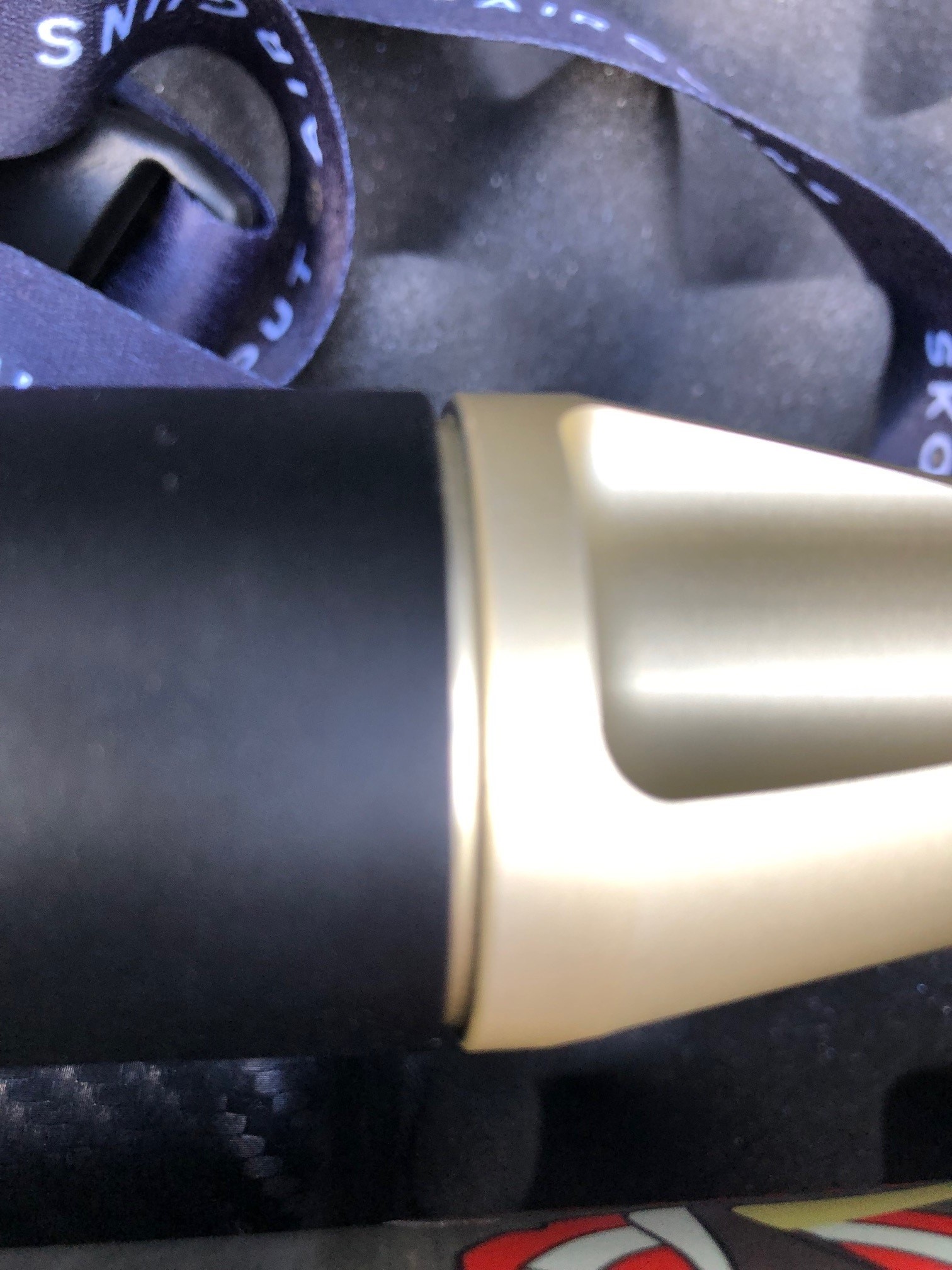

A word of caution if you order a DonnyFL adaptor to use the 1/2-20 adaptor on Skout for your own moderator. Not all Adaptors will fit. They could have been made so that they would fit all Skout by making the cavity 1/4 inch deeper at the most, but they didn't. So, with SOME Skout Epoch the barrel nut sticks out a tad too far for the adaptor to seat on the lip of the "cone" section. See photos below.
I informed DonnyFL and was told to get a different brass barrel nut that is shorter. The reply didn't sound like the DonnyFL service that I have been used to over the years... :( The response said something about version 1 OK and version 2 not OK, and then Skout going back to version 1 brass barrel retainer nut. Or, they could have just made the cavity a bit deeper and satisfied all versions...

Look closely at my photo. You can see two threads showing after installing the liner and snugging up the lock nut. If there is less than two threads showing, you'll be able to use the adaptor no problem. You can always use the adaptor by using the extension for the factory moderator, but it will make the assembly about 2 inches longer.
So, from the cone, it should be cone-adaptor-moderator. If the brass barrel nut is slightly too long to allow the adaptor to seat on the lip of the cone assembly, you can use the extension from the factory mod so that its cone-extension-adaptor-mod.
I prefer to keep the assembly as short as possible but no matter how your gun is you can make the adaptor work. Also, if you order a 35-inch barrel vice the 25-inch barrel the factory mod will be quiet enough...
