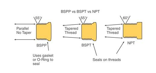

Hi mike, it may feel like they are parallel threads, but I can assure you they are not. BSPP and NPT theads are close enough in pitch to easily be mistaken for each other. I just checked here and a BSPP gauge will thread in, but for the first few threads it is a looser fit, and then gets tighter near the end. For the record Skout does not recommend trying to use anything BSPP on the Epoch. All gauge ports as well as fill nipple and bleeder valve ports are 1/8-27 NPT threaded.
Understood. I am a Nuclear Engineer by trade, so have an ok understanding of this type of thing.
The factory gauges thread in all the way to the bottom easily. The 1/8 BSP gauges thread in exactly the same.
Try it when you get my gun next week, you’ll be surprised I’m sure.
There is no difference threading either the factory gauges or the 1/8 BSP gauges I have into the female portion.
Trust me, I was stumped. With NPT you can almost always see the taper, and when threaded in the turning gets tighter after a couple turns so that the threads seal with the Teflon tape.
Both factory and 1/8 BSP gauges easily bottom out in the female threaded portion of the gauge port. I’ve never seen a properly threaded NPT connection not get harder to turn after a few turns.
Doesn’t matter much in the big picture of things, I’ve just never seen “tapered” threads like this in my 45 years in Engineering….
Maybe you can help me understand why tapered threads were used in this application when the industry standard is 1/8 BSP for gauges.

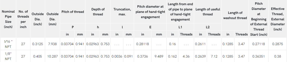

I've never seen a taper thread that wasn't measurable with calipers, opposed to simply comparing them by threading them by hand? Not saying you're wrong but you should verify with calipers.
My 1/8" NPT gauge in front of me starts @ .38" and tapers to .4" which adheres to the standard, seen below @ Outside Dia. and Effective Thread External Diameter.

Your previous reply implied it was some sort of deal so I was just trying to help get to the bottom of it and have a definitive answer.
.02" is not a lot of taper and threading in a bspp gauge into a bspt or npt gauge certainly can muck em up (ask me how I know :cautious:), but as you said getting a proper seal there with either an x-ring or thick o-ring certainly shouldn't be an issue, and you may have to moving forward if the internal threads were compromised, unless that is serviced/repaired.

Mike, I am interested in inspecting the threads next week. To ensure there is no misunderstanding for everyone, as the person who designs, machines, and tests the Epoch components the threads are 1/8-27 NPT threads. These threads were chosen as they are the industry standard for paintball, where we have over 30 years of experience. This is similar to us also choosing PSI as our pressure unit because it is what we also use in paintball. We check the threads on the bodies using a plug go/no go gage to ensure they are correct as well. I hope this info clears some things up from one engineer to another. ;)

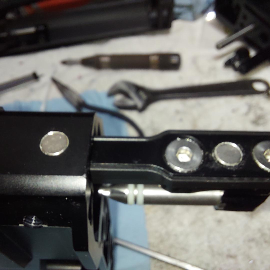

Good idea. My biggest suggestion would be something like a magnet or detention to hold the cocking lever open when you cock the gun but leave the lever back. That would make the gun much more pleasurable to shoot when moving around and shooting.
Luke, after returning to San Diego and looking more closely, I will admit I was wrong. I assumed because the BSP gauges fit so well with an X ring it wasn’t tapered, but it is. My apologies. Yes, the three gauges and ports on the Skout Epoch are tapered NPT threads that seal with tape on the threads.
That idea and "HOW TOO" was shared with them MANY months ago. I played with the idea and came up with a super slick miens using Rare Earth magnets that SKOUT is all ready using threw out the EPOCH platform.
1 magnet on the tail end of shuttle linkage between probe holder screws, 2nd magnet within the top frame. This HOLDS the cocking lever open even when muzzle is pointed down. Yet when cocking you really don't even notice the slight bump of magnets attraction at end of lever travel.
