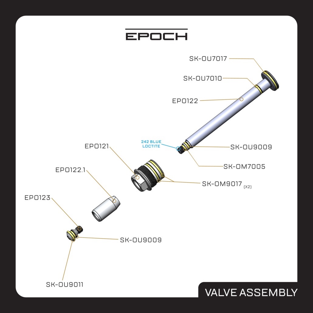

Skout Epoch drawings are great, and easily accessible. But there is/was no list of parts/orings. Talking with Augie @Bigragu , he "cracked the code" for the orings. If you look at the drawings that have part numbers on the drawings, the ones that point to an oring have a number. Examples from below would be SK-OM9017 or SK-OU7010. What these mean are SK (Skout) O (oring) U or M (material - we haven't cracked what the U and M mean yet, probably Urethane for U, not sure for M), 9 or 7 (duro or hardness - 90 or 70) and the last three are the standard (non-metric) AS568 size. All but the 001, 002, and 003 are 1/16" thickness (CS).
I'm cool with buying the little plastic box from Skout to have additional orings, but the box with $5 worth of orings is $50 from Skout. You can buy a lifetime supply for $50 from The Oring Store or Orings and More.
Reactions: Revoman

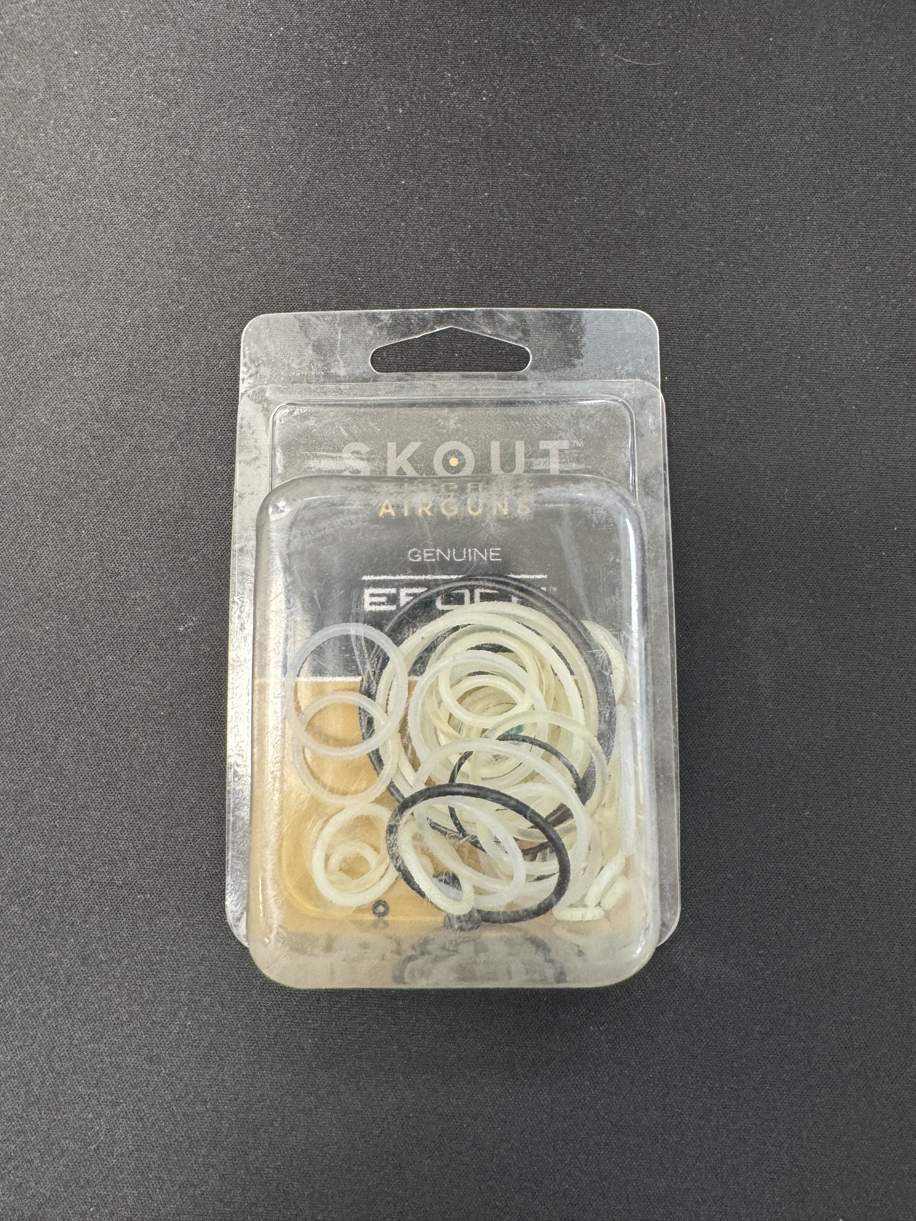

Hi Mike, I believe you are confusing our spare parts kit with our oring kit. Our spare parts kit is $50 which is what is provided with every gun from the factory and includes more than just orings. Our seal kit includes all orings and is is only $24.99.
Yes, my bad. I was just relaying what I heard second hand, sorry for the mistake. $24.99 is reasonable for that selection of orings. Can you say what the U and M stand for as far as material?

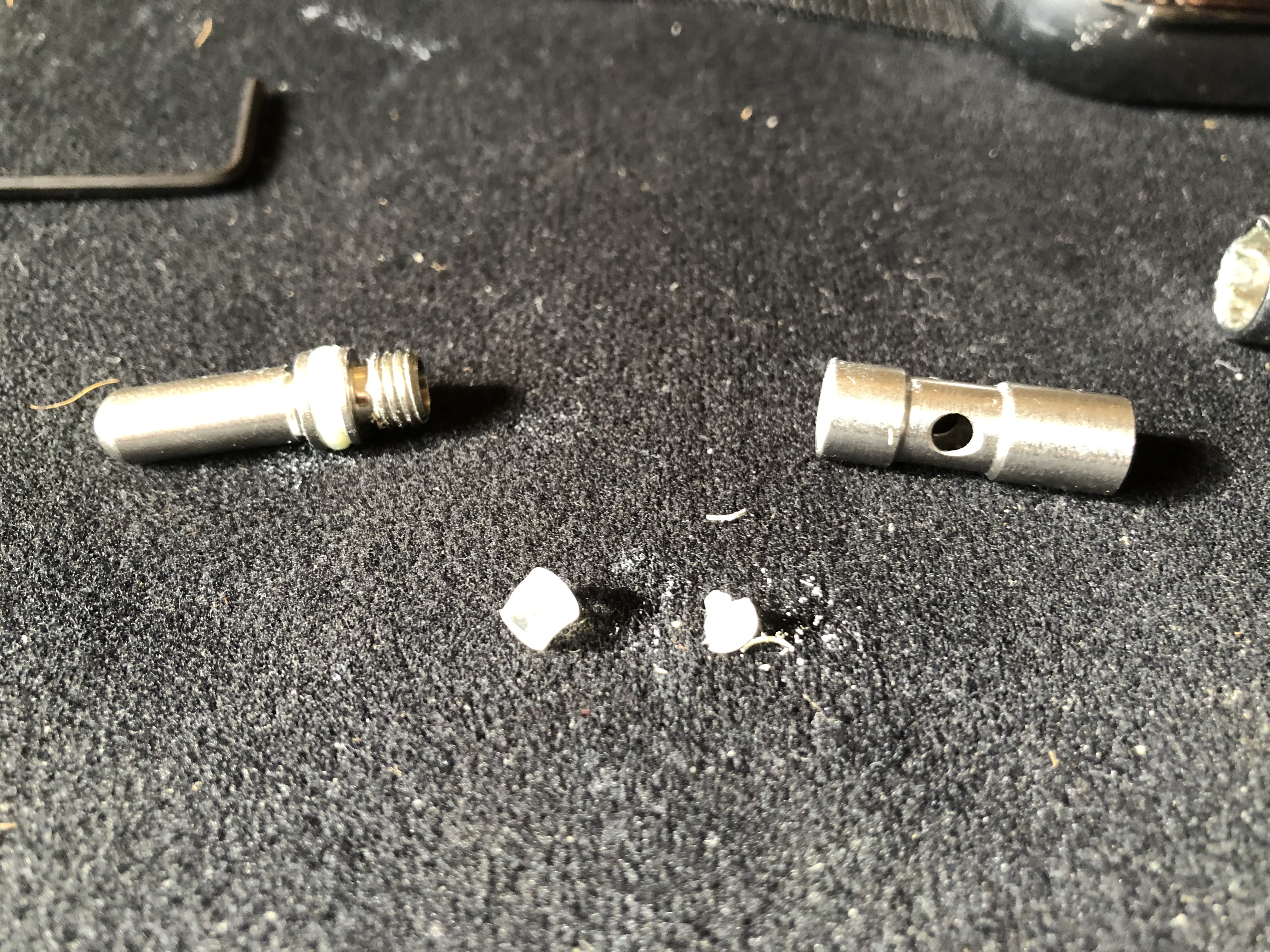

Got around to fixing the LP reg issue with my .25 “Gold” Skout Epoch. I’ve renamed it “Leaky”.
I disassembled the LP reg following the excellent Skout video on UTube. The problem was a broken valve seat. See pic below. The two small white pieces are supposed to be one.
Luckily, there was a replacement in the O-ring and parts kit that comes with all Skouts.

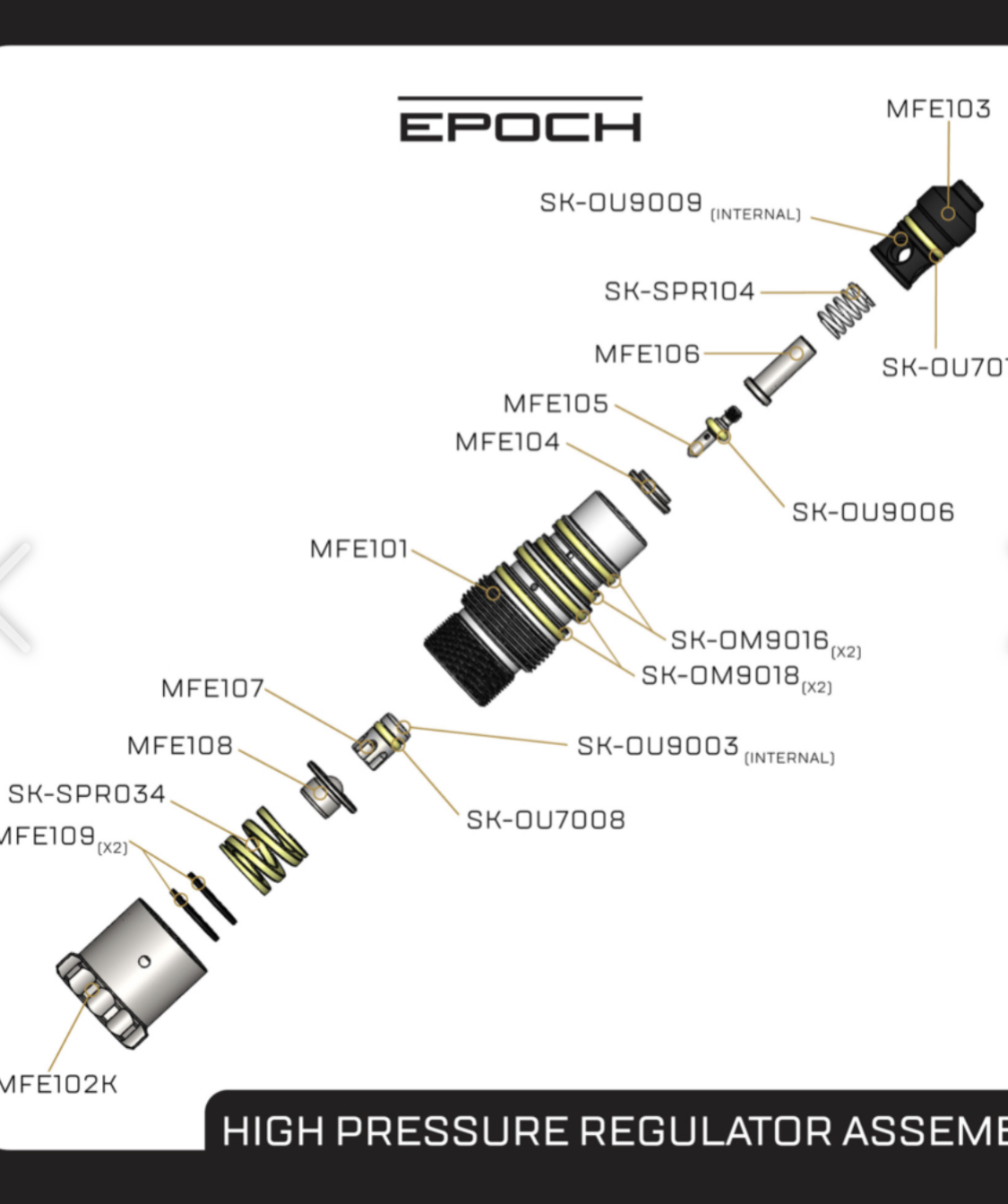

So I depressurized the gun, removed the HP reg and rebuilt that one also. Really just cleaned everything out, and re-greased all parts as I put it back together. Nothing was replaced. I did notice that the two spacers under the adjustment cap were actually on the opposite side of the spring. The video shows them between the adjuster cap and spring, and that’s where I put them. Mine had them between the spring and spring guide.
Also, the video only shows 3 orings on the outside of the upper reg body, mine has 4. And, the oring above the poppet seat in the video didn’t exist. My gun has a metal spacer in that area.

Skout weirdness. I rebuilt the HP reg after I fixed the LP reg (see above)
The two spacers MFE 109 were in there from the factory between spring and part MFE 108. (This is how I received the gun). This drawing shows them where I put them between the spring and MFE 102K.
The reg is all of a sudden, perfect.. part MFE 104 is like a metal spacer but stepped. The UTube video shows a white oring. I think maybe I put that in opposite of the way it shows and this also affected performance? Just guessing here. Whatever I did it’s firing on all cylinders. I’ll take it apart and see but it’s working so well I don’t want to mess with it.

IIRC ... Mine came having the 109 washers with 1 either side of the spring & seems to work as it should ?
Odd that the O-ring that goes between 104 and 103 is not even shown .. thats not good !!!
