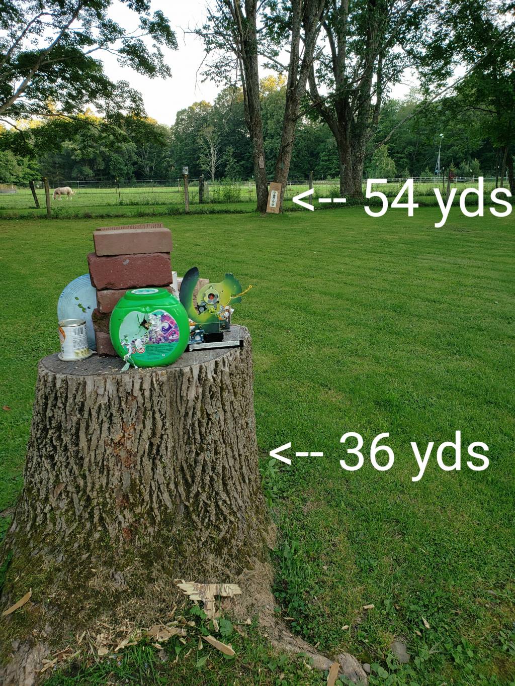

Some of you are by now wondering why he went from .218 to .216. ( lol -- yeah ) I have plenty of H&N .217's that my Taipan Long LOVES in 23g but . . . I'm thinking this RTI has more native "grunt" than the Vet and I'm hoping to shoot something a little heavier with it. I still have some .216 JSB KO's in a tin - maybe 30 or 40 of them - I'm going to give those a go tomorrow. Pics below are from those .216 27.5 NSA's @863. First one just shows both of my distances - I "zeroed" it at the 36 yard tree stump and then move the board back to the other tree at 54 yards. Again - for down and dirty, quick testing after get home from work trying to stay ahead of sunset . . . I'm actually kind of pleasantly surprised. I'm hoping to take it out to a local range this weekend where I can test it @100 + yards.
