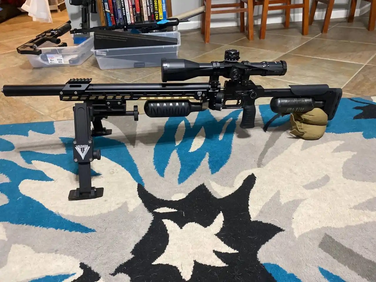

For upgrades, I just wanted to add some nice pieces to it. Saber rail, Keller Digital gauges, Saber front bottle drop down kit, 300cc front bottle and a few others. Should have plenty of air to get through a match for sure now. I'm for sure invested in this gun now !!!
Very nice! You should get about 100 shots per fill with the .25 Heavy at 900 fps. Looks great! Congrats!
PS., I use an STO (Silent Thunder Ordnance) Pugio on mine and it works great and has no adverse effect on accuracy.
Oh yeah. Totally forgot about the moderator. I bought an Impulse Air 1350, but haven't shot with it yet.

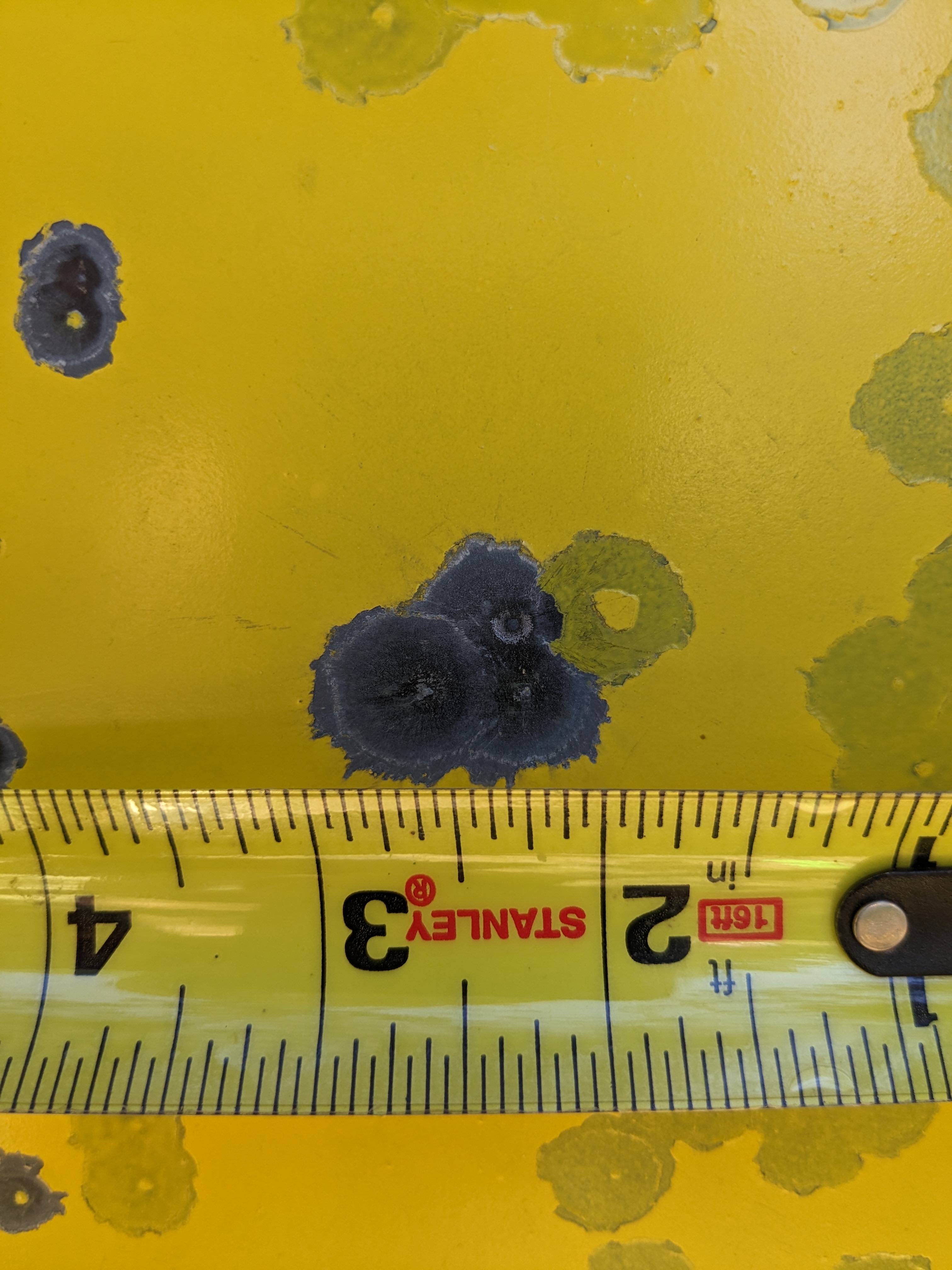

Here is 3 @ 100 w/ a Ghost .30 took pic before 4 & 5 as I new I was toast because I was struggling with trigger at that point. I tried slugs but didn't spnd any seriouse time there as I could see righting on wall. Tried maybe 10- 12 differant slugs. I think in .25 Ghost it will come down to wind & you just as it does with .30. I suspect in a few years once slugs & barrel choices get thicker I feel slugs will dominate 100. 100 is pushing it for a pellet IMO
