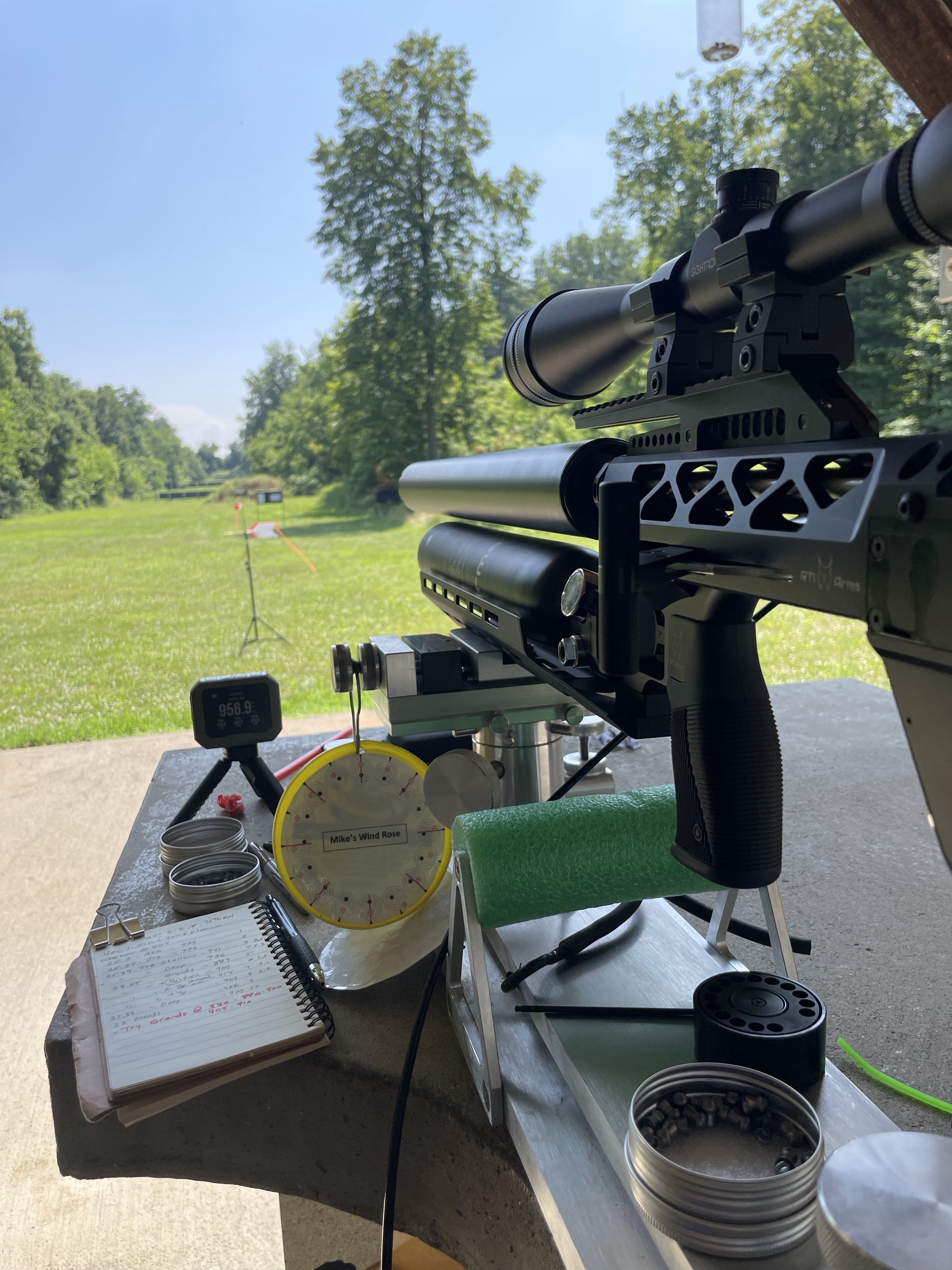

Today was my Mora .25 Sniper’s first range trip. It came set up with 140 bar on the 2nd reg and it shot pretty decent with AEA 29.5 pellets with one ragged hole at 50Y so then I stretched it out to 100Y.
Calm conditions with wind at 2-5.
Does anyone know if the shroud end cap is LocTited? Mine won’t budge. I bent several punches, trying to unscrew it. Might have to try some heat tomorrow.
