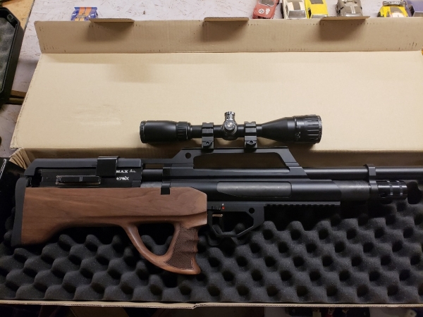

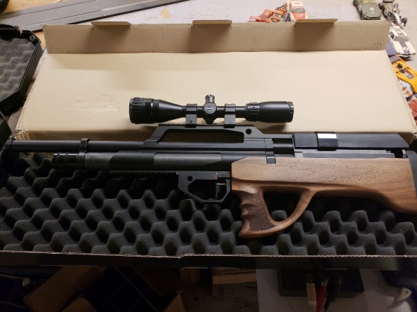

Received a .25 walnut stocked, carbon fiber tubed Max Air today and want to give my quick, down and dirty first impressions.
LIKES:
Looks very cool and has a nice walnut stock. Stock appears to have no finish on it.
Fit and finish (mostly) is very good.
Smaller than expected.
Has some heft to it but it feels to be centered directly over the grip making it comfortable to hold off hand.
Nice magazines and so far no issues with feeding. Will buy the newly designed ones when released anyways.
Accuracy. Only shot it at 12 yards indoors but accuracy seems spot on so far.
FUN FUN FUN to just keep pulling the trigger!!

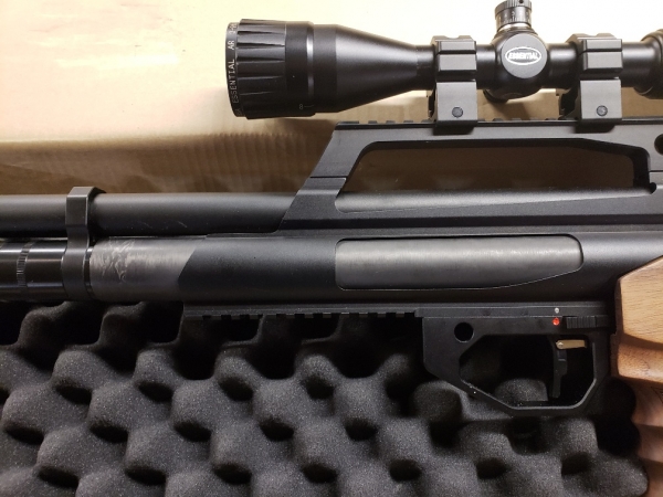

Trigger IMHO is not very good. Very long first stage and a mushy second stage wall before a heavy break. Also a long reach to it. I have average to small size hands and I can just barely get the pad of my finger on it. It can be shot accurately but takes more effort than it should.
Puff of air in the face…sliding cover helps but does not eliminate it.

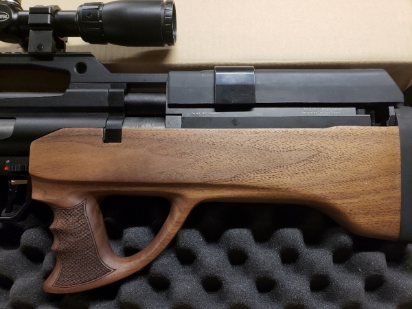

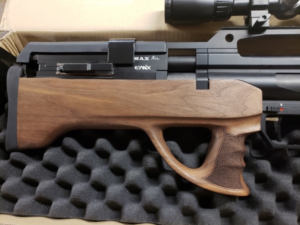

Stock only attaches with 1 screw and rocks a bit. I made sure the one screw was tight but did not go Gonzo on it in fear of cracking the wood stock. I think this will be an easy fix but at this price point stock fitment should not be an issue.
Gap at top of butt stock…looks like something is missing.
Finger grooves do not fit my hand well….would have preferred not having them.

Is the carbon tube option worth it? Not sure a half a pound of extra weight would make a big difference with how well this rifle is balanced. I was also surprised to find a magnet stuck to the carbon tube.

Random: A way of testing carbon fiber 'purity' is to use a multimeter..
On continuity mode, if probed, the carbon content will ground out, and the meter will beep..
Electricity can flow through it - But, I've never known it to be magnetic..
We used to do this to test Chinese 3k 'carbon fiber' vs. some of the mixed cf / fiberglass they put out..
Anyways, I've worked around a LOT of cf - and had it in contact with Neodymium magnets.. Still no attraction..
If a magnet stuck to a cf component on the gun, I would guess that they would be something metal under it..
Like a metal 'metal/steel tube - wrapped with carbon fiber'. That would make the most sense..
Otherwise, I'm stumped! 😜

That trigger guard is quite hideous, very blocky, and lacks little ingenuity compared to the 'semi automatic' capability of the rifle...coupled with what you say is a very poor trigger mechanism or operation, both seem to leave much to be desired.
Stock looks decent, that gap you mention is uhm...undesirable

Most bullpup configurations suffer from "less than desirable" triggers. This is because they typically use a rod (or equivalent) to go from the trigger your finger touches, and the actual sear release. This is due to the fact the trigger is further forward on the action than the sear release mechanism on most bullpups (as compared to a classical rifle where the trigger is directly over the sear release mechanism).
Like you, this air rifle has caught my interest. However, every video I have seen at 35 (or more) yards have shown nice basic groups with some flyers mixed in. I am a bit curious what the mechanism is for the flyers. I have the crazy expectation that a 1200-1300 dollar air rifle will shoot (at least) as accurate as my less expensive Marauder. There is a chance that this will not be the case with the Evanix Max Air. Like you, I am staying tuned.
Post Script: the likely reason why a magnet sticks to the air tube, is because the air tube has a steel core, which is wrapped in carbon fiber. With the carbon fiber wrap, this allows them to have a thinner steel core, and save weight.

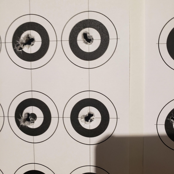

Here is a quick pic of some 3 shot groups at 12 yards, have not even cleaned the barrel yet! Air Arms 25.4g. Bullseye is .25 inches.
